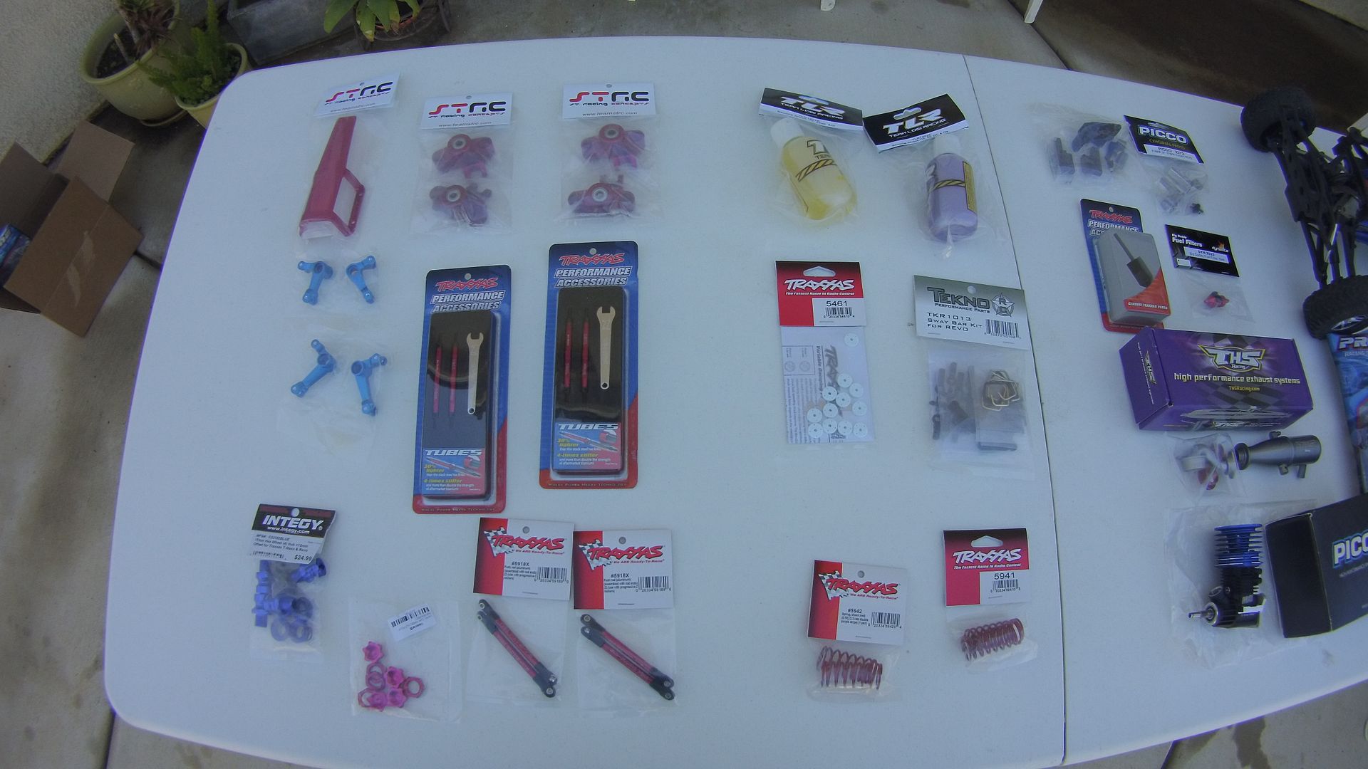

Here's a teaser/intro of my Slayer project. I got 90% of the parts that I need to complete the build so I'm gonna get started modding my rig. I'm gonna break it down into a 3 video series so stay tuned for my epic build!

Sorry for the inactivity on my Slayer project for the last 2-3 weeks. Thank you all for your patience, had some personal things to attend to--now the project continues. Here is the Picco mounted with pullstart! Truck feels much lighter without the EZstart assembly (sorry no scale to confirm how much exactly however I shall be getting one soon). Pretty straightforward install. I did have to grind the bottom portion of the cooling head on the chassis side to make room for the rear Tekno sways.The Traxxas 3.3 clutch, one way bearing, and 3.3 pull-start all fit like a glove on the Picco P-Max .21. The mill also comes with an included mount to make the install that much more easier.I haven't installed the THS pipe yet, as I will be breaking in the Picco with the stock pipe and be monitoring how she performs with the stocker first. Standby for some running vids as soon as I have her all breaked-in, tuned, and ready to go!

Here's a lil' update...I installed new servos--Savox 1256TG for steering and 1258TG for throttle/brake, Revo HD servo saver spring,
