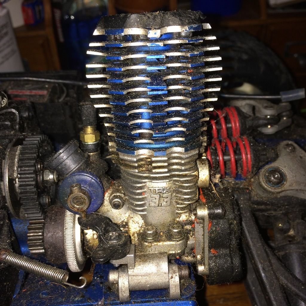

Picked up a used traxxas revo 3.3. It came missing the exhaust system and air filter. Motor looks like it's been sitting a long time. I'm wondering if I should just put on the missing parts and run it, or should I disassemble the motor and give it a good cleaning?

I would take it apart and clean it first, With the air filter being gone you don't know what is inside it... Better safe than sorry...

I agree with Dyehard. I would at the minimum pull the head and backplate, flush it out with motor spray and if all looks good, lube it with some Marvel Mystery Oil.
Not knowing how it had been used or how much, I would look closely at the lower conrod bearing, and see if it needs a new rod. Also, you can check the pinch, and cylinder walls.

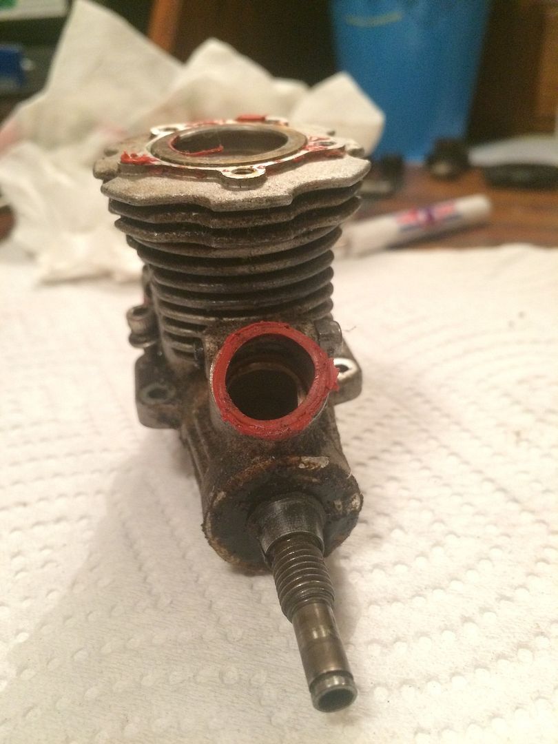

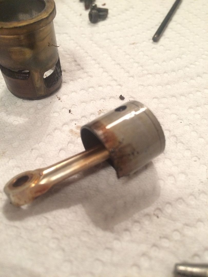

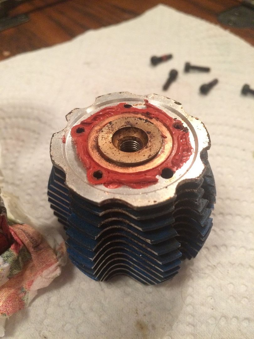

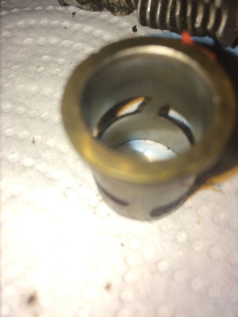

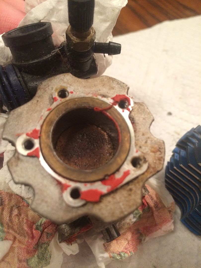

I took it apart someone made a mess of it but I think it should clean up well. No scoring on the piston or sleeve and the rod fit well on the crank pin. What's an easy way to clean everything off, brake clean?

Wow! Someone went a bit overboard with the RTV. That should just scrape off fairly easily, Brake Clean should get the rest off. Just remember to lube everything before you reassemble. I prefer Marvel Mystery oil for assembly lube.
I'd take a good look at the head gaskets, with that much RTV there they may be damaged. Or the previous owner was just doing a preventative seal.
