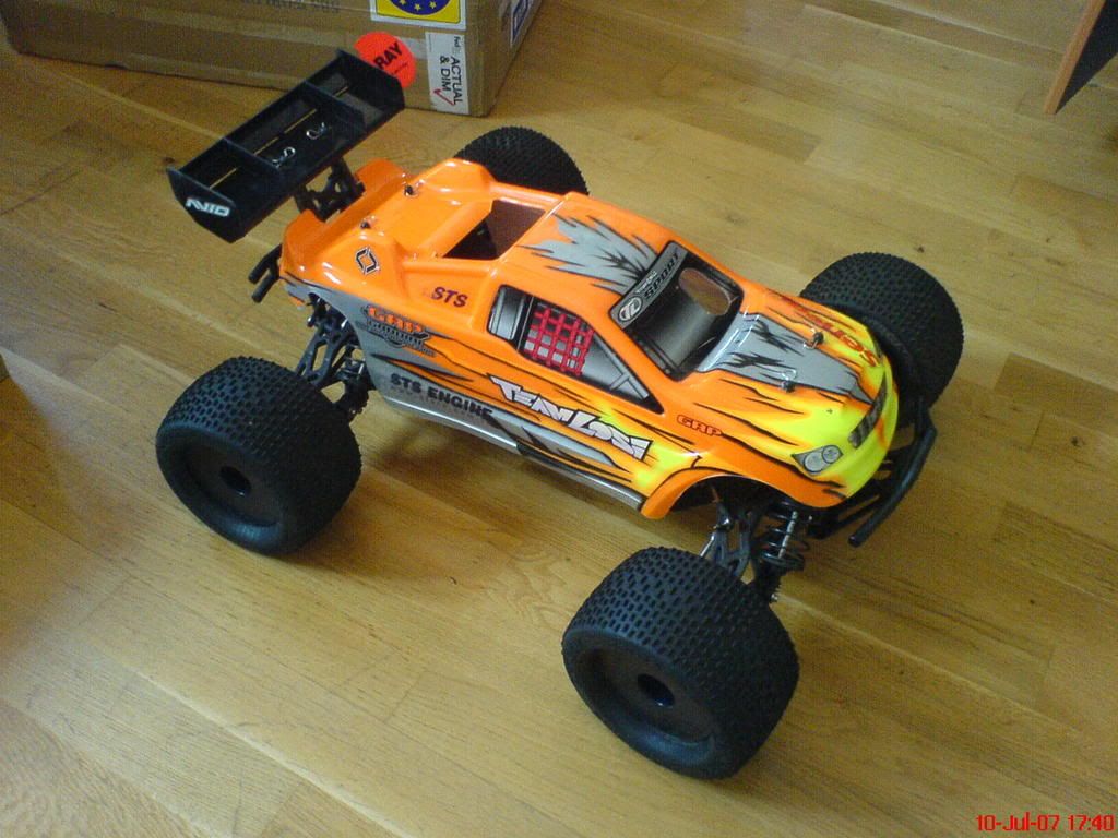

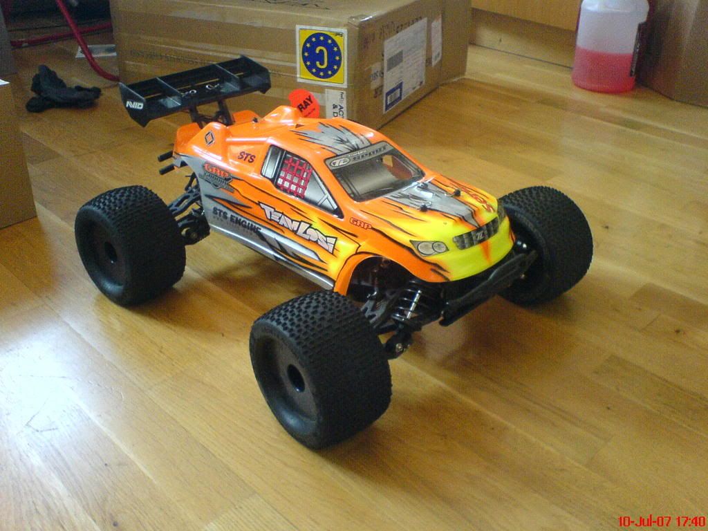

And, here she is:
The tires are just my Dirt Bonz on Ofna rims from the Savage.
Unfortunately too much work this week to really get it together - but it'll give me something to do on the weekend... Come on A-main and Killer, get here soon.... (I need that pipe and engine brace...)
Pretty happy with the purchase. Seems solid - was a good price. One tiny crack on a rear shock mount that will need to be addressed before any serious air is attempted, but for now no biggy..

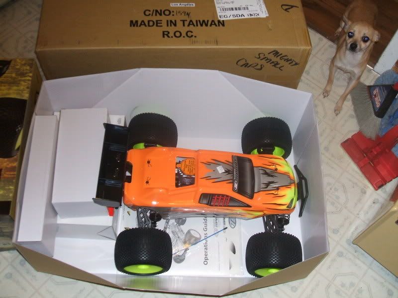

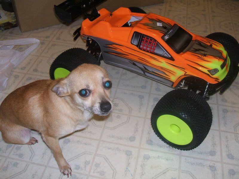

Man that box looks familiar lol.
My dog has to be involved in everything I bring in the house lol.

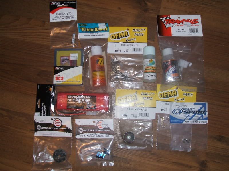

The expensive bag of goodies to go along with it

I did some research so I picked up an Ofna 12T clutch bell & 1.1 springs, Sportwerks 3 aluminum shoe setup, metal bearings to withstand heat better, Ofna shim kit to shim the clutch bell as that's where the heat issue & burnt bearings is coming from, Hitec crystal & DCX 3 channel dual conversion FM receiver, 3 & 10K weight diff fluid as they didn't have 7K, 35W shock oil.
Yes I know what was I thinking buying a Traxxas product lol!
I got the crystal & receiver so I can use my show truck controller for this & use the one that came with this for a different truck.
Post by KiZ » Tue Jul 10, 2007 10:50 pm
hey 2low4u, what's the bottom left item? It reminds me of the small wheelie bar wheel for the savage.

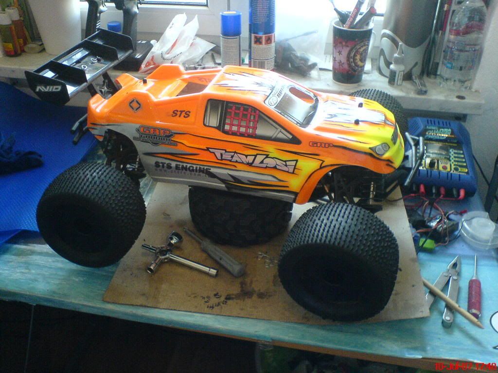

Nice ride.. They ARE awfully good looking trucks...

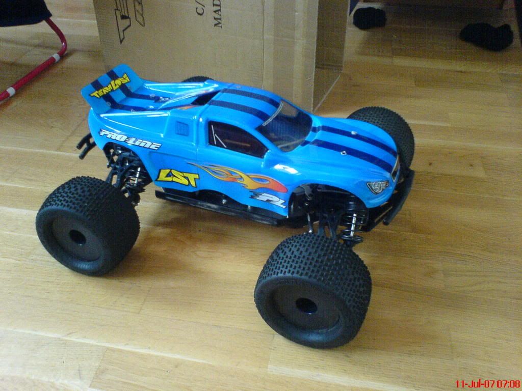

Here's mine with my LST2's Desert Rat..(just to see what it looks like - the holes don't totally match up - but I find it looks much better than on the LST2..):

KiZ wrote:hey 2low4u, what's the bottom left item? It reminds me of the small wheelie bar wheel for the savage.
That's a sportwerks vented flywheel that i'm going to rig up as they didn't have any 12T vented flywheels.

Nice Herr! I like the look of the factory orange better on mine than my desert rat body from my race truck though I think.

Is that the small version DR? Hard to tell - dark pic...
But yeah, the stock body looks pretty good IMO...
2low4u
Posts: 669
Joined: Wed Oct 11, 2006 11:00 pm
Location: Halifax NS Canada
Post by 2low4u » Wed Jul 11, 2007 6:11 am
HerrSavage wrote:Is that the small version DR? Hard to tell - dark pic...
Yeah it's the Savage/Revo one.
