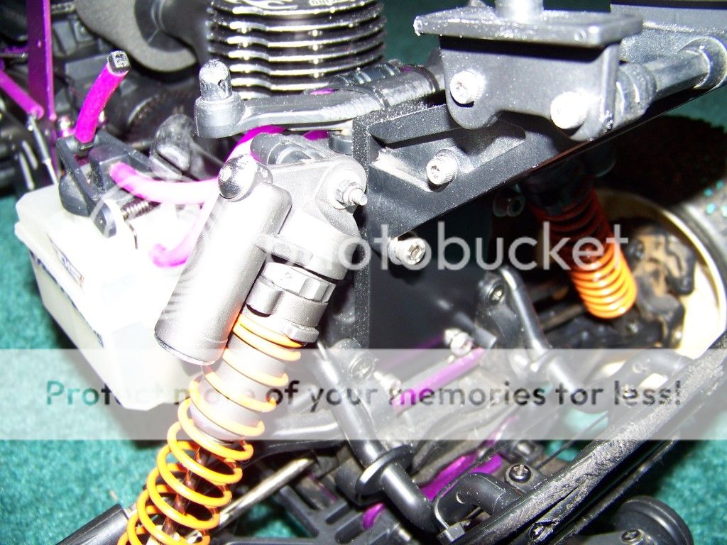

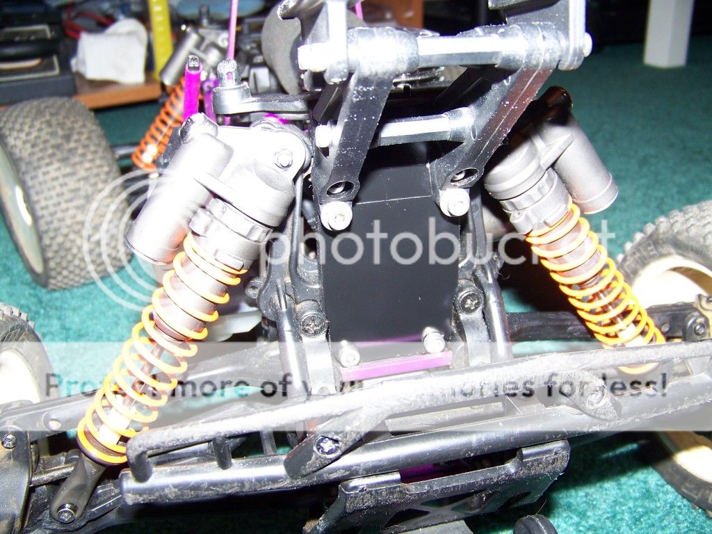

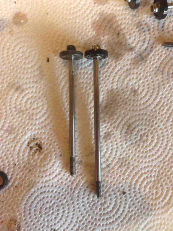

Post by LLkoolskillet » Fri Jan 17, 2014 11:24 pm
Here's mine
I have found that putting fuel tubing inside the shock tube on the shaft won't last long. It kinds folds up on itself. You can source out some hellfire or CEN gst shock shafts and that would work as they are shorter than stock.
CEN on the left
