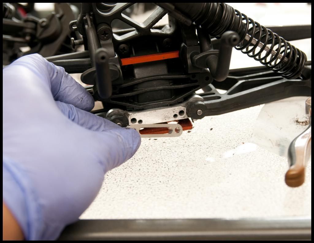

Swapping out this:
Tony's screws
This:
IRC LCG TVPs, 3 speed tranny and ALZA racing bulkhead brace kit
Into this:
Got some time to put this little project together. I was originally thinking of just building another Savage from scratch but instead have opted to just try out these upgrades on my current savage. Hopefully I can finish it in time. (Have a party to attend to at 6pm)

I_Like_Nitro, the brace kit is really nice. My only gripe is that there is that little peice that goes in the middle of the 2 front braces that does not fit correctly. I had to dremel a couple millimeters off both lower arms to make it fit.

But other than that, the kit looks rock solid. Everything else fits nice. You just have to cut off a few tabs on the plastic skid plates which have now been rendered useless.

I have to get some of this newer HPI arms as it seems HPI changed the design on arms a little.
@Mshark, have you properly aligned the front of 3 braces, as the pin should go little into front 5mm closing brace
so the 2mm rear closing one should lay flat on the 5mm one?

[quote="toplakd";p="882174"]I have to get some of this newer HPI arms as it seems HPI changed the design on arms a little.
Dejan[/quote]
Hey Dejan how are you? Everything fits fine except that little supporting peice that fits inbetween the main brace and that closing brace. The lower A-arm seems to have a little staggered shape. 1/2 of that part facing the bumper is larger than the other half facing the diff.
but I got it to fit perfectly. No biggie. I was concerned I had to shave off a lot to prevent binding but it was only very minimal.

Post by MShark » Sun Jul 20, 2014 8:51 am
[quote="I_Like_Nitro";p="882153"]
[/quote]
I haven't had any problems with doubling the 2 front stock braces except from time to time the extra brace would fall out on hard, awkward landings. I rigged up some ghetto solution by wedging a little peice of wood inbetween the 2 braces and screwing them into place to keep that extra brace from falling out. However the wood cracked after landing hard. That's when I decided to just get the ALZA kit. I'll post any reviews when I get a chance to go hard again on jumping. Especially now that I got the 4mm IRC TVPs, I hope they hold as well as the stock ones did.

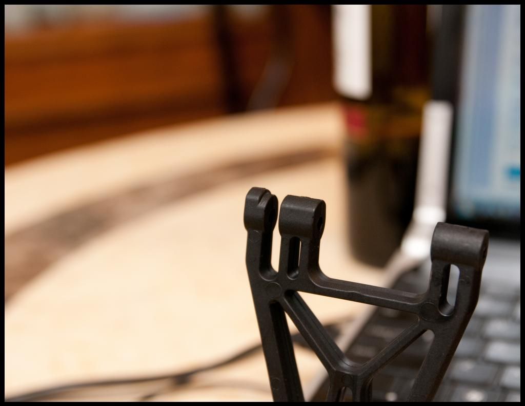

It seems that HPI changed the lower arms a little as how it seems there is aditional material
on the a-arm that couses the binding. All the original arms I have at home do fit perfectly.
Have you some realy closeup pictures of the arms, as on HPI website they are still the same
pictured as I have here. Probably outdated pictures.
Dejan

Post by MShark » Sun Jul 20, 2014 9:30 am
Here you go Dejan,
Front side
Rear side

Post by toplakd » Sun Jul 20, 2014 9:36 am
Thank you for the picture.
As I suspected this is new version of lower arm which has some extra material on the brace side.
Will have to get one to measure it.

Post by MShark » Sun Jul 20, 2014 10:02 pm
I didn't dremel any part of the ALZA braces, I just shaved off that little bulge from the lower arms. I just used a course grinder on the arms then manually sanded it down with 120grit sandpaper followed by a 300grit. Its now round and smooth like the rest of the arms. But come to think of it, I think it's better to shave off a little from that middle piece since it does nothing but keep the 2 main braces from binding the lower arms. It's just basically a spacer.
