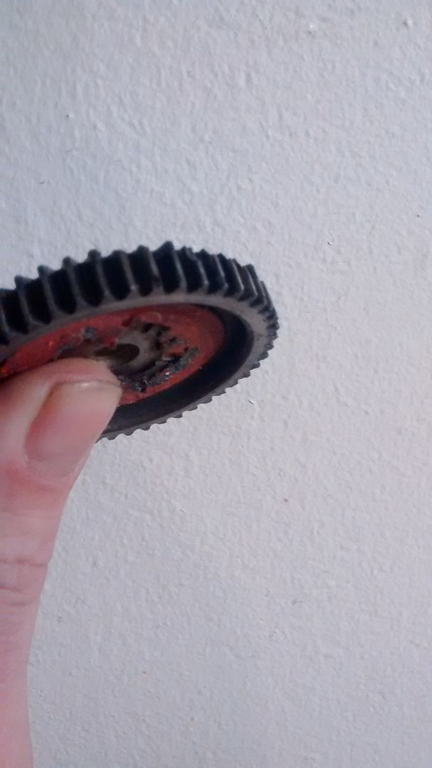

I don't suggest Robinson spur or cb after having a poor experience with them, i found others having the same bad experience, and as soon as I went back to HPI vented CB and Spur no more chips off the spur teeth. It doesn't strip but breaks off chunks of the teeth, IMO the Robinson spur might be too thick, the cunks come off either side of the tooth, however HPS HS spur is much thinner and I've ran the same spur on my basher ever since, not sane type, but the same spur for a few years, vs Robinson that lasted a few tanks.
If it ain't broken no need to fix it, HPI vented CB and HS Spurs are proven to last and if they work there is no need to go aftermarket with a questionable part.
That's just me tho, I'm sure some run Robinson's no problem, just what's the point when HPI vented CB and HS Spurs are tried tested and true.

[quote="JmaesV";p="887444"]Kool, thanks for the info.
I've decided to by the HPI Spur and CB (47/17) to run my Savage XL.[/quote]
Good move, if itcaint broke no need to fix.
I dug up a Robinson spur for example.
[url=http://s27.photobucket.com/user/Rac3rXGT4/media/Mobile%20Uploads/signature%20new%20shrunk.jpg.html][img]http://i27.photobucket.com/albums/c176/Rac3rXGT4/Mobile%20Uploads/signature%20new%20shrunk.jpg[/img][/url]

[quote="SiNiST3R";p="887447"][quote="JmaesV";p="887444"]Kool, thanks for the info.
Image[/quote]
Thanks man! appreciate you showing the spur gear, probably save me some cash in the long run.
