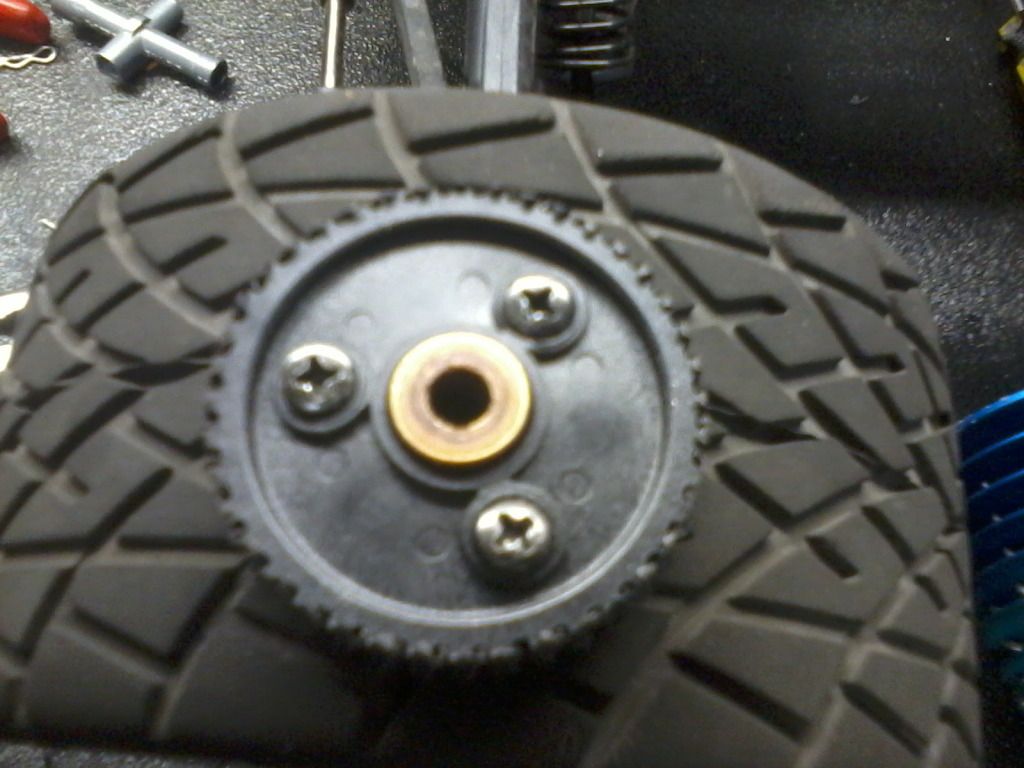

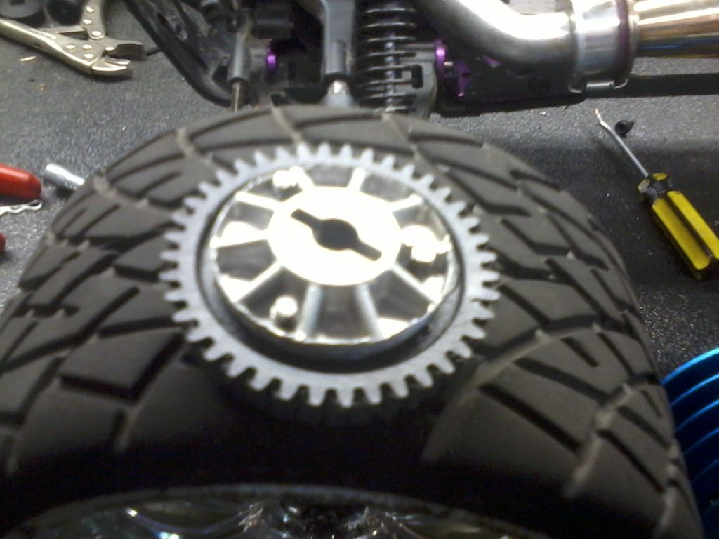

Skillet i guess bb spring and grub were in the botom of trans  :) also the truck sounds like its back on line , ready to try 40 tooth  :P or taller tires ?i wish i had video of my test run on the plastic traxxas 40 tooth but i can tell you it didn't seem to bog my lrp so i don't think it will bog  your picco

here is pic of 40 tooth mounted tImageo turned down hub .Image

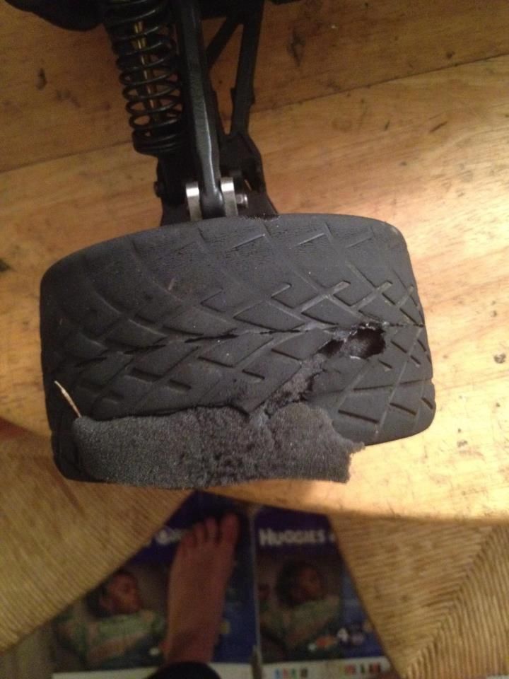

I did this earlier today but glued it together, well it didnt stay together with a run of 58mph lol. I have two more on order.

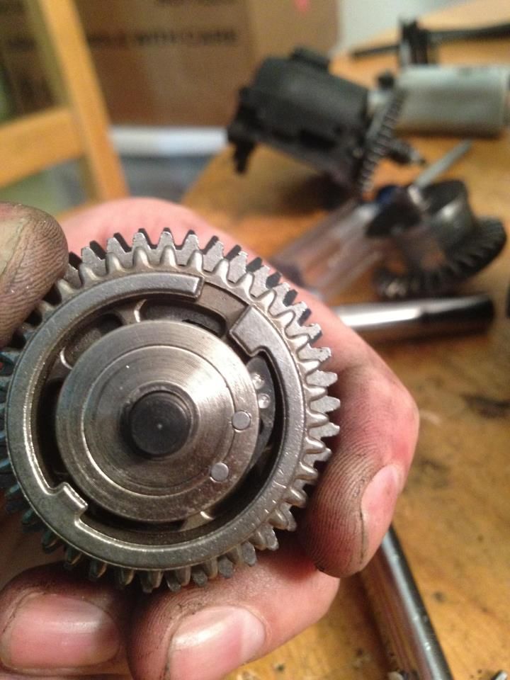

Figured out what that slipping sound is. Took the truck out again today and noticed it would not shift into 2nd. Basically sounded like it had stripped the cb or spur. Well I took the tranny apart and found that the 2nd gear pawl has been flattened and rounded off. Basically its to short to engage the gear haha. I guess after an insane amount of fuel and 3 1/2 gallons of ERCM Picco WOT runs it has met its demise.
Ill post of pics tomorrow when I can tear down to install the new clutch pawl.

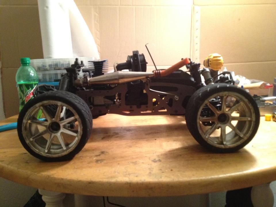

Last night I fabbed up the standard flux TVPs to fit nitro. Took me about 4hrs but it works and came up with some creative ways to mount things. Also dropped in the 19t cb to test out, then I'll move to the 20t then the 22t. But I have to heat treat the 22t because it's from the RS4 and is not hardened.
Post by LLkoolskillet » Thu Aug 23, 2012 3:47 pm
Notice how much lower the motor sits now
Before
After
Post by LLkoolskillet » Thu Aug 23, 2012 4:06 pm
Here are th pics of the bad 2nd gear clutch pawl
