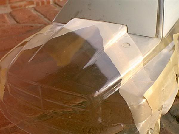

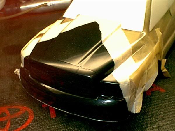

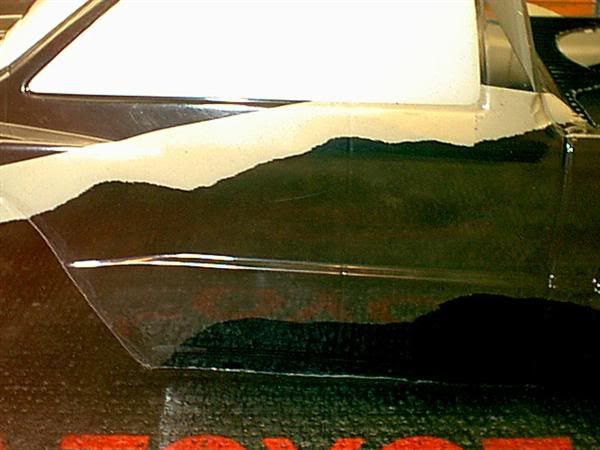

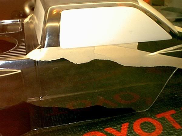

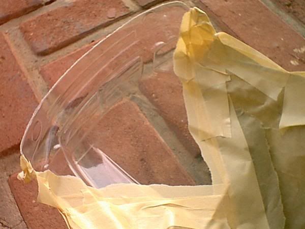

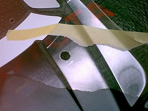

After the body is trimmed, cut, and washed thoroughly, the masking can begin. Since we are going for a ripped effect, we need to burnish the masking tape by pressing it down to the lexan more than you normally would. This insures a good rip when you begin to tear the tape. Here are some pics of the initial masking.

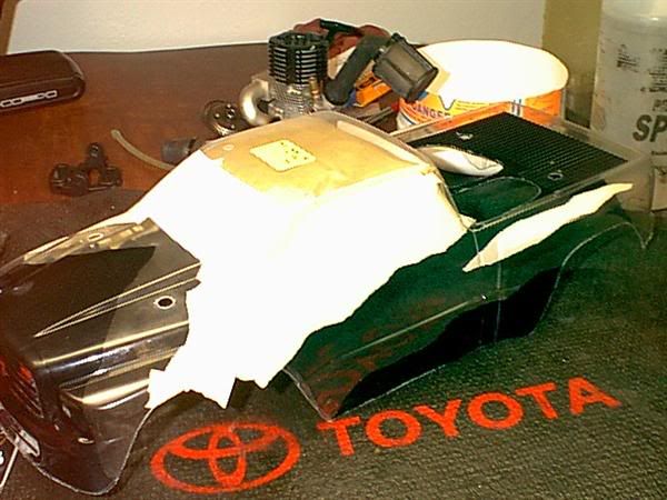

Ok, since this will be a three color rip, you need to paint the darkest color first, then progress to the lightest color. This helps insure that you won't have color bleeding. The next few pics were taken shortly after the black has been applied. I used Pactra #RC250 Outlaw Black (rattle cans).
Nearly every time I mask a body, I find some part of the mask that didn't get burnished down good and I get a little underspray. Here is how I fix it. Take a Q-Tip and break one end off. Then dip it in some denatured alcohol and scrub the area until it is cleaned up to my liking. This is the underside of the body. I laid it down on top of a paper towel so you could see it better. With the exception of the minor booboo, my rip job turned out pretty good here, it looks like the paper towel is ripped- but it's not.

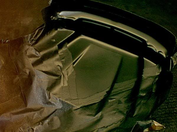

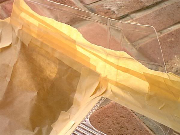

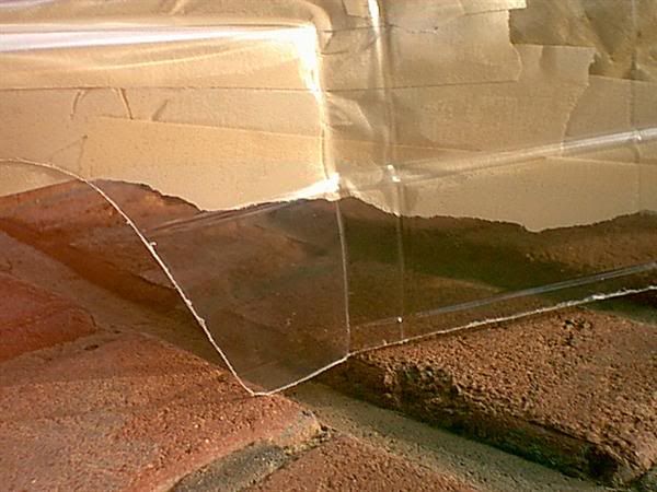

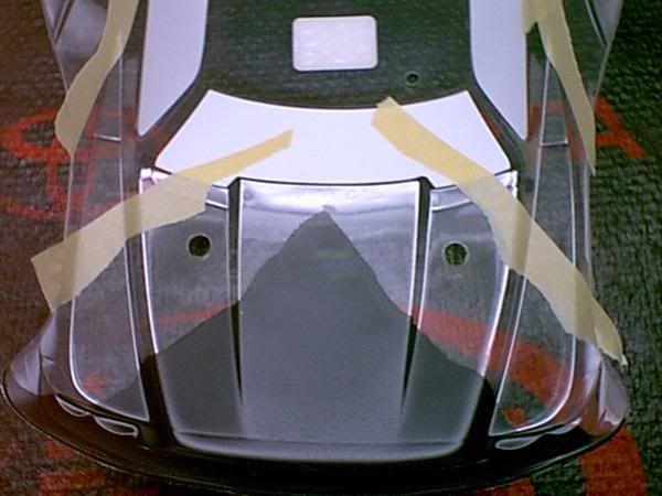

Ok, after letting the black paint dry overnight, now it's time to mask again. At this stage I am masking off and exposing the parts of the body for the next color. Here you can see why you really need to burnish the masking tape down. When you rip the tape, the torn edge sticks to the lexan. If you were to rip the tape first, half of the tape would tear from the top, and half from the bottom.
You can use two pieces of masking tape easily while ripping as it is hard to tell where one ends and the other begins.

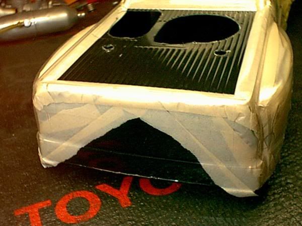

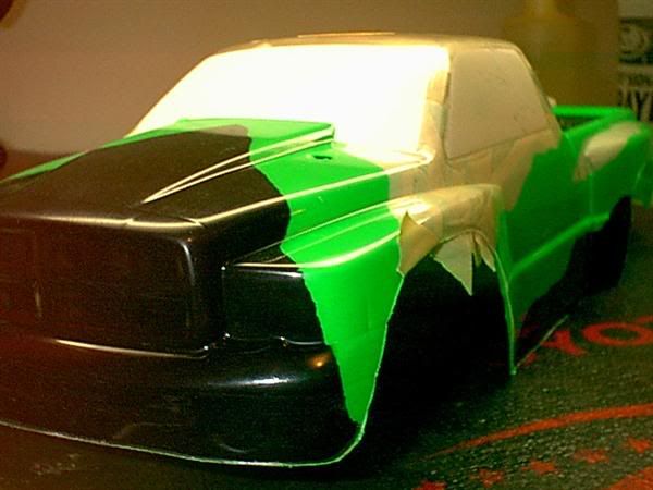

All masked off and ready to paint.

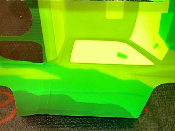

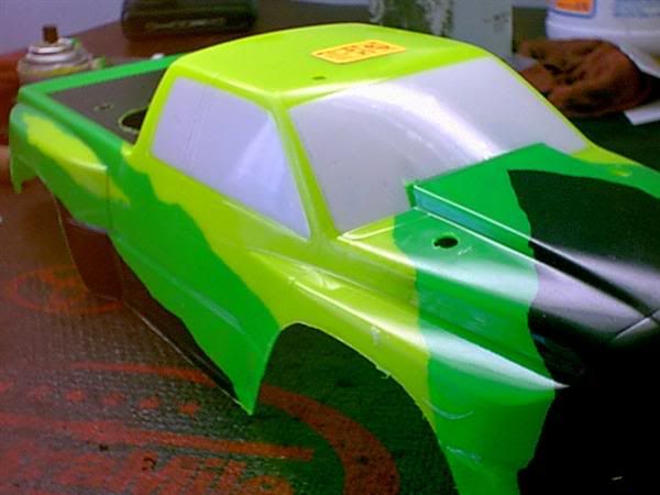

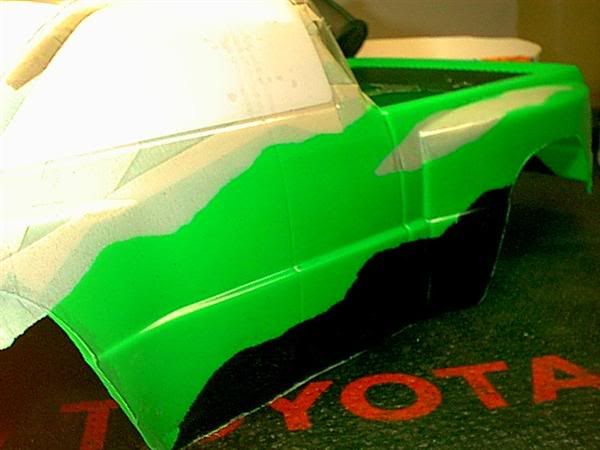

Now here we have the second color applied with the masking still in place. For the second color, I used Pactra #RC281 Fluorescent Green. Peel the masking off, clean up any mistakes, and allow to dry.

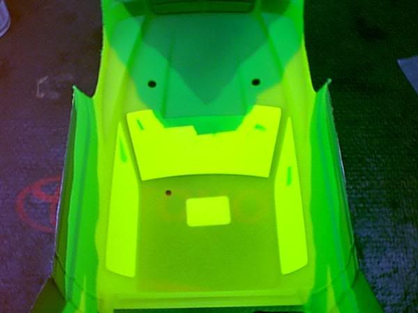

Now the second coat has dried pretty good, spray the third color on the remaining unpainted surfaces. For the third color, I used Pactra #RC279 Fluorescent Yellow. Notice that the paint is still somewhat transparent. This is common with many paints like fluorescents, candies, and many metallics, as the backing will really make the color "pop out"
Now the third color was allowed to dry overnight and this morning the white fluorescent covercoat was applied. I used Pactra #RC290. This will make the fluorescent colors really come alive, and the top coat is imperative if you plan on using spray window tint (Pactra #RC294).

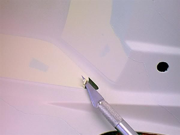

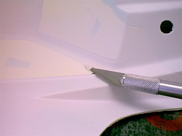

Now it's time to remove all of the window masks except for the windshield. I'm leaving the windshield mask on because I will be tinting the windows. Here is how I remove the masks. Take your exacto knife and pierce the mask a few millimeters from the edge and lift up. This way you won't risk messing up the edge of the mask and take some paint off by accident. After the masks are removed, let the topcoat dry overnight.

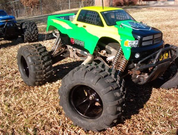

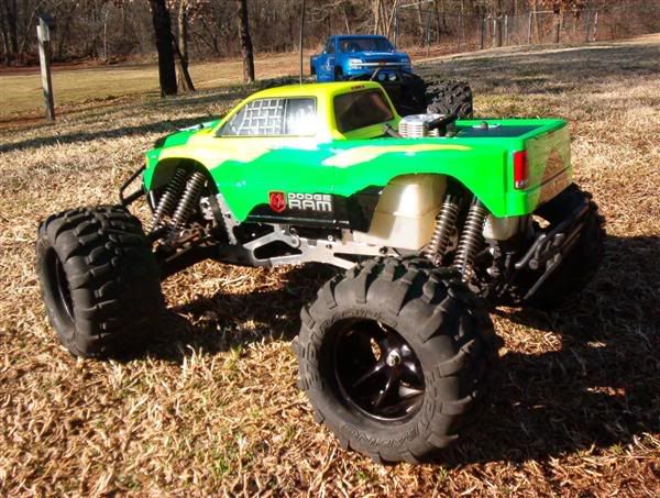

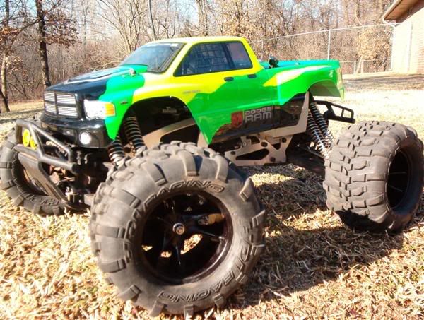

Ok, I got it all decaled out and mounted it on the chassis. Here are a few pics of my new creation taken just before I started bashing with it today.

Post by sfgascott » Sun Jan 18, 2004 6:08 pm
Ok guys I got it all finished up and started bashing with it today! :twisted:
Let me know what you think!

Looks great. Got a question though. Do you rip the tape with it applied to the body? Just go really slow? The rip lines look so sharp. Very nice Never did a paint job like that. Might have to for when racing starts come spring.....Matt

Yeah, you apply the masking tape and burnish it down real good so that when you rip the tape, it tears from the top and not the bottom. You can see what I'm talking about in the ninth pic down.
