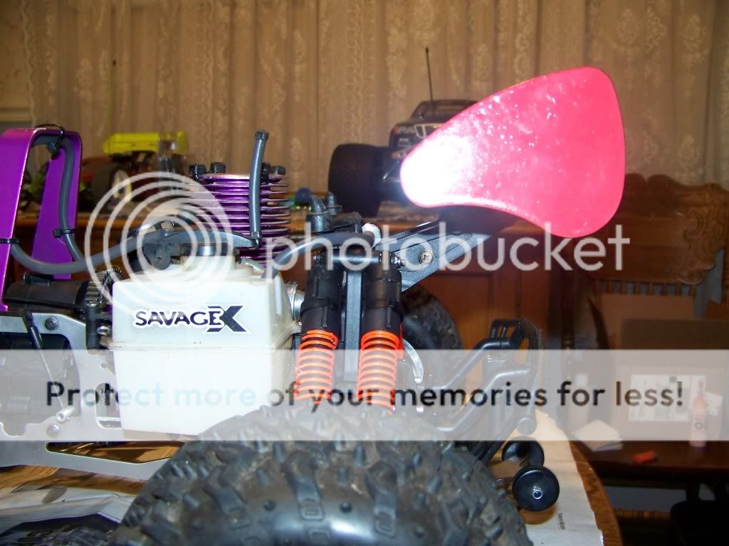

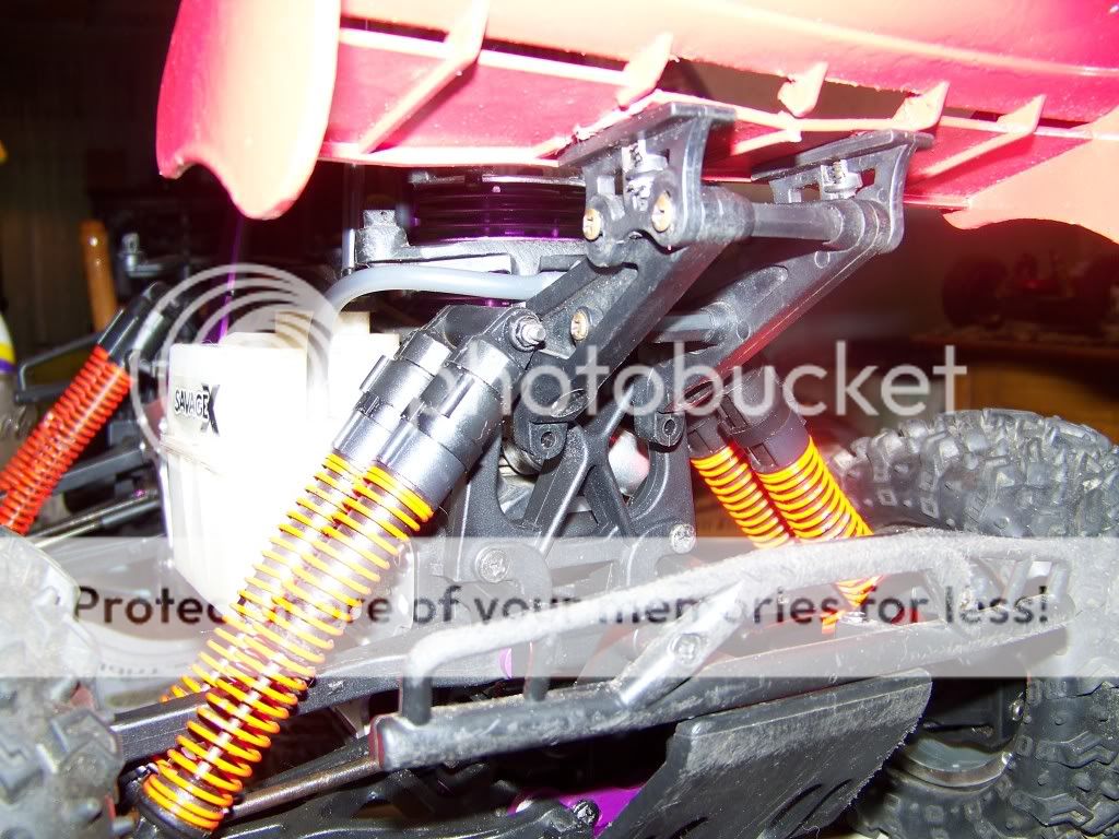

This is how mine is set up.
The shocks are CEN Nemesis shocks. CEN shocks are in-expensive and if you seal them up right they hold up very well. Alot of people like the losi shock mod. That is something else for you to look in to.
Also you might want to look into a mid tank mod or the ofna tank mod. I went with the ofna tank on mine.
I know that everyone hates aluminum a arms but the added low weight really helped keep me on all fours at the track. For a basher aluminum a arms are a no no but theres no trees to hit on the track.lol
A wing is also a good idea for a racer. There is not one on my truck in the pics but there is one now.
For tires its more of a personal choice. It is always good to have a light tire and wheel.
I have titanium beadlocks that are not made any more with HPI Dirt Bonz and Trinity racing foam in them. I also belted the wheels.
I didn't mention anything about an engine/pipe or LCG chassis plate because I don't know how much money you have to work with. Everything I mentioned are easy bolt on things that can get you on the track quick.

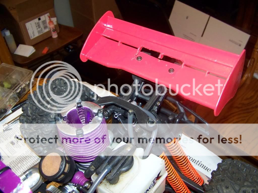

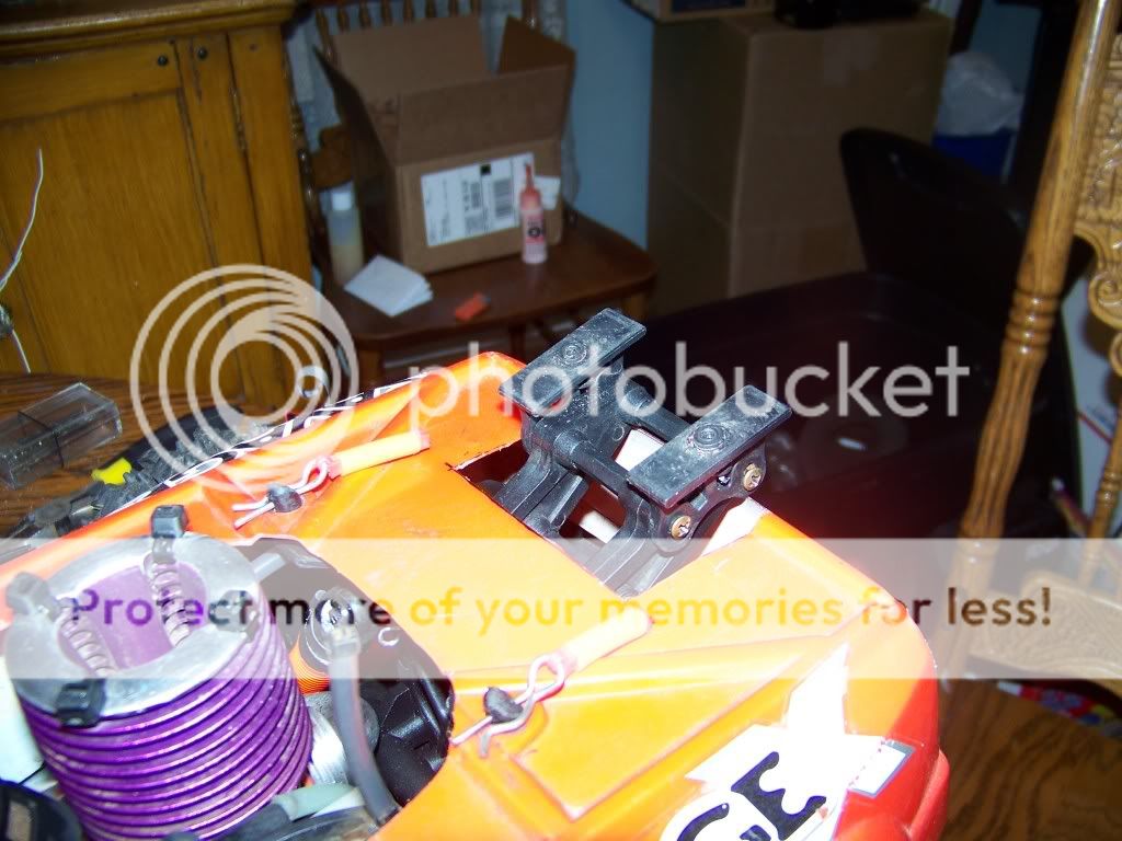

Heres some pics of a wing on my basher. This one has an ofna lx1 wing and mount.

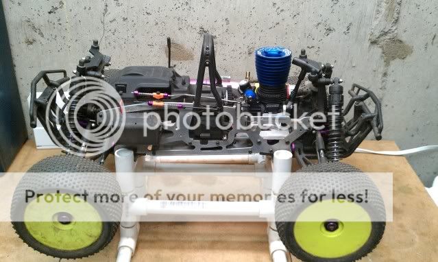

Here is my racer with the Innovative RC LCG 6mm front extended race chassis
Innovative RC
The IRC chassis is well built and very durable, I did have to mod the TVP's a little to fit the X SS roll bar. I think the TVP's were originally desighned around the Pre X roll bar. Other than than the roll bar issue everything was a perfect fit.
I hope this helps.
