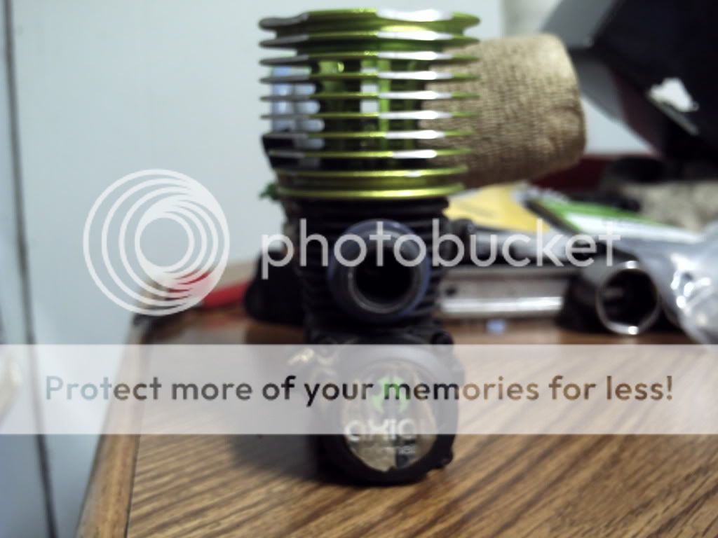

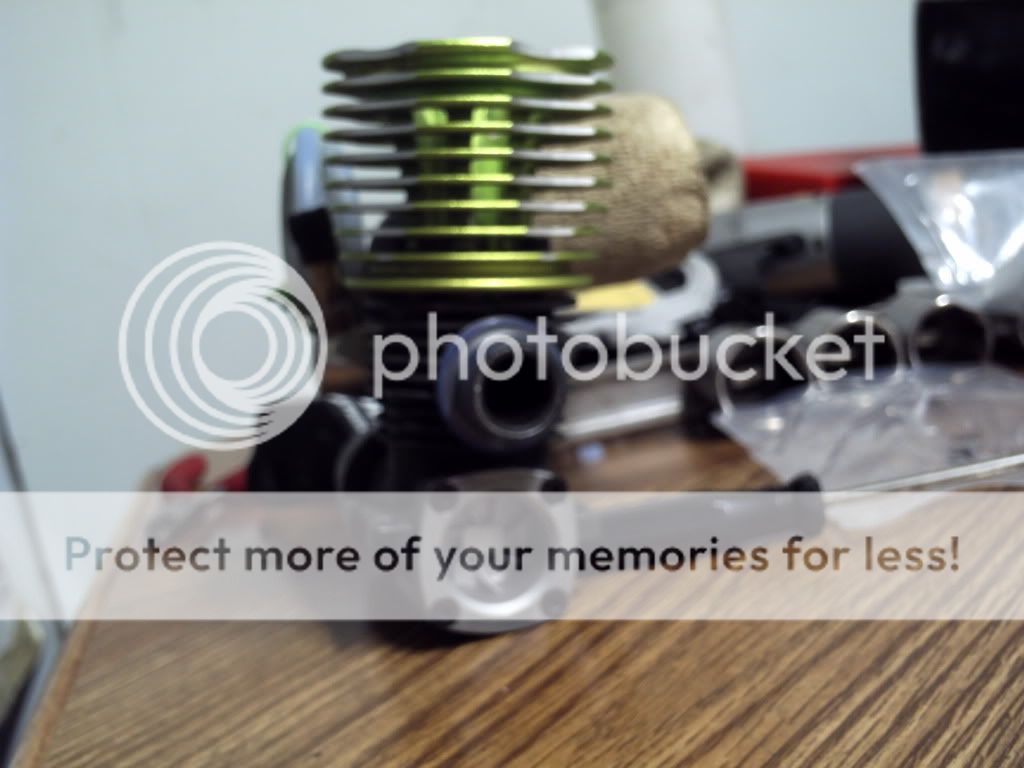

Post by SLAYERDUDE » Sun Apr 01, 2012 11:39 am
Lowering the engine does 2 things - makes the flywheel closer to the chassis so the bumpbox wheel fits in the slot and grabs the flywheel good, and lowers the CG.
The chassis on the D8T would need to be ground out so the Axial .28 2S pullstart would fit in with the stock engine mount so I installed the optional bumpstart backplate, this also saves some overall vehicle weight and rotating mass on the crank which will help the engine wind out quicker.
Idle quality can suffer if you convert a pullstart engine to bumpstart because there's less rotating mass turning at idle (by removing the OWB parts that normally spin with the engine all the time), unless you use a heavier flywheel. On my Axial I just kept the idle gap open a little further and it would idle all day long.
