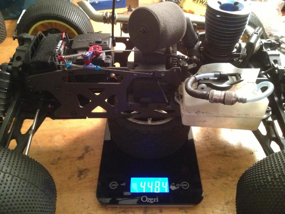

ok to start i got my flm ext down to 10.5 lbs tonight which i started at about 12 lb  pic to come as soon as my phone and photo bucket find each other .my plans are a x chassis with what i have shaved off the flm chassis truck and when i get the carbon fiber stuff make a light x chassis hope to be in the 9 lb range .
Post by LLkoolskillet » Sun Dec 02, 2012 9:48 pm
I dont have a single piece of carbon fiber on my truck.... 9.8Lbs still not finished cuttin weight, goal is to be under 9.5lbs

Heres where I am. I started building the tranny. Still have to lighten my 3rd gear, might do it today when i'm done work. Will a 5/64 hole be too small? I figure I will try that and see if more is needed. Sunshine, LL How much did you guys remove? Also going to build my cen/ hellfire diffs as soon as I get one more savage .21/ hellfire plastic cup

I started with my custom XL tipin the scales at over 12lbs. I have then removed about 2.5lbs of weight. That's a huge gain in power to weight. As far lighting the pawl. Just take a little off at a time and test run it
