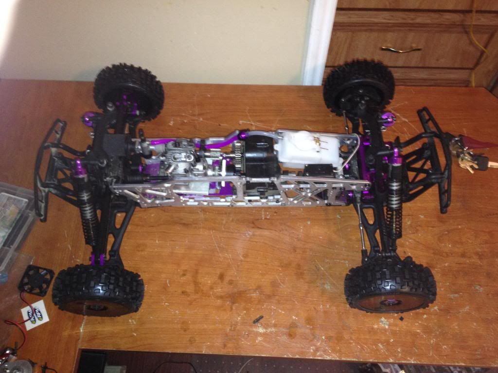

here's what i got going on
after converting to bl then getting bored of that I sold off the motor and controller. that was a while ago and now i'm missing my savage, So I realized i have almost enough parts laying around i might be able to come up with something
might be a little under powered being a fs40, its just what i had laying around

Post by Roost » Sat Apr 12, 2014 2:32 pm
how she sits now
nothing really is fastened down, still lots of work to do
Post by johny723 » Sun Apr 13, 2014 4:49 pm
the motor will not have the torque to move the MT tires, but it could be interesting to see how it performs out of a " MT class "
I mean putting smaller wheels( = lighter) and lower shock towers ( hellfire shocktowers). Making it kinda "rally" or even "onroad".
just a suggestion!
Otherwise a cool project!
BTW, the badlands in the first picture are MT size and some buggy size in the last one right?

Post by Roost » Tue Apr 15, 2014 6:08 pm
thats my thoughts on the tires exactly, plus i really just wanted to see how it will handle with buggy tires. the servo should have to work less against gyroscopic force making it more responsive? should be interesting
correct mt tires in the first pics buggy in the lower
Sharkey_t
Posts: 1355
Joined: Mon Apr 06, 2009 11:00 pm
Location: Abbotsford BC Canada
Post by Sharkey_t » Tue Apr 15, 2014 8:55 pm
its actually quite the opposite, a 4 stroke will make far more low end torque, however they top out around 20,000rpm depending on the motor (ive had my fs40 car motors above 26000rpm). as a result you need to change the gearing to suit the narrower powerband, and most gear it to see the same top speeds as a 2 stroke, resulting in a loss of off the line power.

Post by Roost » Sun May 04, 2014 6:47 pm
seeing how the 4 stroke is a little on the heavy side im trying to get it low as possible

Post by Sharkey_t » Mon May 05, 2014 12:36 am
its looking good. one thing though, i know its tempting to mount the carb facing down as its less likely to break off if you flip the truck, however it doesnt work very well. iirc it blocks half the port off, and our carbs dont really like pointing downhill. the airplane carb was designed to be an updraft, the car engine carbs arent designed like that.
