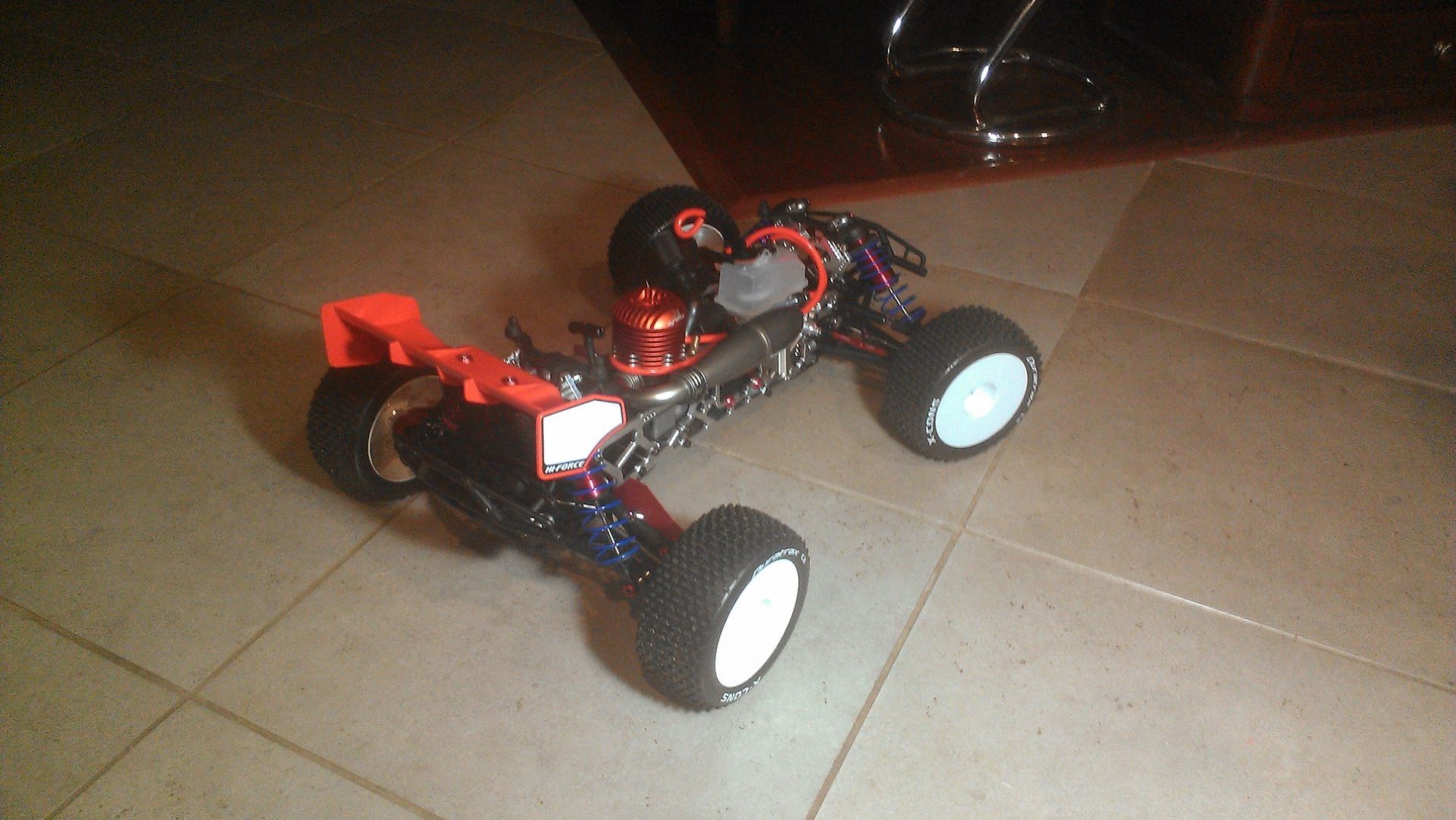

Post by NizzleMaShizzle » Fri Jun 12, 2015 6:16 am
Here's my redrum'd out midtank savage build. Finally got all the pieces. Powered by a Dynamite Mach 2 Big Red, Dynamite 086, HPI Flux 45T steel spur, 17T HPI vented clutch bell, Mugen MBX7T Flywheel, Mugen clutch nut, Mugen colet, Mugen 1.0 springs, Dynamite max life shoes, Ofna Wing, Hotbodies mount, FLM ext chassis, FLM LST Shock conversion, FLM Towers, FLM Skid, Losi XXL2 shocks, RC Raven dual rate springs 35wt front 40wt rear, 43/13 bevel/pinion diffs with 30k front/20k rear (they feel much smoother than the 29/9's so i'm gonna try em' out for now), Alza braces, HPI sways, HPI adjustable uppers, Traxxas toe links, Integy 17mm hubs/carriers/steering knuckles, MGT tank, HPI firestorm battery box (relocated battery to the rear), RPM Rc10GT receiver box, RC8 antenna mount, (2) TS-170 servos, Apex servo wire wrap, Duratrax X-Con 1/2 offset truggy wheels, DIY rear mudflaps, Robotronic style clamp servo horns, Motorsaver air filter, Dynamite fuel filter/exhaust cooler, Midtank Ofna linkage mod,dubro lines, One off Nizzle special custom Ken Block lid with carbon vinyl wrap, and a whole lotta TLC.....

Post by Squid » Fri Jun 12, 2015 5:05 pm
Interested to hear how the Big Red performs, I loved the original Mach .26 that it is based off of.
Post by NizzleMaShizzle » Fri Jun 12, 2015 5:13 pm
I'm interested too! Not to much information I have found on it. In some forums people have said it is the older LRP.28 others say its a hotter version of the Losi 427. I'm just gonna have to wait and see. So far from the people who I've asked who run it, say that it's pretty beast.

Post by Squid » Fri Jun 12, 2015 6:12 pm
The Losi 427 is basically a Mach .26, owned them both years ago. I currently have a Mach .28 platinum in my poor sav that hasn't been run in a year or so, it's a low end torque monster from what I remember....

Post by SV250 » Fri Jun 12, 2015 6:13 pm
Its is the first verv. Lrp spec. It rips just like the three spec. Almost the same eng. missing two tiny bypass ports. Neal said they dont do squat anyway. I have one as well as a spec three and losi 454. All the same bgreat engines

So I gotta question then...is this engine truly a .28 or is it a .26? Or even a .27? I don't really trust advertising anymore I rather hear it from you guys

Post by SV250 » Fri Jun 12, 2015 10:20 pm
.28

Appreciate it brotha! So it's more closely related to the LRP.28 and 454 rather than the 427/mach .26...Correct?

Post by SV250 » Fri Jun 12, 2015 10:25 pm
Correct.

Oh another question...if its related to the 454 and lrp28 is the LOSI turbo head conversion compatible?

Post by SV250 » Fri Jun 12, 2015 11:42 pm
Yes if you wanted to. Theyre more expensive and not much power gained. All the Sh .26/27/28 have the same head patteren. Mack.26, losis454,bigred;sh, lrp are all interchangeable.

Post by NizzleMaShizzle » Wed Jun 24, 2015 9:15 pm
Here's a video of the Big Red.....Ran 1/2 a gal on the Big Red with a dynamite 086 and 17/45 gearing. The bottom was way too soft for my tastes with this setup. Decided to gear down to 16/45 and switched to a 053 cause the engine didn't have enough torque to pull higher gearing. Needless to say, the engine came alive and I'm liking the 053 and 16/45 gearing better. Still want to try 15/45 on it, and I'm also waiting for a THS pipe to try it out. Making progress...I attached a teaser here and check it out my full vid on YT!
