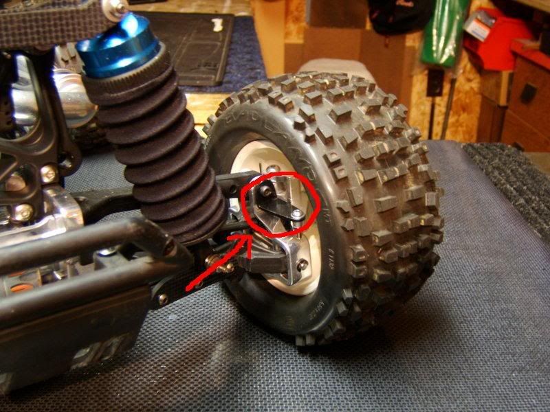

Post by Integra » Sun Feb 18, 2007 5:42 pm
the thickness is 3.25mm and i cut it with a Diamond cut off wheel....everything by hand....the Kevlar is 1 ten thow sheet sandwitched inbetween 6 and 6 of CF....Tensile strengh tests when ever we get the chance to.

Very nice! I'm liking the way you laid the cf on the bias. Is the kevelar 90 degrees form the cf? Once again, very impressive work.

Albatross wrote: I'm liking the way you laid the cf on the bias. Is the kevelar 90 degrees form the cf?
typo...or am i having a brain fart?.....laid the cf bias ?...and what about the kevlar and 90degrees ?

Post by bendover » Sun Feb 18, 2007 11:44 pm
I think he means the grain, overlapping the Kevlar parallel with the grain of the CF won't be any stronger, it has to be laid 45-90 degrees to the grain.

Post by Albatross » Mon Feb 19, 2007 8:44 pm
Yes, there was a typo-I wanted to know if the kevelar was oriented at 45 degrees to the cf, not 90 degrees. Sorry for not explaning. You laid the cf grian(the direction the fibers are oriented) at a 45 degree angle to horizontal and verticle. I was wondering if the kevelar was oriented 45 degrees to the cf. Changing the orientation of the fibers between layers will determine the tensile strength and flexibility of your composite.

Post by Integra » Mon Feb 19, 2007 11:04 pm
Albatross wrote:Yes, there was a typo-I wanted to know if the kevelar was oriented at 45 degrees to the cf, not 90 degrees. Sorry for not explaning. You laid the cf grian(the direction the fibers are oriented) at a 45 degree angle to horizontal and verticle. I was wondering if the kevelar was oriented 45 degrees to the cf. Changing the orientation of the fibers between layers will determine the tensile strength and flexibility of your composite.
yes all the layers are opposite of eachother.
