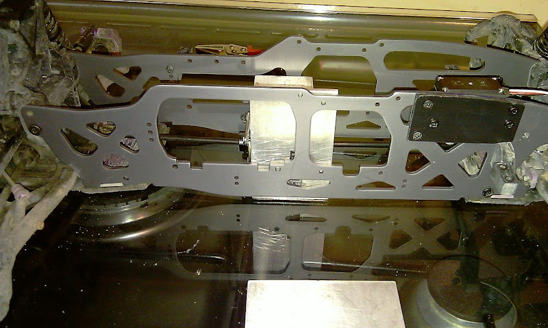

Post by s2022 » Mon Jan 23, 2012 2:02 pm
Have been enjoying the RC for less than a year now, this forum has provided a lot of insight to the hobby through its members and their great conversions, tips and experience. I feel I need to return something back by posting my humble conversion.
lots of ideas have come from different conversions and forum members, a thanks to all.
It started with the need for more power and a center diff. I pefered to do it the custom way as much as possible. And obviously castle creations sale; got my self a 1717. well and tried to save some money.

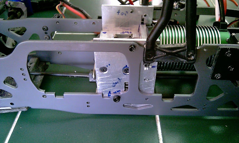

Post by s2022 » Mon Jan 23, 2012 2:58 pm
Some more views before how i am starting my build
this is where i plan on mounting my esc
this is how the motor will be adjusted for meshing the pinion and diff spur
mechanical brakes, i still haven't sorted it out yet, will get the motor and center diff in, then figure out the brakes.

Post by s2022 » Mon Jan 23, 2012 3:06 pm
cut the alum pieces, 3mm for the sides, and 6mm thick for diff top and bottom plate, also 6mm for the motor support plate.
relocated the servo, got rid of the rx and huge servo box.
checking some clearances, double checking the 3d matches the actual progress. especially screw locations.

Post by Roost » Mon Jan 23, 2012 4:28 pm
Awesome man. is that a idler gear on the center diff?. center diffs are definitely the way to go for durability
keep us updated. love seeing new projects and designs
Posts: 405
Joined: Thu Jan 13, 2011 12:00 am
Post by s2022 » Mon Jan 23, 2012 4:39 pm
thanks Roost,
which pic are you referring to?
its just a motor pinion direct to a center diff.
ah maybe the exploded view ; last pic of post #2, thats the motor pinion still in place, was just showing the installation setup; in the 3D view moved the motor, plate and screws back and separated them apart.

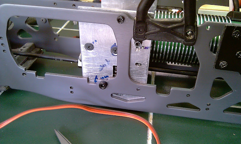

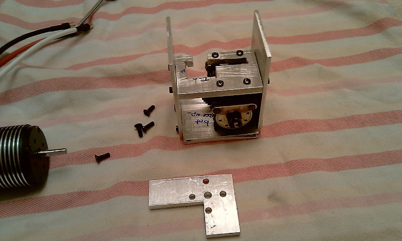

Post by s2022 » Mon Jan 23, 2012 4:54 pm
most of the work is in the center diff housing, motor plate almost finished, screwholes countersunk.
excuse my bad cutting, will try and file it and finish it off better ;) using just available simple equipment; (a hand drill on mount and some files)
tapping the screws, and contersinking the alum plates, don't have a countersink bit, used an oversize drill bit. it did a crude job but can live with it.

Post by s2022 » Mon Jan 23, 2012 5:02 pm
moment of truth, installation finally in my savage.
used the screw holes on the tvp to support the 3mm left and right plates. the 3mm plates were tapped for easy installation and dismantling in future.
feels good when all goes as planned, very tight clearances, the motor actually does not touch the tvp. servo arm is clear also.

Post by s2022 » Tue Jan 24, 2012 2:38 pm
some details i forgot to mention at the beginning of the thread, the center diff spur is a 52t, planning to start with 13t or 15t pinion; according to my calculations 14t or 15t should be close to stock savage flux with 1515 2200 motor.
got my diff and motor mounted
