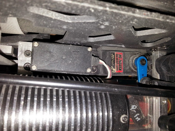

Post by s2022 » Mon Jul 28, 2014 6:21 pm
Haven't updated the truck since a long time, just bashing it and it still hold up good. Only the usual maintenance and some breakage, have been running a lot through spurs and pinions though.
Anyways, got a new  Hitec HS-7954SH High-Voltage Servo, with a 10amp CC BEC to run it through its true potential on 7.4 Volts.
Had to retire my old cheap HK 15298B, it just stopped working. well cheap is cheap, it did its dues for what it cost.

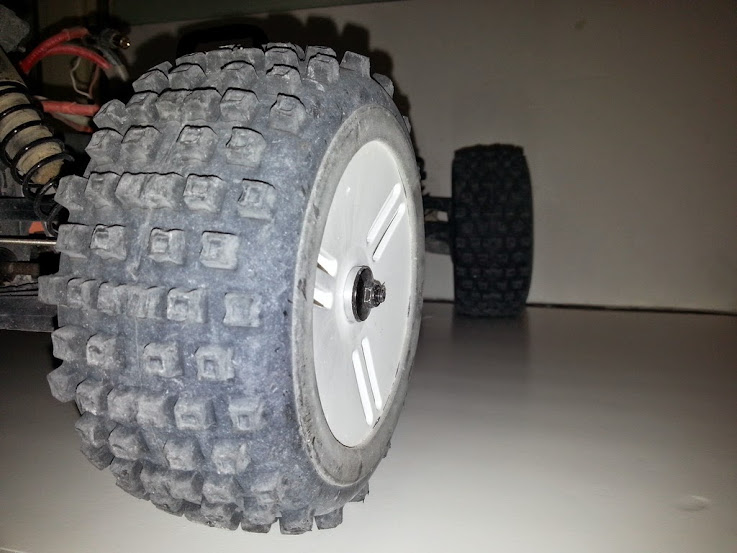

Post by s2022 » Mon Jul 28, 2014 6:31 pm
The issue is they don't come with a standard hex, but use the 18mm square!! Well turn on the CNC and get some adapters milled  :D Some photos:
Some measurements and some stock 6061 Aluminum laying around
First side done and test fitting.
Some custom washers to snug fit the nut:
And here is the result:
Used the wide axles, had to drill new holes, now they can be used for these tires or the standard hexes.
Some size comparisons with the Bowties I was using previously.

Post by s2022 » Mon Jul 28, 2014 6:34 pm
Having bashed them for 2 runs, they hook up great, and what I noticed is that they do not balloon at all.
I can't explain it but the material is much more tougher. Weight wise they are around 460 grams a piece. Slightly heavier than the Bowties "front" I was using, but I think lighter than the Baja "rears".
