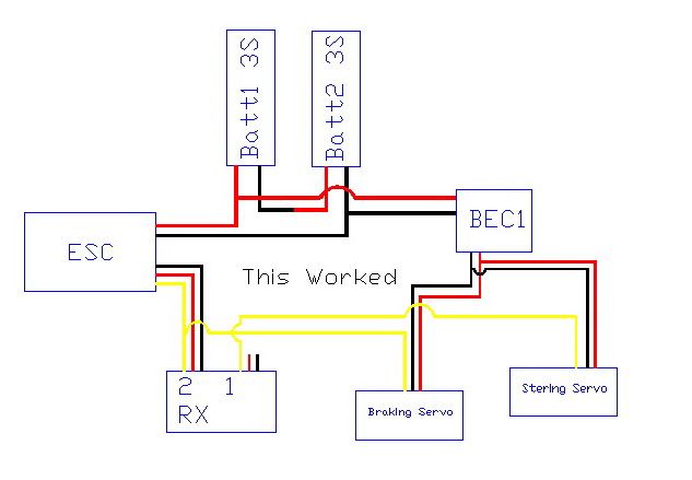

Post by s2022 » Wed Sep 12, 2012 3:53 pm
Need some Help Please!
Was trying to hookup my Servos to an External BEC without going thru the Rx, as i am planning on running the Steering servo on 7.2v and the throttle on 5.5 or 6v and both from external BEC.
This is the Layout i have in mind, which I actually tried but it did not work?!?!  any thing wrong i am doing?

Post by FluxNZ » Wed Sep 12, 2012 4:23 pm
The way I have it setup for my Mamba XL2 is the wires +/- from the BEC should be going to battery 1 +/-. Not sure about running 2 servos from the BEC?

Post by s2022 » Wed Sep 12, 2012 4:29 pm
I don't think there is any difference between batt1 or batt2 as both are 3s; it should not matter, i know usually your remove the red wire from the esc to the bec and feed the rx from the bec thru the batt / aux channel . will try to sketch it up, and will try it. but to make the most out of the servos i have, I need different voltage to each.
Thanks anyway FluxNZ  :D

Post by FluxNZ » Wed Sep 12, 2012 4:32 pm
Yeah I was looking at the diagram and thinking that too but thought I would pass on what worked for me. I let the ESC power the reciever and the BEC power the steering servo.

Post by s2022 » Wed Sep 12, 2012 4:41 pm
that's what I'm trying to do. how did you hook up the three wires of the steering servo?

Post by s2022 » Fri Sep 14, 2012 6:05 am
Thanks FluxNZ, i see what you mean, the problem was not the connections from after the BEC, the issue was that the BEC and RX were powered by different Battery sources. Got it sorted out with the help of guys on another forum.
It seems the signal gets corrupted of the power sources are different, or of different sources.
These 2 diagrams worked:
