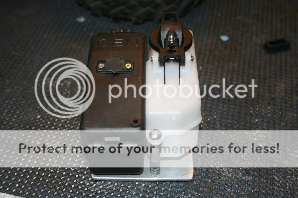

Post by Sharkey_t » Sat Feb 25, 2012 1:51 am
im about half way done the radio box. here is a couple quick picks i snapped along the way
what i did here was use 1/4" tape wrapped around the radio box. i then cut on either side of the tape, this removes 1/4", plus the thickness of the blade (roughly 1/16") on either side of the tape line. the end result was this
a radio box that in 3 pieces. had i done it perfectly i would have been able to slide the 2 pieces together with very little gap. it didnt go perfect and i had to do some filing to fit it, but the end result was a radio box thats 3/8" shorter waiting to be put back together
i glues the box in a few spots with thick ca glue while clamping both pieces to a piece of aluminum. once cured i removed it and used 5 minute epoxy to fill the gaps and hold it together. not shown is the lid, once the epoxy on the box was dry i fit the lid on the box and stuck the lid together. once it was cured enough i took it apart again, put epoxy on the inside of the lid and box and am letting it cure overnight.
tomorrow ill start to clean up the epoxy, once im done nobody will know it was shorted. or that it was a cen part

Post by Sharkey_t » Sat Feb 25, 2012 4:07 pm
got it sanded out out today, once i get a coat of paint on it nobody will ever know what happened to it. i still have to finish the lid, it wasnt quite strong enough so i re did it with a brace on the underside. the epoxy isnt quite cured enough to sand properly.
and it is all mounted. 2 screws in the bottom plate and 1 from the chassis, seems plenty strong. im unsure yet if im going to put the charge plug through the box or not. its easy enough to open this radio box up to grab it, but its sure nice just plugging the charge lead in.

Post by Sharkey_t » Fri Mar 02, 2012 12:51 am
starting to come together now
i got the fuel tank yesterday and as you can see its mounted. ive put the old engine plate in for the time being so i could mock up the throttle servo. ive got most of the fab work done, just need to pull it back apart and do the finish work on everything ive built and i should be able to start screwing it together. still waiting on the rest of my parts, but should be able to get most of the truck together before they show up.
Post by dodgedude » Fri Mar 02, 2012 1:52 am
Its looking good for sure Sharkey, I like what you did with the Mid tank plate, Good thinking :wink:. You managed to sit it probably 1/8th inch lower than mine, Im curious to see how your steering servo sits. On my truck the servo is not mounted to the plate so it sits very low, I actually lucked out and it fit just behind the skid plate cross brace.
Chopped CEN tank with charge lead. My Cen box mod did not turn out pretty either, I ended up using a black Jiffy Marker to cover up the glue, it works decent from a distance 8)  :lol:
