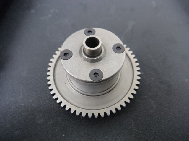

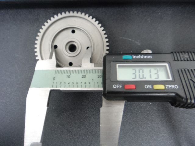

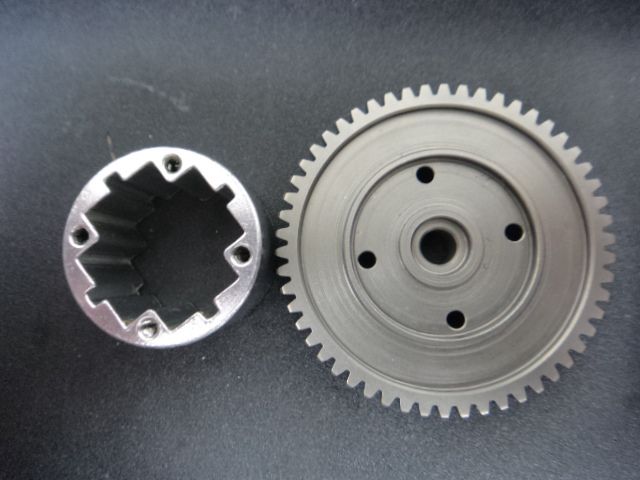

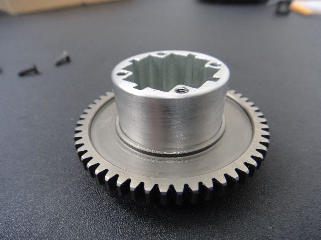

Ok I had a go at assembling the CEN diff housing and the Associated RC8T 54T spur but the CEN diff housing won't fit into the lip of the spur? Thought about forcing it into the spur by using a vice to pressure fit it in but I would most likely split the cup and never be able to get it out again. It's just too tight. See caliper measurements.
Looks like I would have to order the CEN GST-E centre spur gear (66T).

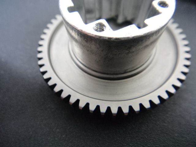

Post by johny723 » Fri Dec 13, 2013 4:58 pm
I would try filing down the edge and the side of the cup. The aluminum is not very hard and it does not need much material to be removed, 0,3 mm from each side is not a big deal. As long as the holes line up, you cant do any damage to the diff.
Post by FluxNZ » Fri Dec 13, 2013 6:12 pm

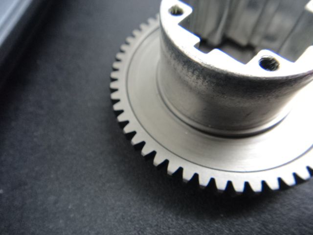

I'll have a go and mount it in a drill so I can get an even radius around the cup while file/sanding it down (attach the ring gear so the drill can grip the place where the bearing sits) :wink:

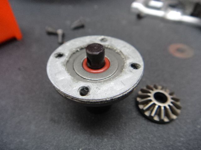

Post by FluxNZ » Sat Dec 14, 2013 1:08 am
Filed down the cup:
Fits nice and snug into the spur gear:

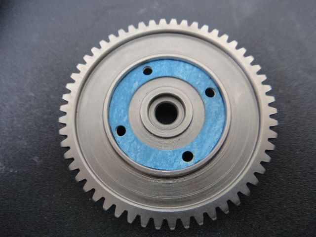

Had to cut down the diameter of the gasket and used 2 to space the spur further from cup so there was no binding:
Had to put 3 gaskets on the other side of the cup to avoid binding as well:

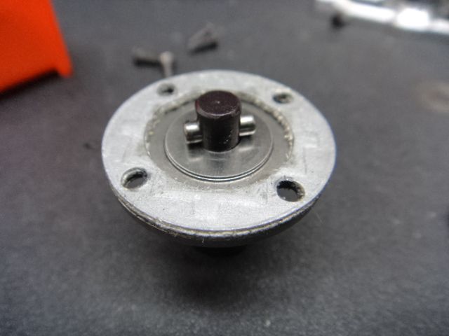

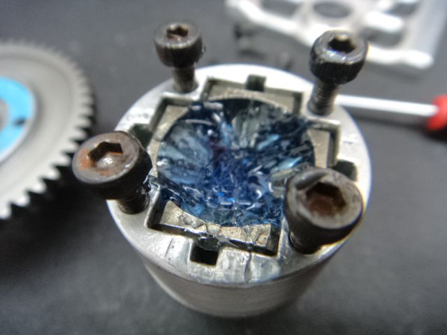

Just finished the final install adding some more shims inside the diff:
Added the 1000000 weight oil to the diff. Used some old bolts to stop any oil getting into the threads while literally scooping up the oil like honey pushing it into the diff:

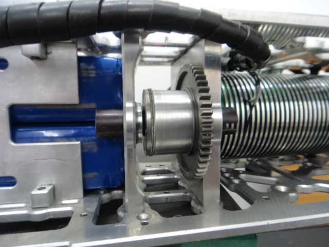

Everything sitting nice in position without any binding:
There was a lot of work involved getting it all setup so I hope this sorts out the issues I was having. Will give it a run later and grab some footage just have to wait for the thread lock to dry.
