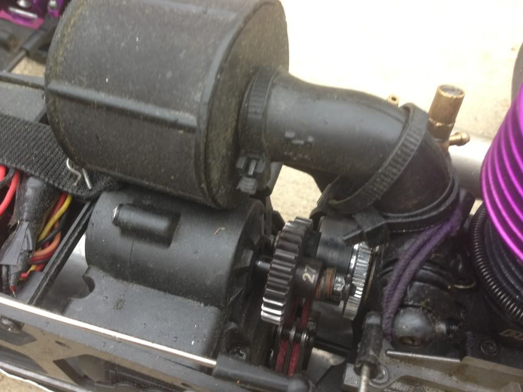

The drive gear and idler are not affected by the top of the tranny. If there was an issue it would be where the bearings sit in those slots. Maybe there could be something causing one side to sit higher. But since I have a flux, I've had this same thing happen and it was from the torque of the motor. At these speeds and the gearing involved its a massive amount of load on those two gears. Thank you for the input and ill have a look when I get home, you just never know I could have over looked something.

The top of the transmission is what holds the drive gears mesh with the idler gear, it has a huge effect on the mesh. Unfortunately it is not as ridgid as the original transmission housings. If I have the same issues, which I suspect I will, I will trade transmission housings out once I have my shift points adjusted.

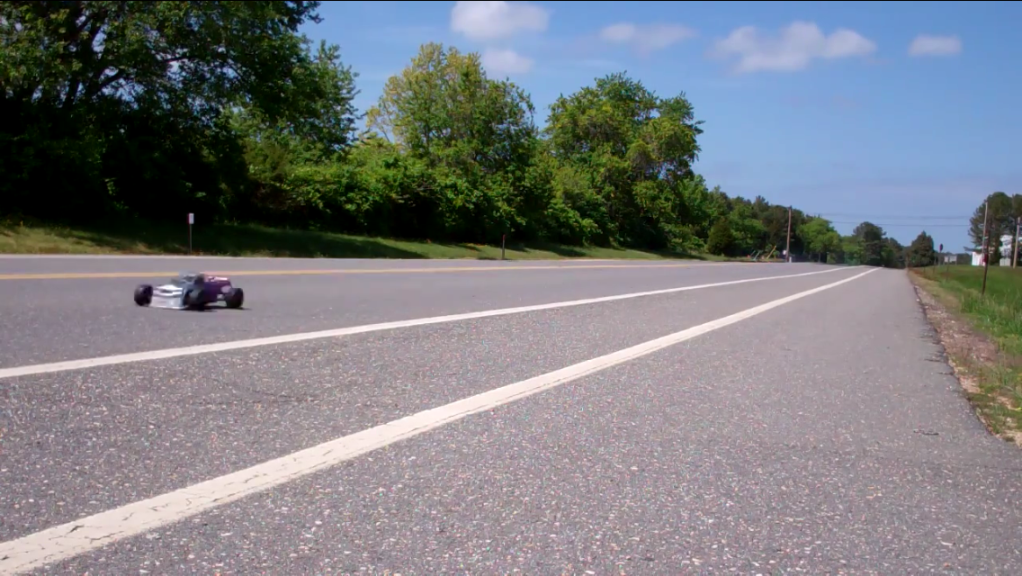

Heres some pics of the truck at 74mph, kinda cool

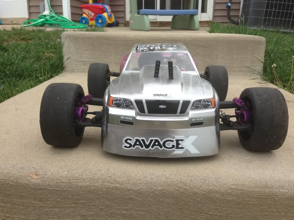

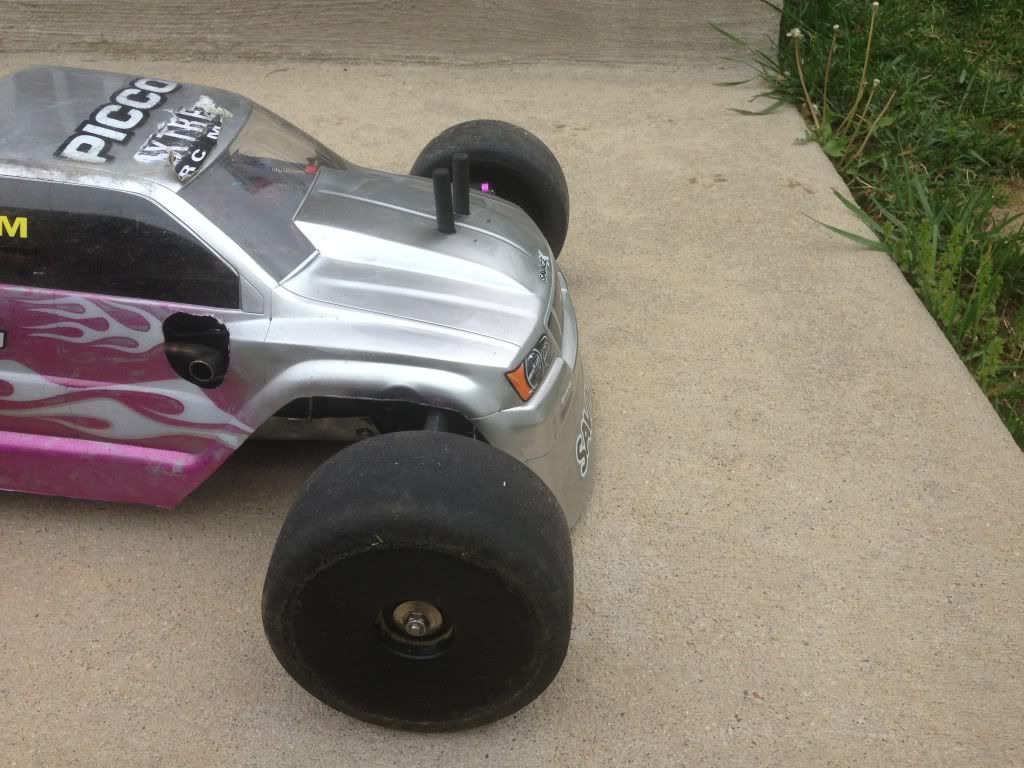

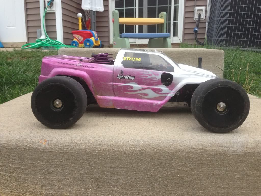

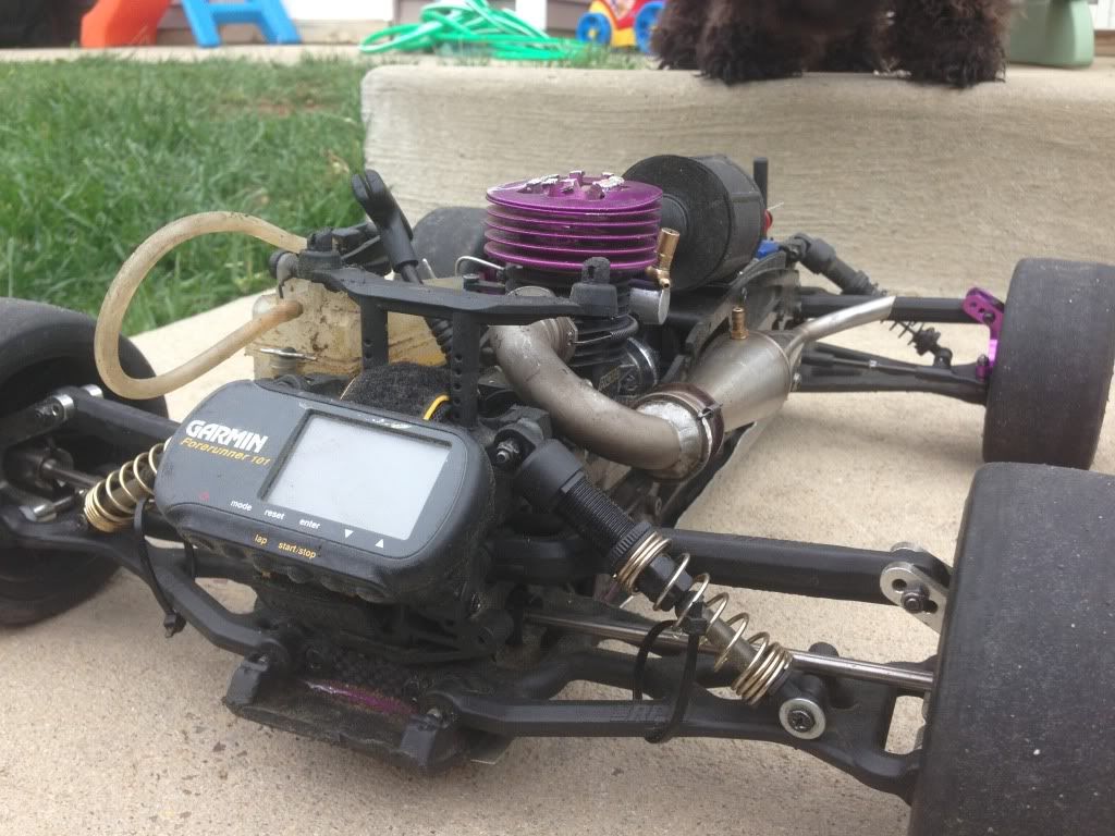

Now I had to make some changes to the body on the road because the truck after a few crashes lol would lift off the ground around the same spot on the road. So I cut the front wing off the body. It helped resolve my issue. Further more I have issues with the header, when i flip the truck and it goes buck wild to who knows where at speeds above 70 the header is impacted by the body. What happens is the header and pipe flex causing the seal to leak and *censored* me off lol. Anyhoo Ive been meaning to reangle the header so this problem is eliminated. The dynamite header is actually meant for the other side of the vehicle but that doesnt mean it doesnt work on the other side, obviously lol. I drilled some holes and now the header fits like it should, thus putting the pipe down lower further lowering the center of gravity :D Plus this should fix my problem of the body hitting the header.

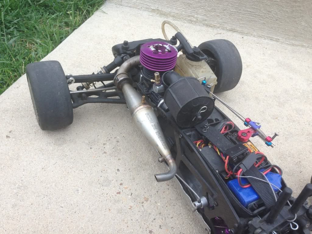

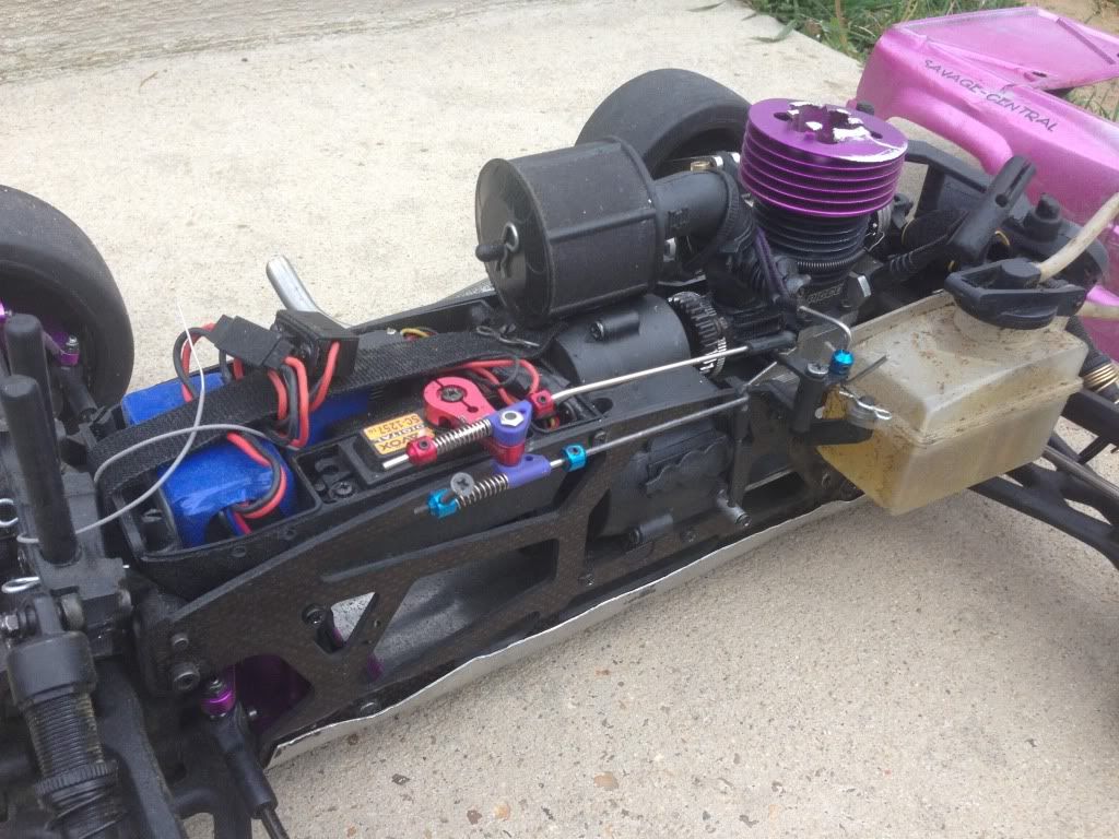

Heres a pic of my linkage its nice and special lol
Hey you want to mill down your cooling head, just go 70 mph and flip the truck on its lid lol
Just in case anyone wants to see what gearing im running at 74.9mph

The Scalpel speed-run body I got for my Slash 4x4 has a matching foam bumper that fits snug against the inside of the front lip. I gather during testing of the body, they noticed that upward of 70 or so, the front lip was caving in, so they added the foam bumper to support it. Otherwise the lexan folds back under and actually forces air under the truck.
I think your body might be stronger, just because it's narrower, but it might be worth looking into. Any sort of hard foam can be cut easily, and all you need to mount it is a flat plate held in place by the skid-plate screws, sticking out the front far enough to have another screw up through the foam to a small plate on top.
Post by LLkoolskillet » Tue Jul 02, 2013 9:40 pm
Interesting... I did notice that when I ran with the uncut lip it would drag on the street once it got to speeds around 70. I cut it off and I went faster lol. If I could come up with a plate setup like the X0-1 that locks the body in place on all sides that would prevent flex and flapping in the wind ultimately slowing the truck down.
