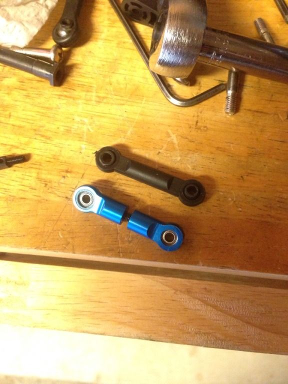

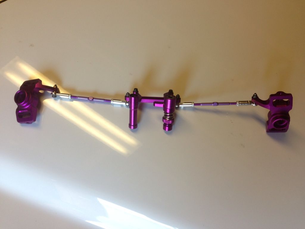

Today I recieved a complete set of hot racing alloy rod ends, hpi TI turnbuckles, and some smaller M3 alloy rod ends and turn buckles so I can eliminate the slop from the servo to the bell crank. I just need to bolt it all together and reset the steering and we should be go to go for some more runs. Oh and setup the new radio :) shootin for this weekend!
Post by LLkoolskillet » Thu Apr 18, 2013 5:23 pm
Hopefully all this helps! I was already running the GH bellcrank but just added the GH hubs, alloy ends and TI shafts.
This link was my root problem, hopefully the alloy ends fix it

Ooooooh!!! PRETTY!!! *drools*

Well after a long day messin with the slop ive managed to isolate it and ordered new hubs. I even tried putting alloy hubs and knuckles on but nothing worked. I also have to replace the SS adj upper a arms as the ball ends are worn and as you know those are some strong rod ends. The bell crank and turnbuckles are nice and tight, but the wheel cups need to be shimmed. So I need to find some 8mm x 0.2mm shims so I can put them behind the hex's. Even with new bearings theres slop.
All this trouble shooting can be summed up as two words.... Preventative Maintenance!!! I didnt dot it for so long and now its come to haunt me

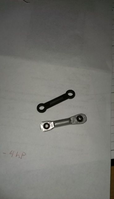

your steering linkage arm is pretty,  mine was done a bit more primitive. although we did get the ball in there and eliminate some slack

Post by LLkoolskillet » Sat Apr 27, 2013 7:39 am
Is that some round stock or tubing? It's an interesting idea for sure.

Post by realsickclown » Sat Apr 27, 2013 8:20 am
.125 round stock aluminum and a press

realsickclown
Posts: 701
Joined: Sun Jan 13, 2013 12:00 am
Location: N.Kansas City,Mo.
Post by realsickclown » Sat Apr 27, 2013 8:22 am
sorry .250 round stock I believe it was called a swedge joint we used to retain the plastic ball joint I'm thinking about getting some metal ball joints and try to make a better version now that I know I can do it.

Post by LLkoolskillet » Sat Apr 27, 2013 9:28 am
That should make for a strong rod end, I have some ball swedges at work, now you have me intreged lol. Free mods are often the best
