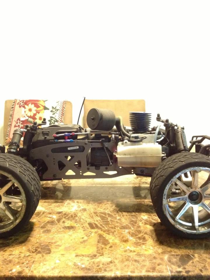

Post by LLkoolskillet » Wed Aug 29, 2012 4:10 pm
60 mph is the theme/ but the goal with this build is 65+mph. As most know Ive pretty much maxed out the XL chassis and I think Ive exhausted my motor, I still have a few tricks up my sleeve to push that last 0.8mph I need. Anyways I plan I getting another motor from Robin, This one will be a little more geared for a record run.
For this build I will utilize the same front and rear diffs on the current record breaking truck. The CEN/Hellfire 26/9t diffs. Basically I took the CEN ring gear and fit it to the Hellfire diff cup with 20/10t bevel gears. The 26/9t gearing has been proven to change the gearing like adding two teeth to the CB,

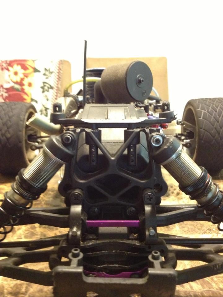

Post by LLkoolskillet » Thu Aug 30, 2012 11:08 am
Your correct and I am using shorter shocks, up front I have Losi D8T shocks with red hellfire springs on them and in the rear I'm using Hellfire big bore shocks with yellow rate springs. Yes I know red is stiffer but I mangled one red up in a crash lol. So I preloaded the crap out of the shocks and there so stiff that the rear end does not sag under load
I want the platinum RC lcg shock towers but don't feel like waiting months for them. I can make my own but that's a long process right now. In fact I could make the whole truck out of carbon fiber but people at work would get suspicious haha

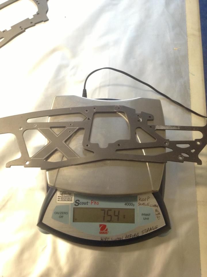

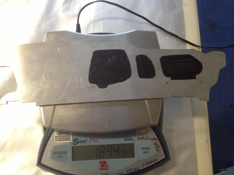

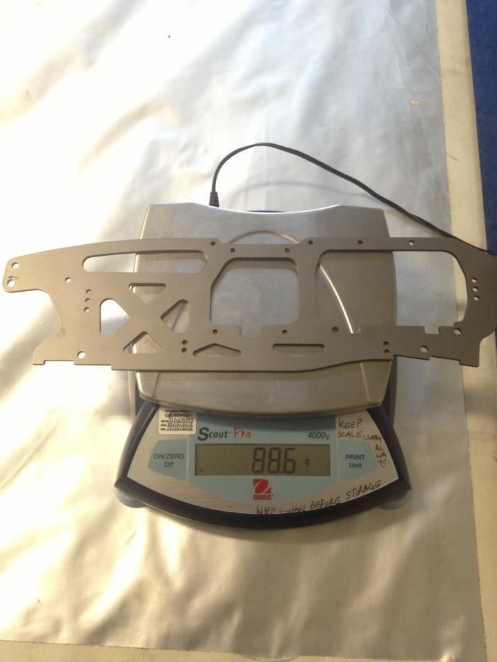

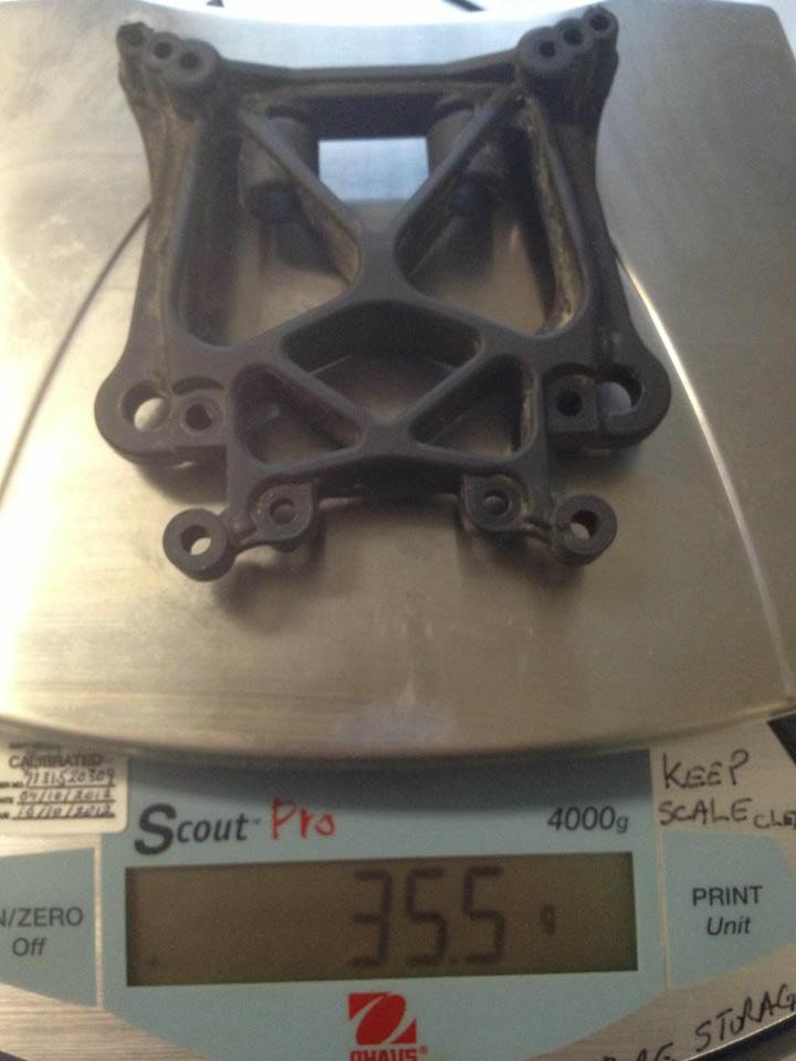

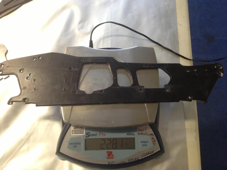

Post by LLkoolskillet » Mon Oct 15, 2012 3:37 pm
Today I decided to weigh my TVPs, both stock and custom. I was shocked when I saw the weight of my Blackout TVPs 8O even the new ones im making are hefty.
So in order to save weight I need to figure out how much things weight and where I can shave the weight. An all carbon fiber build would would ideal but its not going to take a 60mph curb hit. I would really like to make some carbon fiber LCG shock towers but I have a feeling there going to weigh around the same as the stock towers. Anyways heres some numbers
Now I figure that the weight on my other Blackout TVPs is around 240g cause I have less material cut out. So im guessing they weight a wopping 468g. Thats over 1 pound in weight! When I converted to the stock flux chassis I saved 0.6lbs of weight. Thats alot for these trucks. What also shocked me was that the alloy shock towers, when you hold them in your hand they dont weigh that much. But there double the weight of the stock ones.
When it comes to TVPs, I want strength and light weight. Well alloy is going to be the choice for me. The Platinum EXT LCG TVPs weigh 160g(0.35) and my flux chassis 180g(0.39lb) Thats not a huge difference at all and not worth the time and headaches from ordering from Platinum.

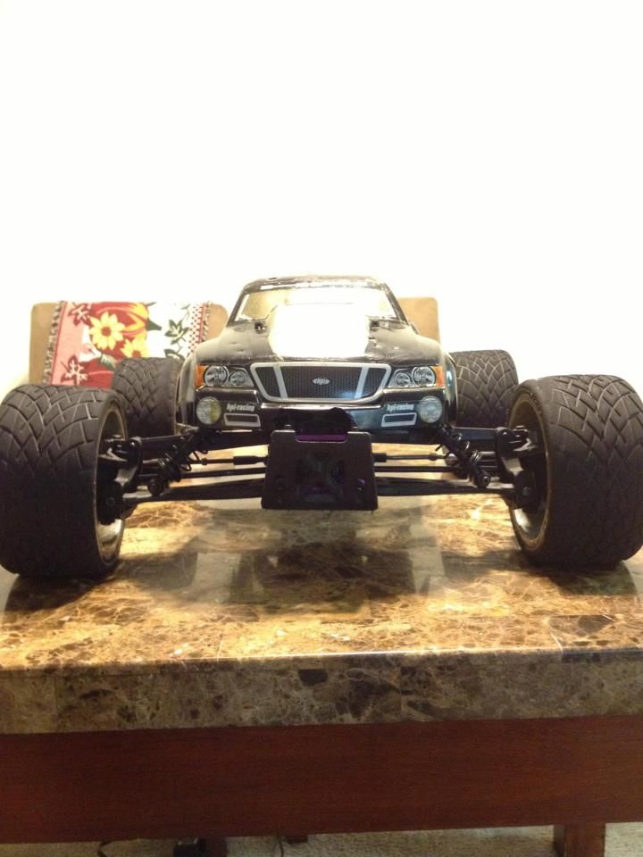

At that speed, I would also try to make the bodyshell aerodynamic. Except for making the car light. Air resistance is getting serious when you run that fast.
Post by LLkoolskillet » Mon Oct 15, 2012 9:45 pm
The issue I face with running the body on is the motor gets hot cause there is no air flow to cool it. I'm thinking of something to cover the front of the truck but not raise up above the motor. Basically allowing the motor to be the tallest part other than the roll bar. There will be some trial and error but I'm open to all sorts of body ideas.

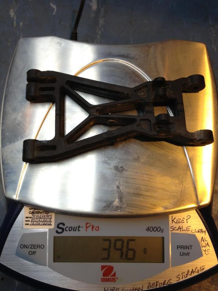

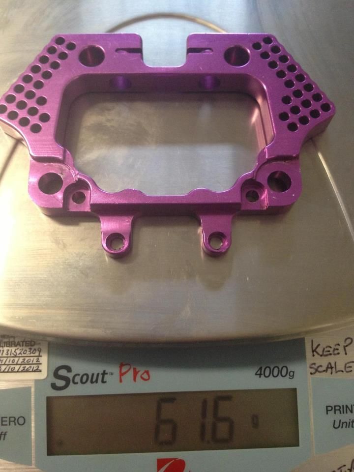

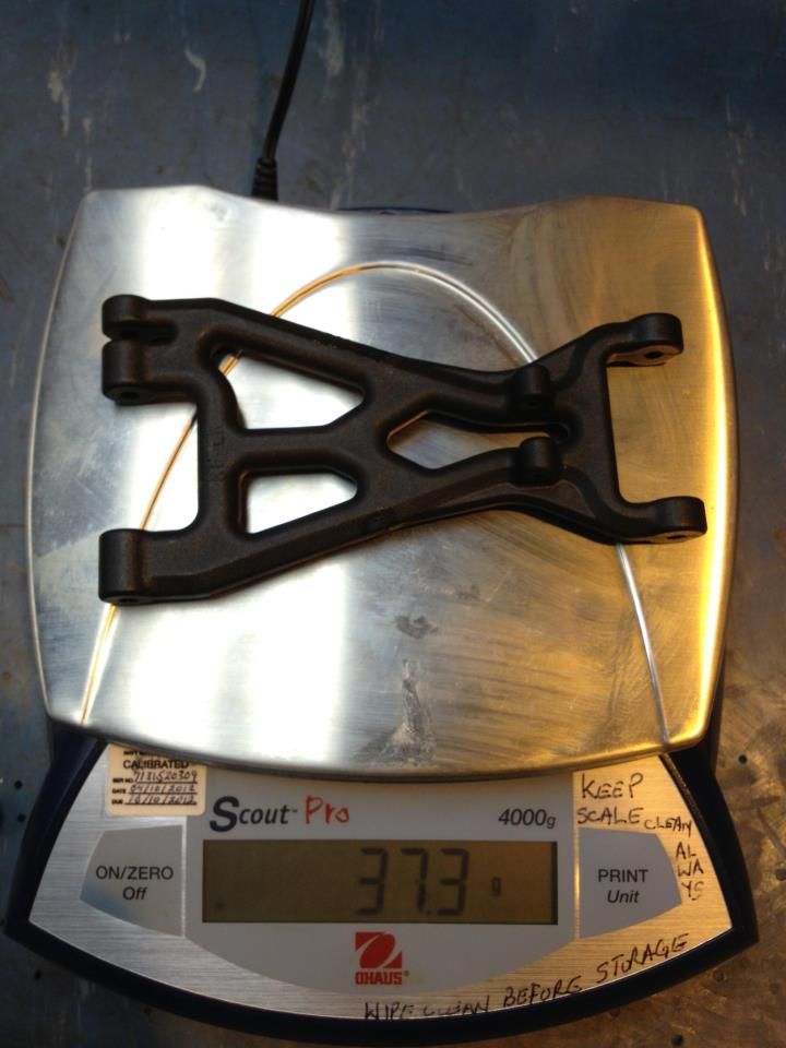

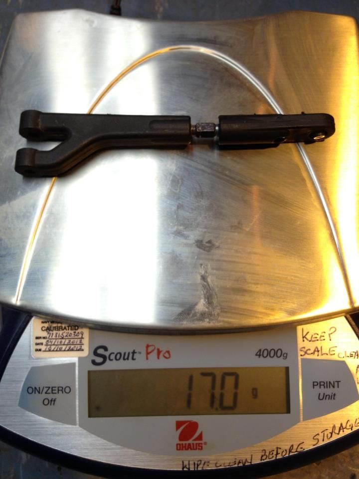

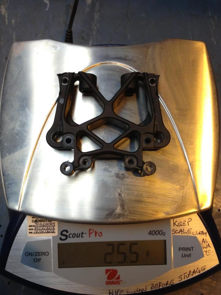

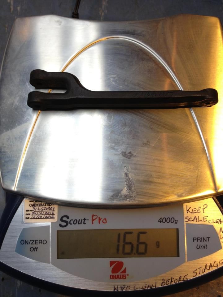

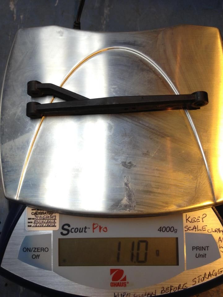

Once again I decided to weigh some more things in order to see where I can save the most weight. I was quite surprised with some of the results. Im sure some of you will also be surprised.
ERCM Endbleed with shortened Dynamite header
Stock Battery box
RPM A Arm
Stock Savage X A Arm
Stock upper A arm
S/S adj A arm
RPM 0deg A arm
RPM -2deg A arm

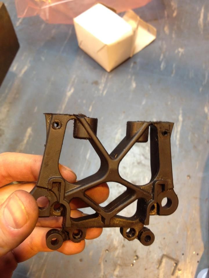

Homemade LCG shock tower
I saved a total of 20g here by cutting the tops off the shock towers. Its not much but it does add up in the end.
Post by LLkoolskillet » Fri Oct 19, 2012 4:37 pm
With the way I had it setup verse how its set up now, Ive saved 78.8g which is 0.17lbs. Its not much but it will help. Im now running the RPM lower a arms with stock upper arm. Next I need to figure out how to eliminate the batt box without adding much weight with a replacement idea.
Post by bigbigbrig » Fri Oct 19, 2012 5:36 pm
I'm glad to see that someone other than me has reworked the stock flux chassis plates to work on a nitro. What did you do about the rear drive cup hitting the engine plate? Also what engine plate are you using? As for the battery box. Could you use double sided tape to lock everything down and then lose the lid? That should save some weight.
Post by LLkoolskillet » Fri Oct 19, 2012 6:48 pm
Haha yes the flux TVPs were a little interesting to fab together to say the least. But I made them work. Not as clean as yours but they work. I'm using the savage XL motor plate that's been powder coated so it actually thicker than stock lol. As for the nightmare of the rear diff cup. I used the dremel to file away a groove into the plate. You can't use the rear motor plate brace cause it hits the dogbone but that's ok I used the FLM skid plate mounts to mount the rear. I had to make new mount locations for the rear but all in all it works and works well  :twisted:
My next option to save weight is taking the XL drive line out and put the X in. But I'll have to install the AE ext buggy style hexs on in order to keep my wide stance. Plus I want to take the XL motor plate out and drop in the lighter X plate. I'm hoping that with all these changes I can save about a half a pound. My goal is to get the truck into the 10lb range.
As for the batt box I do plan to either mount everything up FLM style or cut the crap out of the batt box. I have an idea in my head on how to trim weight off the batt box but Idk yet.  Basically the batt box is the last area I can save weight everything else has been changed.
