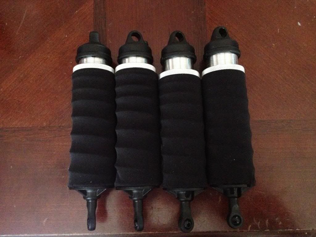

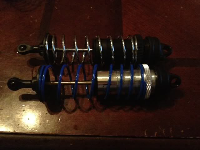

Curl it under the retainer to the inner part of the spring top and bottom.
Uberbricky

Post by Uberbricky » Sat Feb 09, 2013 11:12 pm
Thats it huh.  I did that too but just thought it was too simple lol.  I saw a fella on youtube do the zip tie trick but he was using tire tubes.  Shame to cover up the nice shock bodies, but gonna have to keep the dirt out some how!

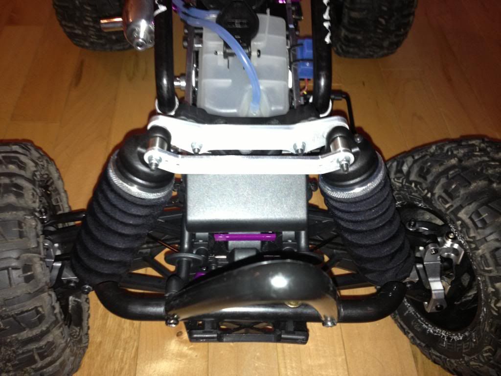

Post by mrgrouchyguy » Sat Feb 09, 2013 11:25 pm
when you slide the cover over you should have excess material on both end, fold the rest inwards use the shock retainer on the bottom of the shock to hold it in place, just like this one.
i like it because it looks cleaner.
Post by nitronly » Sun Feb 10, 2013 12:50 pm
Never thought of that. I always used zip ties. I always put them on the assembled shock.

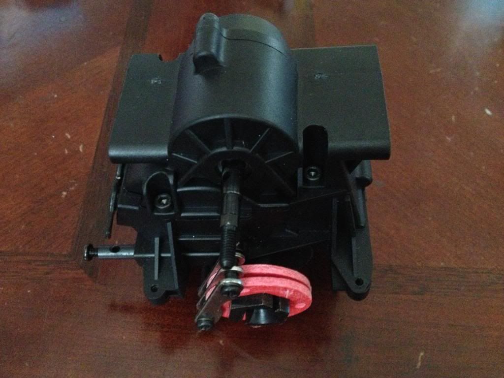

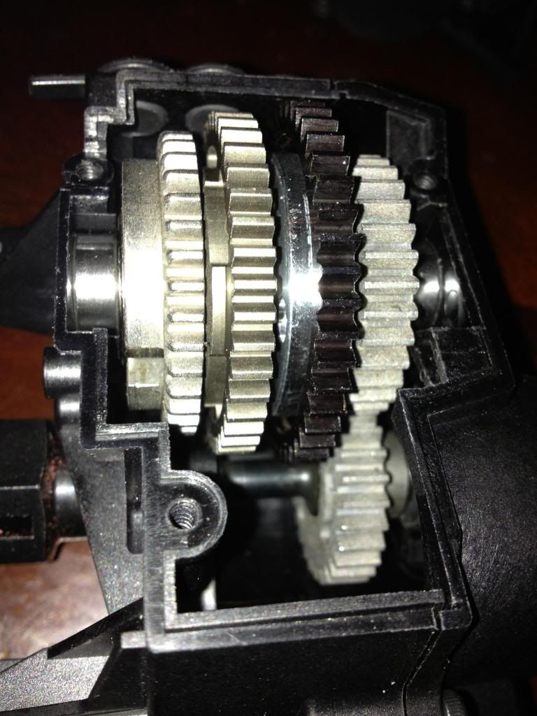

Post by Uberbricky » Sat Feb 16, 2013 11:53 am

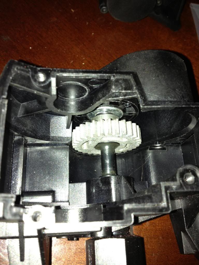

Still waiting for the shock mounting kit so I did the tried and true all metal BP tranny, with the Acers and hex hardware.  When shimmed it sure feels a lot better, spins freely but has a tighter feel.
Just going to keep this one as a spare until I blow up the stock one.  Blowing things up is fun!
Also have the LST shocks ready to go with aluminum bodies, TiN coated rods, dual rate springs and socks to cover all the prettiness up

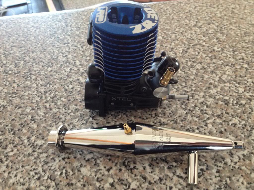

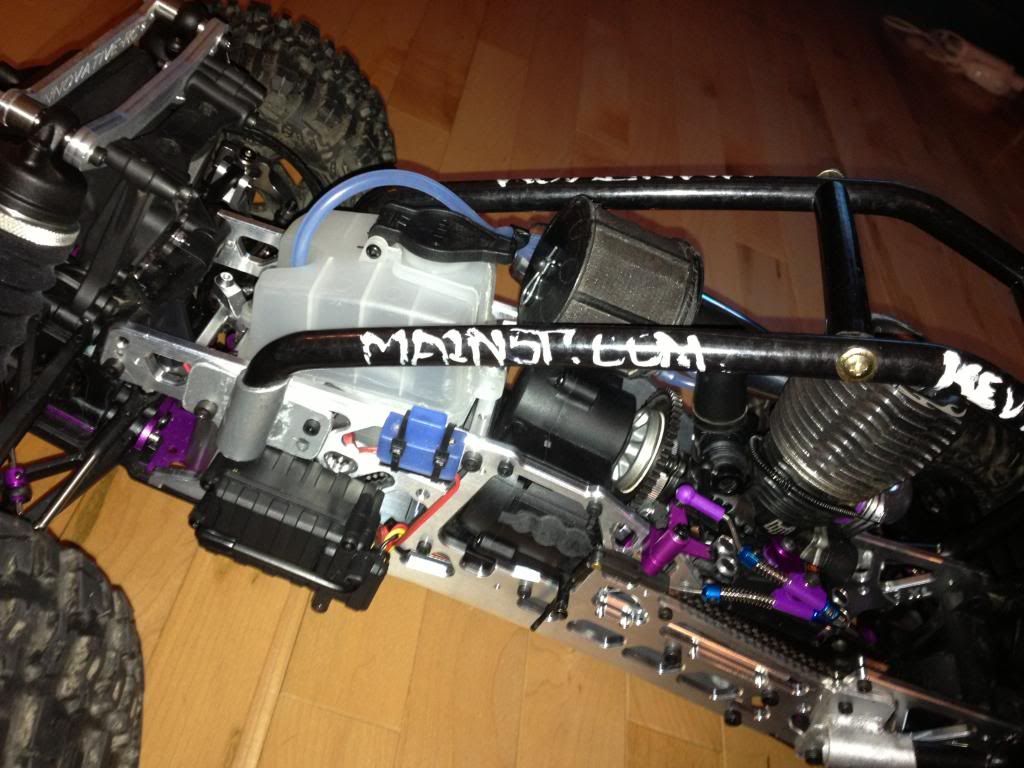

Post by Uberbricky » Thu Feb 21, 2013 5:22 pm
Look what came today!!!
This is my Savage.  There are many like it, but this one is mine.
Post by LLkoolskillet » Thu Feb 21, 2013 7:30 pm
Sooo shiny  :twisted:
Post by nitronly » Thu Feb 21, 2013 10:26 pm
Has that engine been modded?
Uberbricky
Posts: 135
Joined: Sun Jan 06, 2013 12:00 am
Location: Edmonton, Alberta

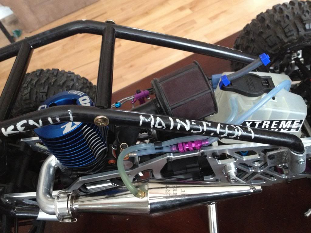

Post by Uberbricky » Thu Feb 21, 2013 10:48 pm
Is a pigs a s s pork? That's fresh from Robin

Post by Uberbricky » Fri Feb 22, 2013 1:15 pm
Sorry nitronly, I was drunk posting last night lol.
She's modded and waiting for a couple months to start the break in.  Hopefully we get some warm weather sooner than later...

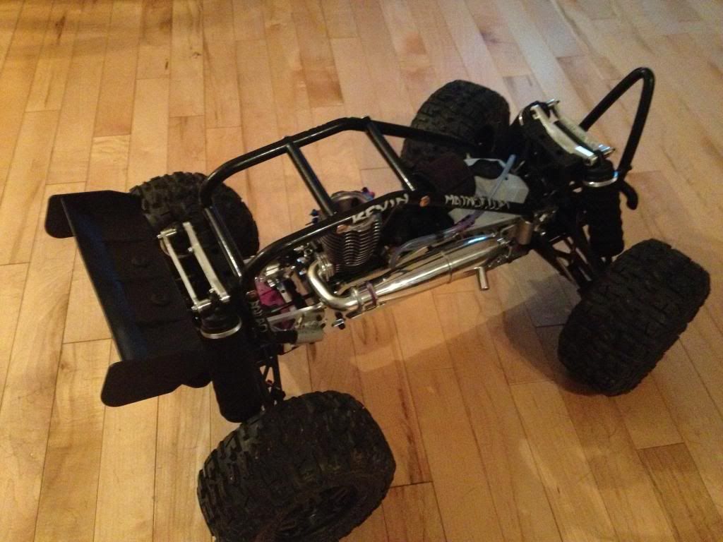

Post by Uberbricky » Sat Mar 02, 2013 6:57 pm
Well, I got a little stir crazy and installed the new engine...I just had to see how it looked....
But since it's snowing/raining out, it just gets to look pretty for now...
