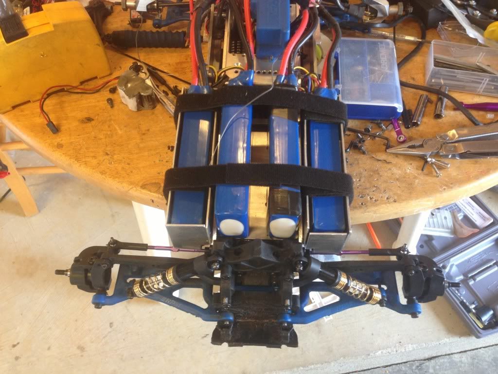

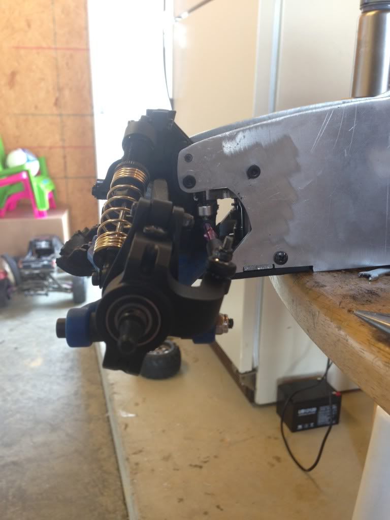

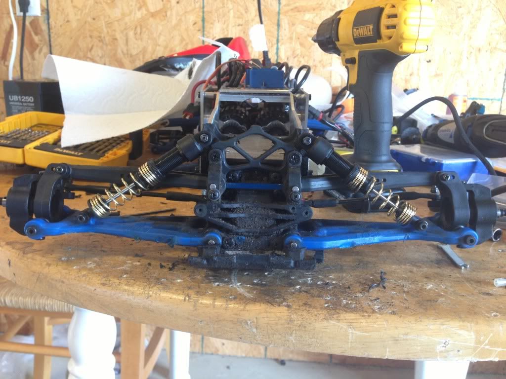

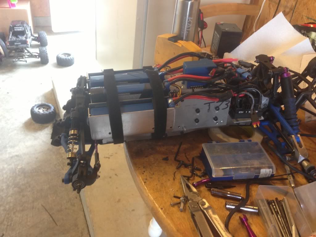

Little update on the flux part of this build.
Installed the front XS shocks with modified shock towers. I still need to fill them with 60wt oil and put fuel tubing on the outside of the shafts. The front with all the batteries just weighs to much for them right now. Also cleaned up the back end with all the wires. I may be trimming the rear tower a little bit so there isnt as much rake on the body. I do intend on keeping the rear shocks big bores. This truck is about 85% finished, just need to shim the wheels, program the ESCs, fine tune shocks, and cut and paint the new body. As for the body I have another new clear savage GT2 body that ill be using. I stole the last one to fit my nitro truck lol

Post by LeroyX » Sat Jun 08, 2013 6:11 pm
Holy those xs shocks have their work cut out for them! How does that thing weight with all the batts?
[hr][i][b]Savage XL[/b] Clocked Picco Boost 28, ERCM end bleed, Bullet Proof 3spd with high spd 3rd, Hellfire 150 tank, OFNA throttle mod, Big Bores and lots of other stuff my wife doesnt know about...
[b]Savage XS[/b]- rolling on 2.8 Traxxas Talons[/i]
Post by LLkoolskillet » Sat Jun 08, 2013 8:18 pm
16.5lbs!

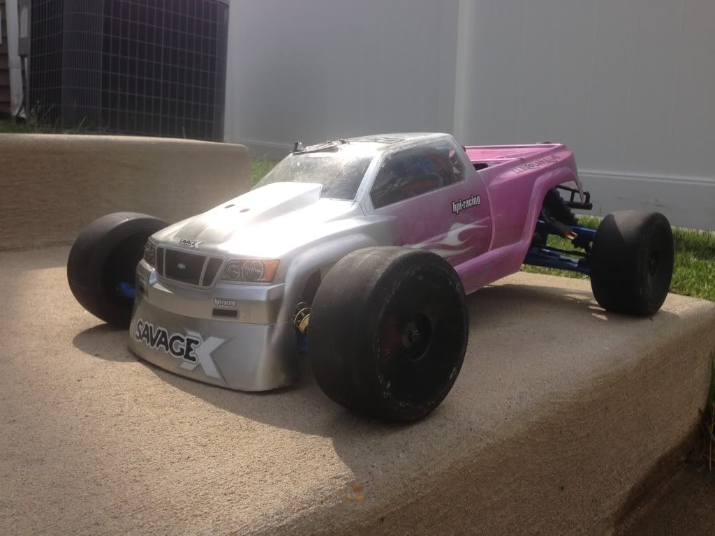

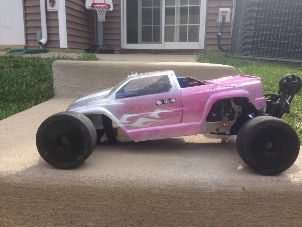

Post by LLkoolskillet » Sun Jun 09, 2013 3:44 pm
Trimmed the new body for the truck, I also setup up the rear shocks. I'm using 3 rubber stops inside the shocks filled with 60wt, red rate hellfire springs and one med preload. Nice and stiff but man this truck actually makes this setup flex lol. Overall I'm getting closer to turning it on. The next step is checking batteries and setting up the rear diff.
