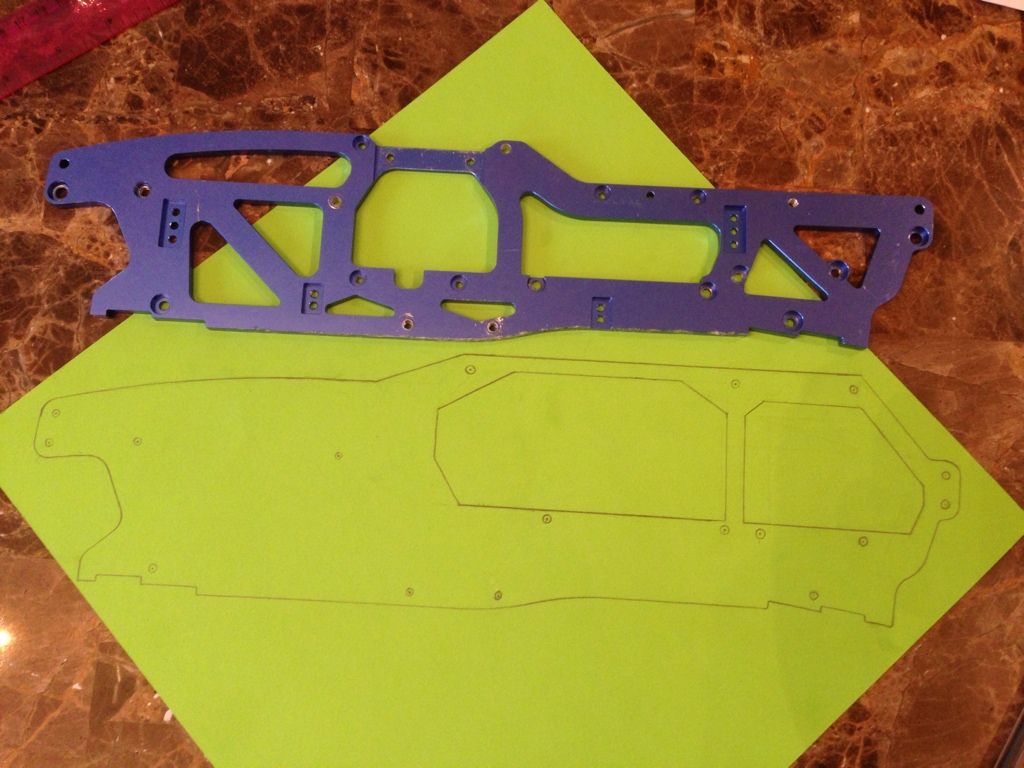

Post by LLkoolskillet » Sat Mar 02, 2013 5:02 pm
This is my TVP design for the flux, my TVP design for the nitro is just take the cf ones and cut them to allow the motors to sit in there
Post by johny723 » Sat Mar 02, 2013 6:27 pm
when making your own TVP, try adding some anti-squat to the rear. It will help put the power to the ground instead of wheelies.
Post by LLkoolskillet » Sat Mar 02, 2013 7:58 pm
You mean making the rear more level instead of angled up a bit?
Post by johny723 » Sat Mar 02, 2013 8:31 pm
yes, it will give you the rear kick-up aka the anti-squat.
Post by LLkoolskillet » Sat Mar 02, 2013 10:34 pm
Good to know, thank you
