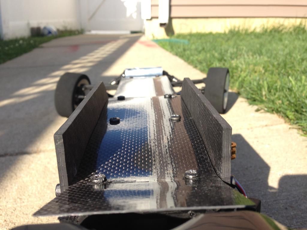

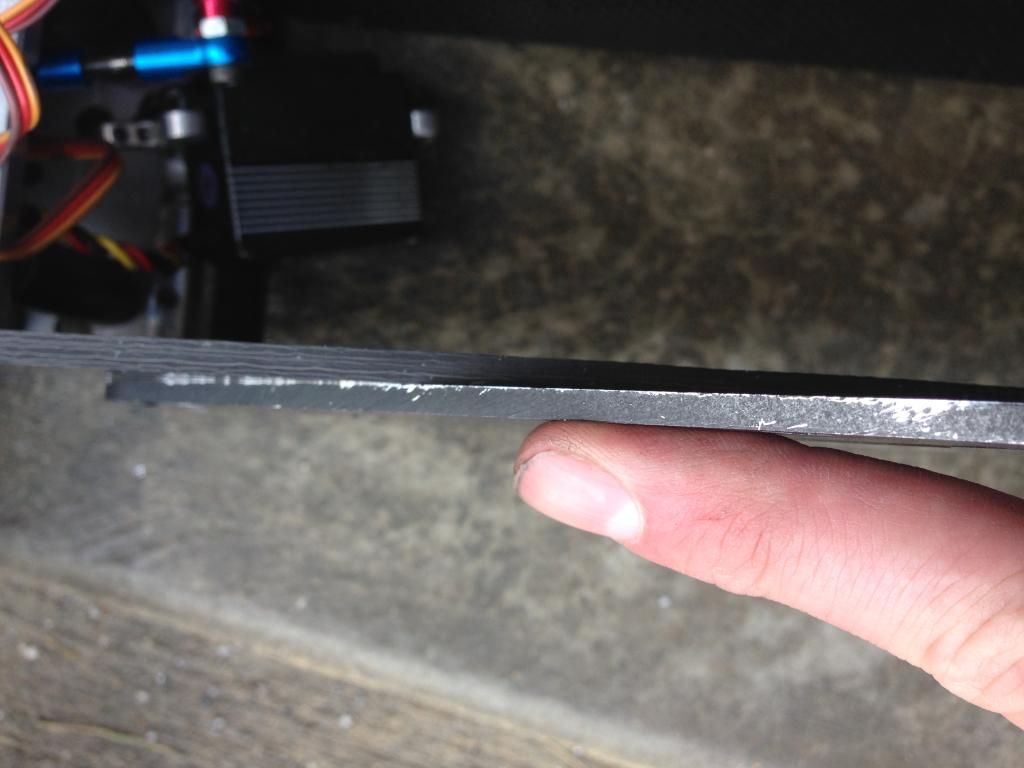

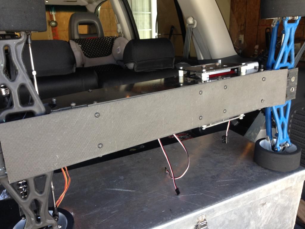

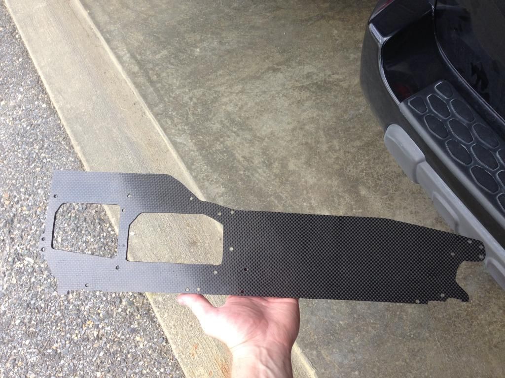

Post by LLkoolskillet » Wed May 28, 2014 7:47 pm

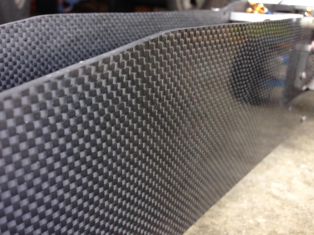

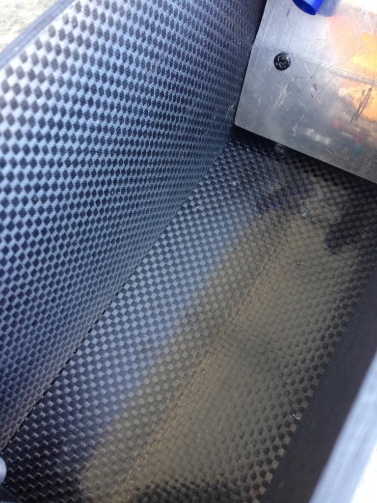

All cut out, just needs some fine tuning and a couple more holes then it's testing time :)
The new plates are thicker about an 1/8" compared to the 0.090" aluminum. There also 7/8" longer. The alloy plates were 320g each compared to the new plates at 245g. Over all it's 0.33lbs loss but I'm sure if I try I could make it a nice 0.5lb.
Post by johny723 » Thu May 29, 2014 2:32 pm
nice! But it is starting to look like a dachshund, long, narrow and small wheels :D
Post by LLkoolskillet » Thu May 29, 2014 4:06 pm
Haha I hear yeah but it's the thing we do to go REAL fast lol

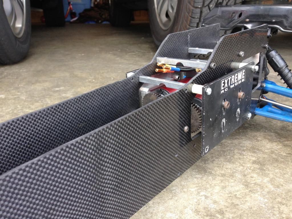

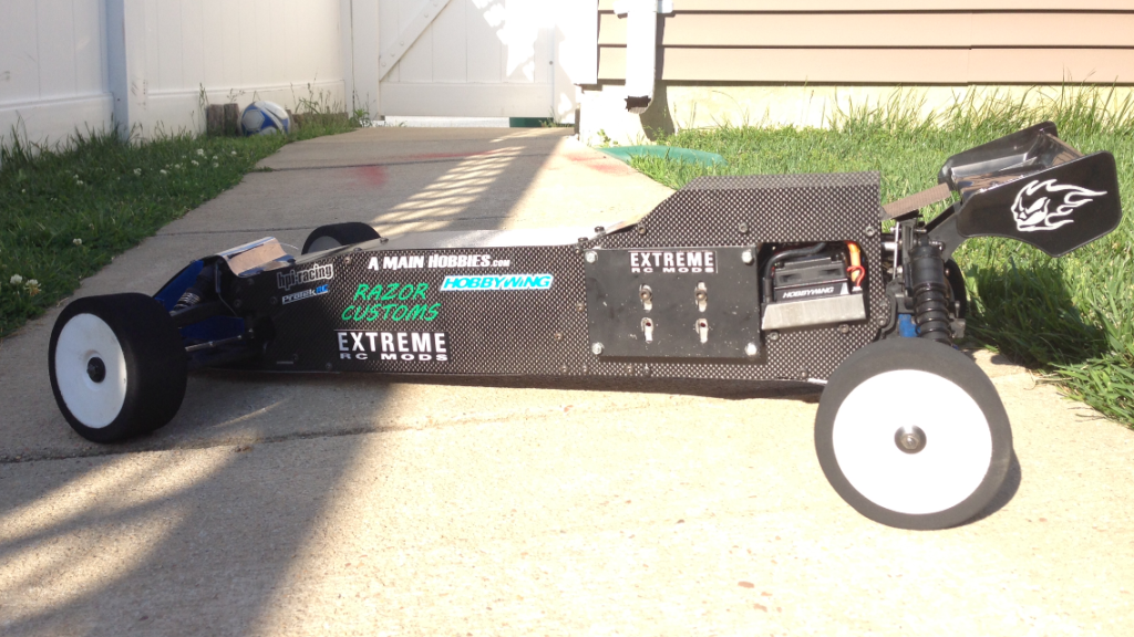

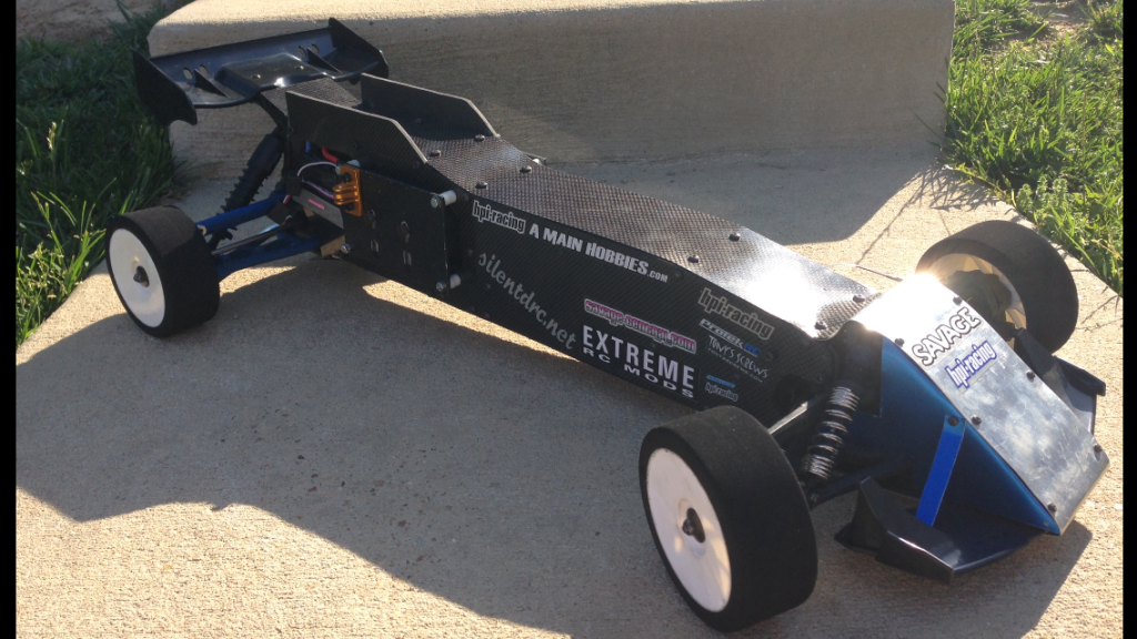

Post by LLkoolskillet » Fri May 30, 2014 6:33 pm
Sickest truck I've built  :twisted:

Post by GhostbikerNL » Sat May 31, 2014 1:58 am
That looks real sick LL can't wait for the next vid!
nice job on the cf! how much weight did you shave of?

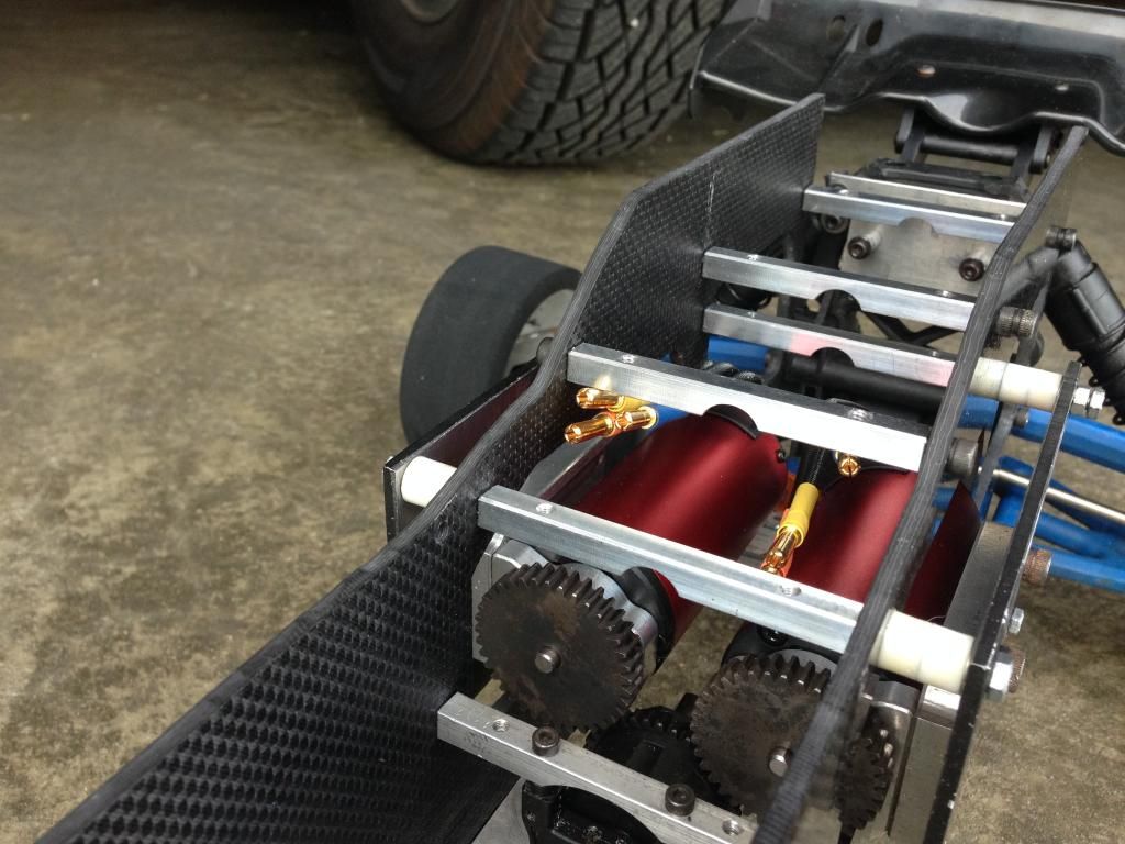

Post by LLkoolskillet » Sat May 31, 2014 10:02 am
Well so far I've only cut out 0.3lbs. The reason is these new plates are longer and thicker than the aluminum ones. Pair that with more power to the same weight which is good. The old setup was 15.3lbs my guess is this one will be about the same. But according to my calculations I've almost doubled my power, but I dont know how accurate that is lol. Anyways I've got more horsepower per pound now. 120 mph shouldn't be a problem
Post by johny723 » Sat May 31, 2014 12:30 pm
how can you double the power of 2 torks by just replacing them with 2 leopards that are only 8mm longer? You will have more power, but it will not double
Post by LLkoolskillet » Sat May 31, 2014 5:26 pm
I figure I'm running between 7-8hp through the truck which I was about 5 with the 2200's but I could be wrong. I'm not to confident with electric stuff. On 8s each the truck will have slightly over 9hp

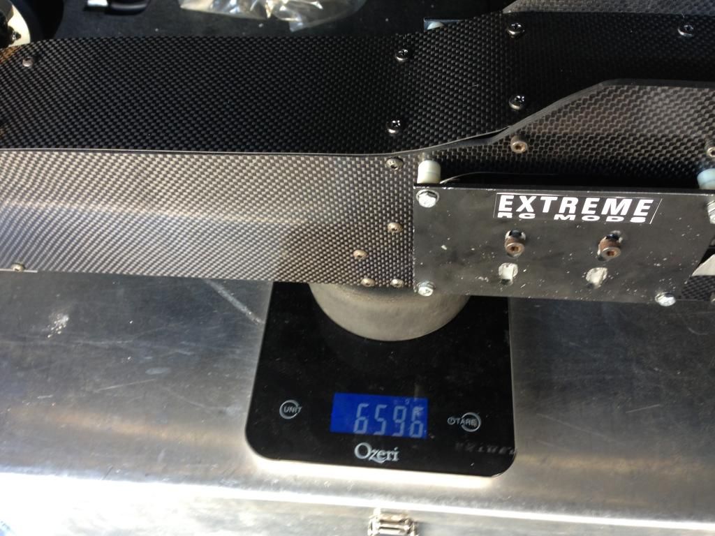

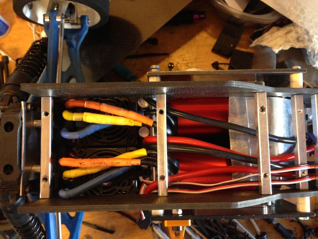

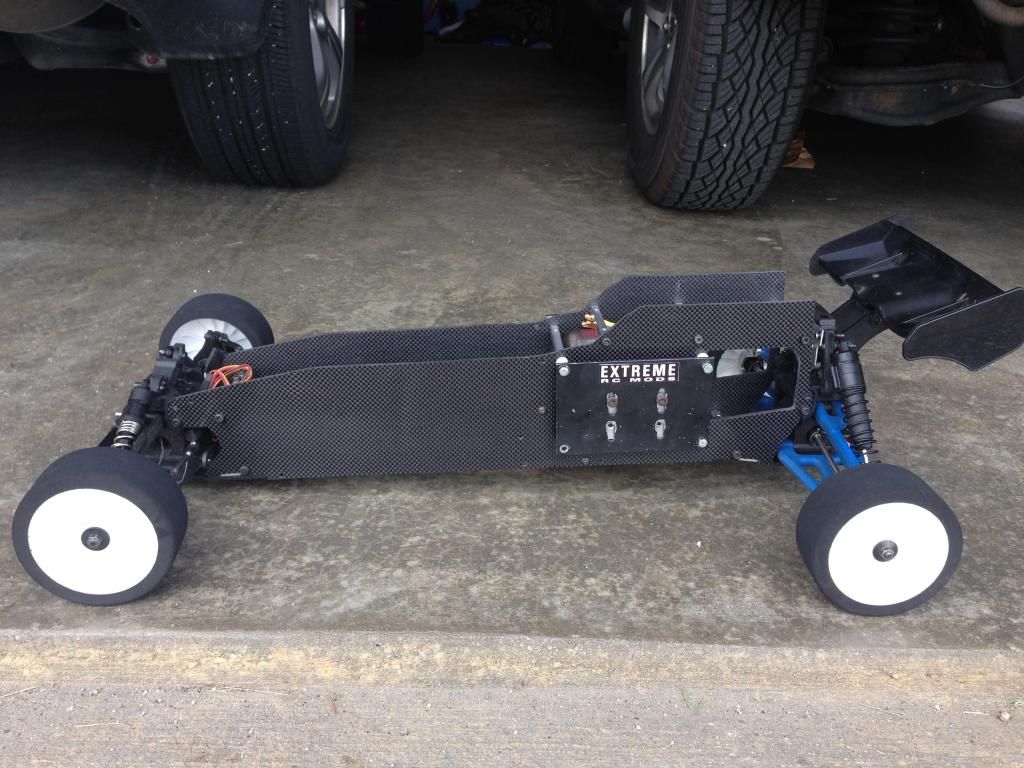

Post by LLkoolskillet » Sat May 31, 2014 6:53 pm
Shes just about ready to run, just need to setup the escs and charge the batteries
Old weight was 15.3lbs ready to run, the new weight is 14.5lbs ready to run. More power with less weight, things should be real interesting on the first pull. Kinda leary about it cause I want to go full throttle sooner but with the added torque idk lol

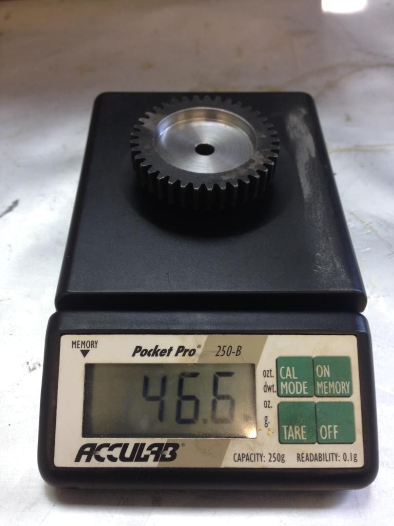

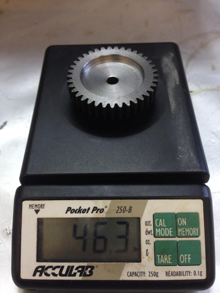

Post by LLkoolskillet » Mon Jun 02, 2014 1:45 pm

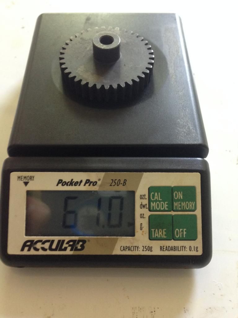

The pinions did weigh a lot so I took some material off to help lighten them up.
Before @ 61g
After @46.3g and 46.6g

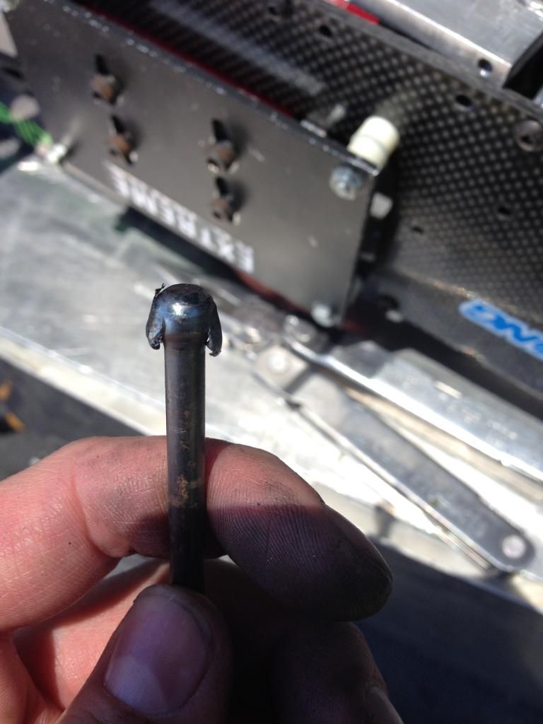

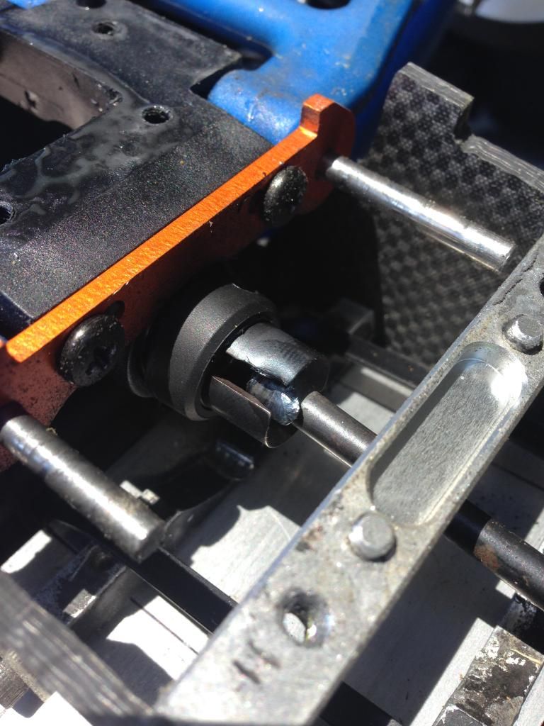

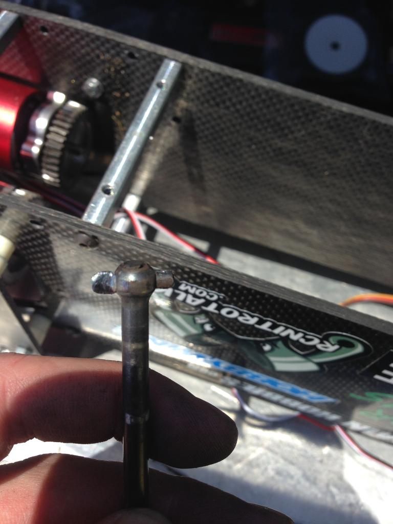

Post by LLkoolskillet » Sat Jun 07, 2014 10:02 pm
Well I think I found an issue. All this power has worn my dogbone much quicker than normal. The new 1600's didnt help either lol. Not only did it melt the pin, but the diff pinion is now wollowed out in the bulk, a new bulk by the way. So I have an FLM one coming and will be putting a new bone in lol. It was stripped on a 112mph run
Post by badboy » Sun Jun 08, 2014 12:20 am
I don't think I have ever seen that happen before.  Very impressive with the amount of torque it takes to do that.
