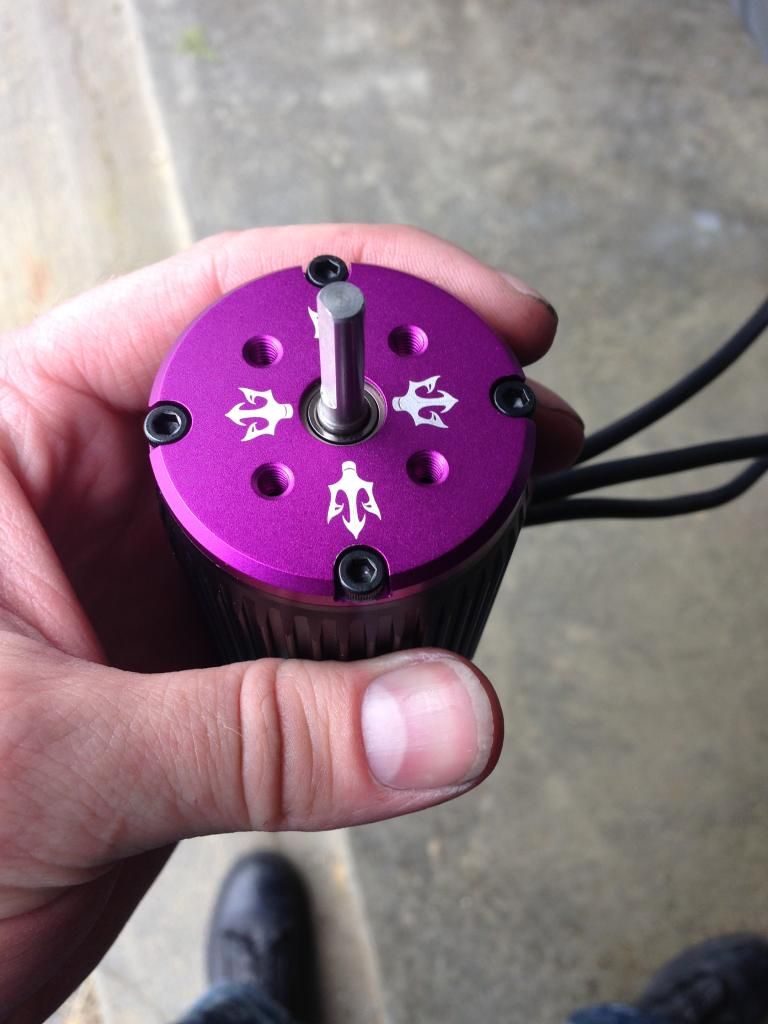

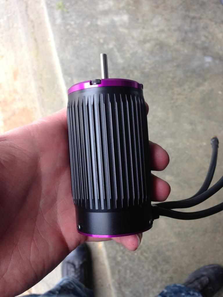

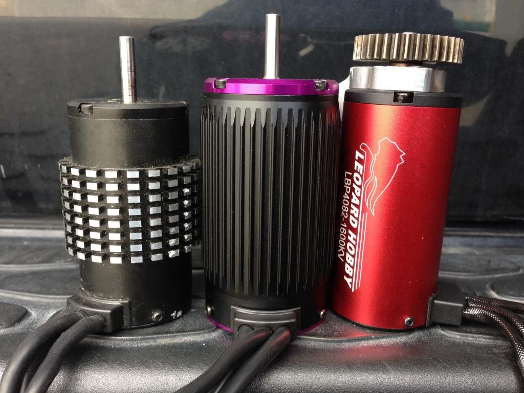

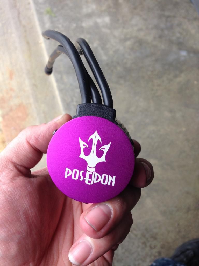

Got a few options to try now for the single motor setup. First im going to try the Leopard 1600kv with 34/35 gearing, then im going to try my new motor, Poseidon 1717-C22, its a large 2200kv motor. They just hit the market and a few guys that have tried them have gone pretty darn fast with them. Of course Ill be using my Turnigy Nanotechs and the New Turnigy A spec G2's. Pretty stoked to see what happens.

That poseidon motor looks very promising. What does it weigh? Pretty high KV value for such a big motor, but for your application it's perfect I guess. Now you got me thinking of trying one in my Castle 1717 powered Slash 4x4 LCG buggy :)
Would like to see two of them on your Savage :)
