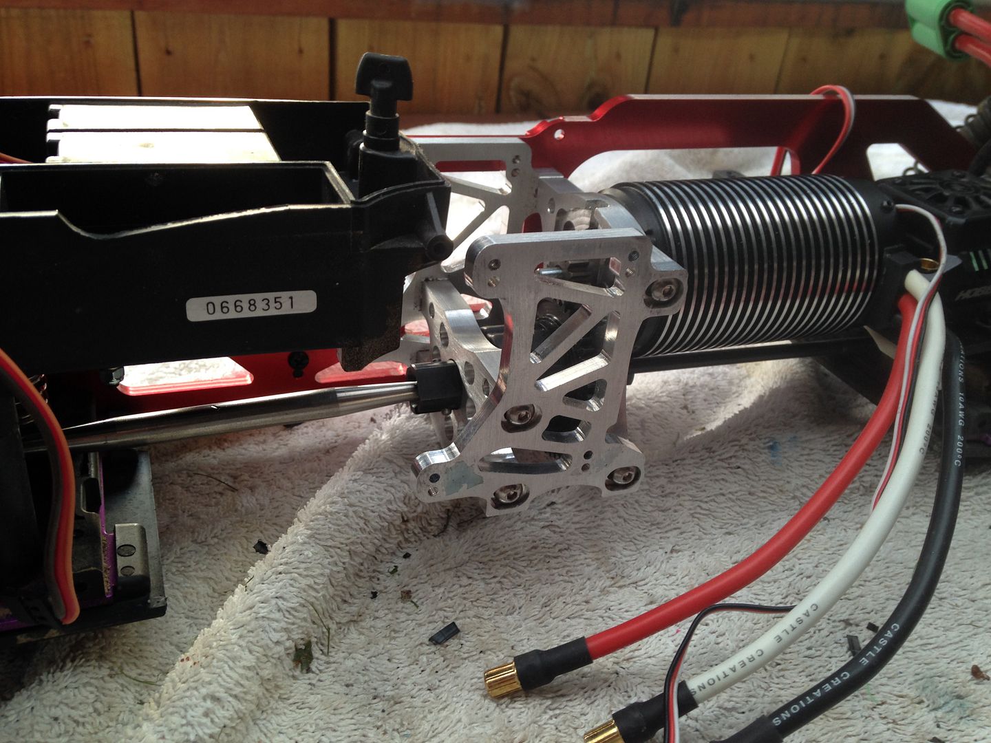

Post by painter » Sat Aug 01, 2015 12:56 am
Sitting and trying to fit the Traxxas 1717 engine in The flux. Tested in the E-Maxx today and it was very good.
The gearing are a little high, got a 13t pinjon after dremlat little on the cooling fins on the engine.
Test tomorrow if time.

Post by painter » Thu Aug 13, 2015 10:09 am
Everything went fine, Alza cd, wide axel set, HR 17mm hub.
A little movie on the test run.
