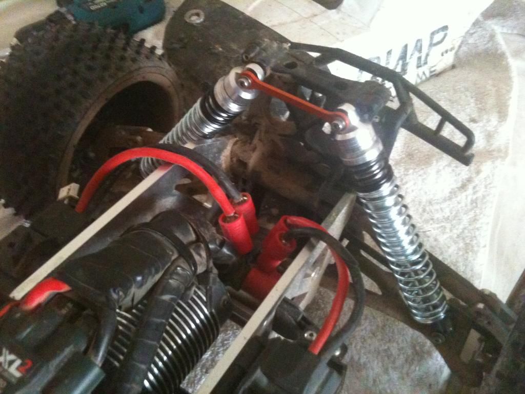

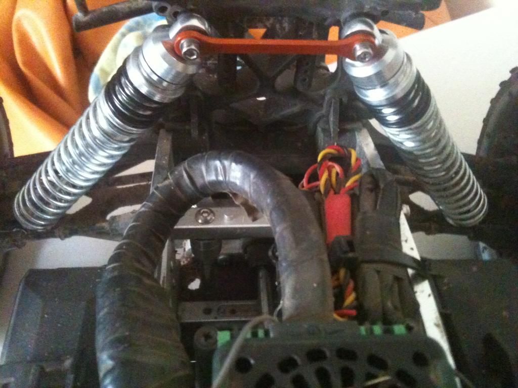

anyways... here's the result of a dawn raid on the monster bmx track at Sydney Olympic Park
OUCH!!!
so headed home wif both, steam commin' outa me ears and me tail between me legs, GRRRRR!!!!
then this happened...
taxed the front end off me baja, dismantled, shortened shock bodies by 20mm, shoved 20mm of braided tubing over the shafts so not to top out on cap, bunged it all back together and now I'm off to smack 'em up sum

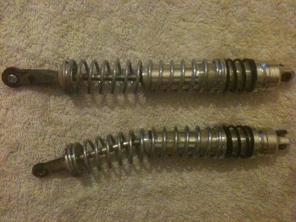

finally turned up so here's a little side by side comparison / strip down
at a glance: same length hole to hole. longer body so should hold more oil. thicker shaft
same hole to hole when compressed so same travel (note no rubber stopper on shaft)
5mm? I need some verniers. not exactly what I'd call smooth towards the lower end of the shaft
there's no clear plastic bladder thingy in the cap so guna put hpi ones in
the piston's held on by two c-clips, I'm not that fussy so as long as it don't part company with the shaft, I don't care
well, the proofs in the bashin'... will they leak like a sift?  how long will they survive?? only time will tell. will report back soon

thanks for the report! they seem like an upgrade so far. Like you I don't care much for c-clips, but all in all seems pretty decent so far.
