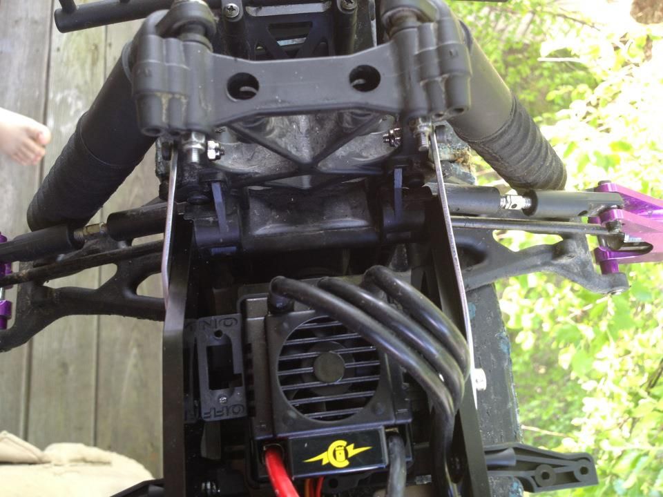

I saw one brAced with tierods. It looked I ked pretty clean. Ill have to look for that post.

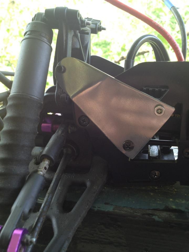

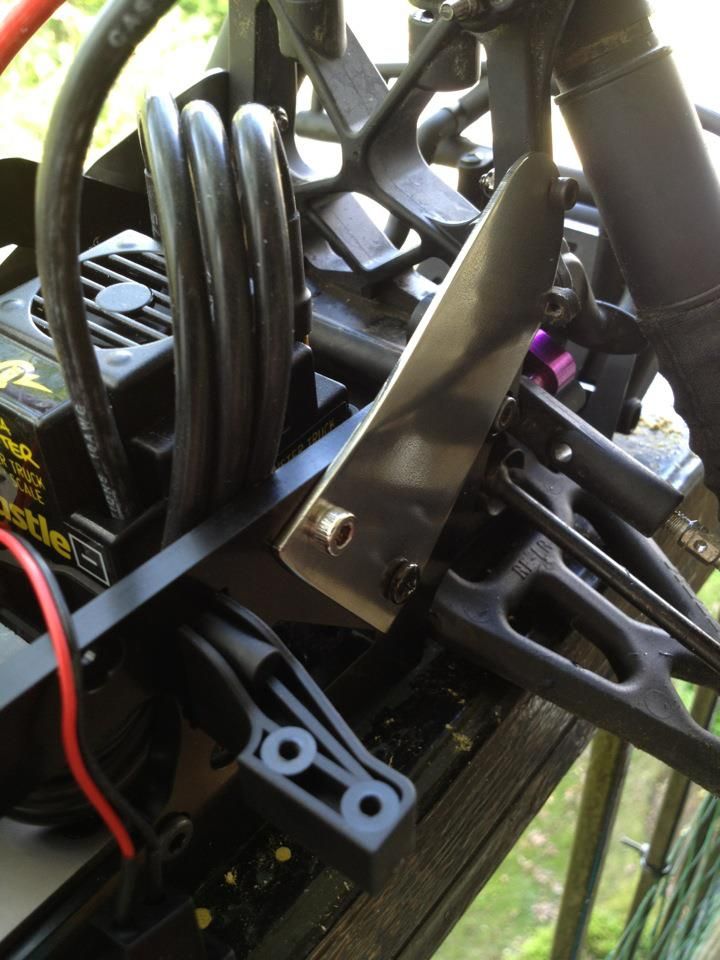

I considered a brace, but ever design I saw had a big footprint when it came to laying down or standing up the shocks (which I do quite a bit). In the end I see zero disadvantage with alum so the question is why wouldn't I?

SV250, I'm aware of the tie rod design. A+ for creativity, but once again it limits you to one position on the tower to mount your shocks. With that said, the intent is all the same. The movement of the plastic towers can cause all sorts of issues if you get rough with your savage, let alone the fact they will become deformed after a while causing one of the shocks to be a less/more progressive then the other.
I guess this is why I still don't understand the concept of "You should never get an alum tower for the Savage as they can bend!!! The plastic one is good as it flexes." To me it's like saying you should not get an alum engine plate because it can bend. Instead get a plastic one so it can flex. To each is own I guess....just throwing out my experience. This is why I was like "yeahhh" when I saw guys bracing their towers. ;-)
