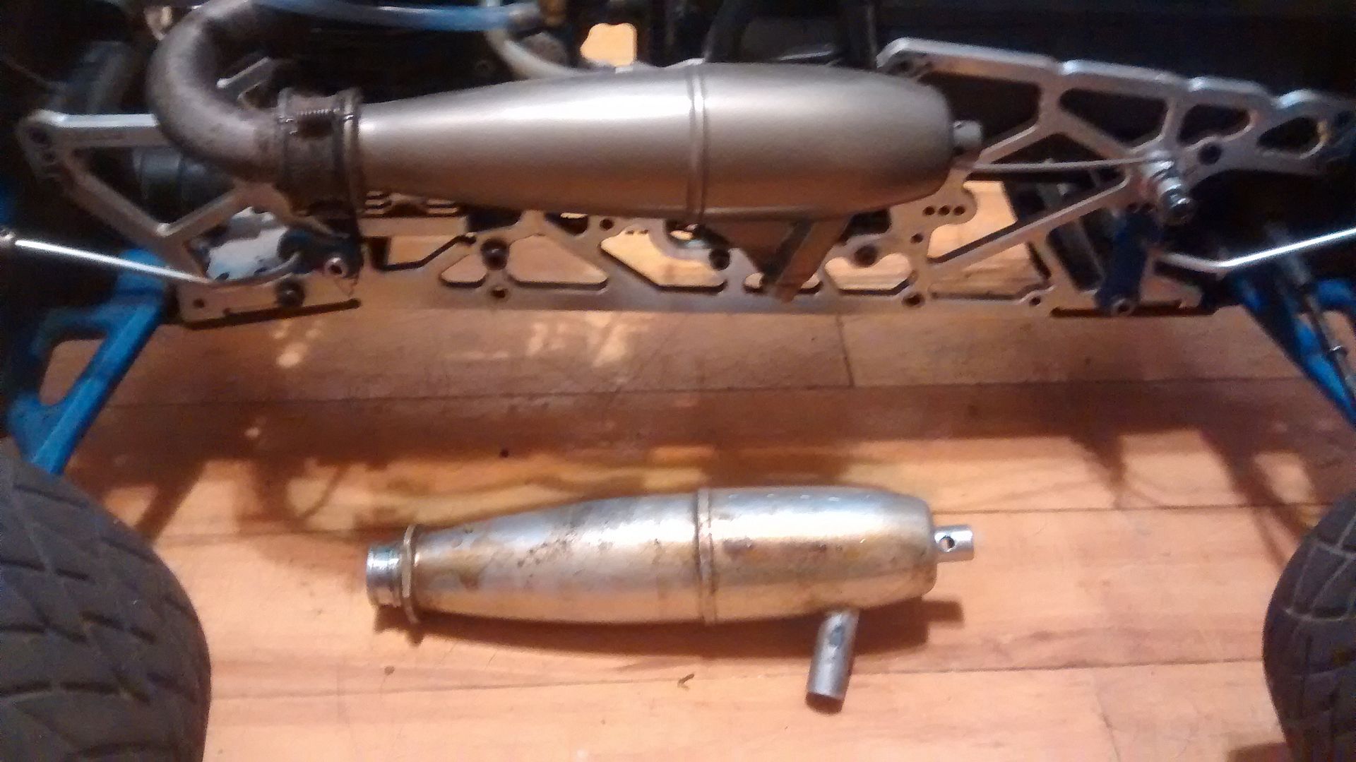

I have the Hard Anodized Dynamite 086 and Ofna 086. The HD Dynamite is bulletproof, you can clean it with sand paper its so hard, after about 3 or 4 years now mine looks new. My truck runs over 50mph with it attached to a ZR30X.

Post by SiNiST3R » Sat Oct 24, 2015 12:19 am
Pics of both the Dynamite Hard Anodized 086 and Ofna 086
This pipe is OLD, bought it used in 2011, I took the pic this evening
