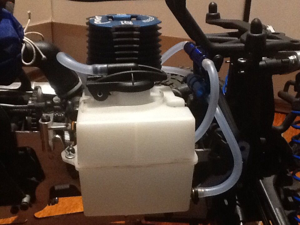

Ok, so here is my last attempt at using a stock Savage tank and reduce HTL before I take delivery of my truggy tanks. I noticed after a 1.5 hour session last week the plastic feeder tube in my tank melted!!! With it went the stone filter. I wasn't running lean... I put it down to how much of the exhaust line was touching the pipe and the total runtime without rest.
So I've now re-run lines well away from the engine including drilling out part of the tank moulding to run the line under it, put on a stone filter and fuel cooler. I'm going to run this set up with my last 500cc of the 25% Nitro to determine the impact of these changes.

I never heard of that before. How the *censored* did that melt? Those lines can take some serious temps. I got lines directly touching my exhaust and they have never melted. That's some crazy stuff and definitely a first I've ever heard of. I wonder what would cause that?
Posts: 7145
Post by Squid » Sun Aug 16, 2015 3:44 pm
I've had lines melt, but only where touching the header. Since then I have always looped the lines through the shock tower.
Post by NizzleMaShizzle » Sun Aug 16, 2015 4:38 pm
What I don't get is how the plastic in his feeder tube in his tank melted.

I got better running with a long fuel line and short exhaust return line. Tuning at half tank and HTL no longer an issue.
It seemed small but made big differences. Long fuel line passed through the rear shock tower, and the return going from the pipe behing the intake right into the fuel tank. The return no longer then it has to be the fuel line long and can loop the shock tower.

Hey Sinist3r... I'm going to shorten the exhaust line and run the cooler over the top of the filter. The shorter it is the more consistent pressure it should be able to push. I've got a truggy tank that I'm going to bolt on eventually.

Got rid of the fuel cooler, put on thicker line and reduced length by half. I'll throw on the stock shocks tomorrow and run it again.
