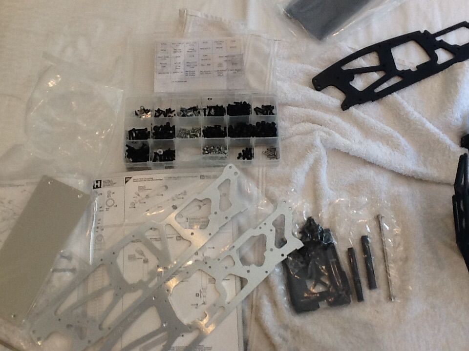

Post by Mendoza » Sat Jul 04, 2015 8:32 am
Two sets of IRC TVPS and full hex screw kit for two trucks .. Black look awesome but I'm bolting on the race option... 153grams v 82grams per plate... Think I'll throw the black ones on my Sav25 with the new LRP30 I've never used (but thats for another day)

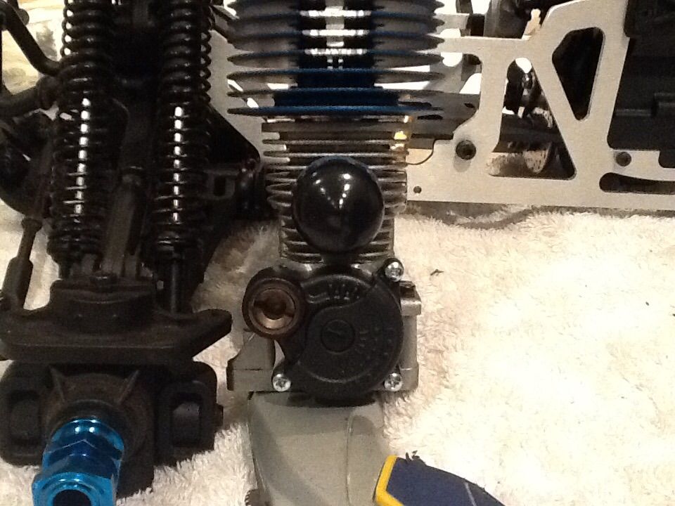

Post by Mendoza » Sat Jul 04, 2015 9:01 am
Rotostart in the wrong side ... But nova has a really good adjustable system - best I've seen... So it's easy to rotate it and adjust so it's in the right spot for the starting shaft even with 0.5 inch lowered engine plate height.
Post by Mendoza » Sat Jul 04, 2015 9:10 am
Carb rotated to suite the savage - did the same with the rotostart, applied threadlock to holding screws and put the 9mm Venturi in .. What I love about this engine already is the completely sealed backplate and how tightly sealed the carb is to the induction inlet... This engine is tighter than a fishes ar$e and the internals are really well finished. Different world to the K4.6 and definitely superior to the LRP 30.

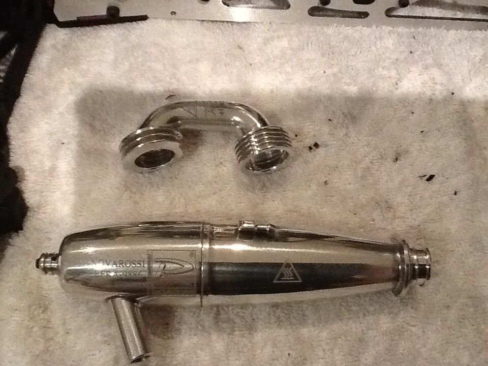

Post by Mendoza » Sat Jul 04, 2015 9:17 am
Time to get busy ... Exhaust also arrived earlier today which I need to grind at the manifold because it's a left hand set up like most systems ... Which is annoying because I won't get to see the etching in the mani or pipe once it's mounted. But I'll get over it once this beast starts screaming.

Post by Mendoza » Sat Jul 04, 2015 6:27 pm
New black anodised IRC engine plate and integrated cross braces - it's solid... Big improvement over stock which was chewing into the sides of the engine mounting screws.

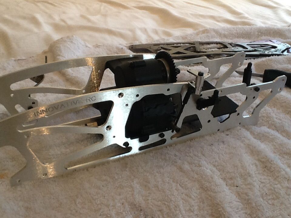

Post by Mendoza » Sat Jul 04, 2015 6:32 pm
Gearbox and diffs stripped down and rebuilt at this stage ready for reassembly.
Post by Mendoza » Sat Jul 04, 2015 6:40 pm
Gearbox mounted... The black TVPS in the background would have looked better but I figured less rolling mass would be be lower stress on the new engine during break-in.
Post by Mendoza » Sat Jul 04, 2015 6:53 pm
Front and rear ends reassembled. The TVP assembly went smoothly apart from having to file a little material out of the area where the engine plate sits on top of. And had to Dremel about 0.5mm out of the TVP engine plate mounting hole on the left hand side. Integy throttle mixer is smooth (ball bearings) but the alu is soft as butter.
