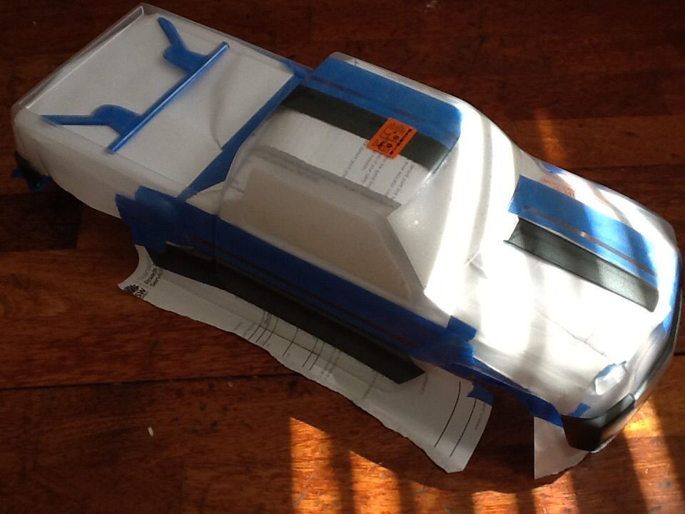

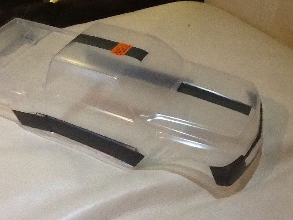

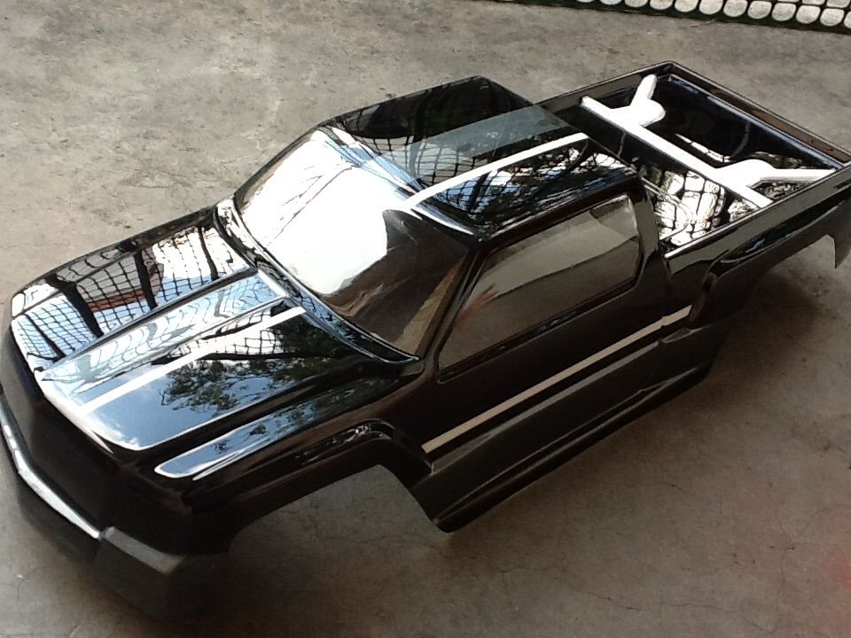

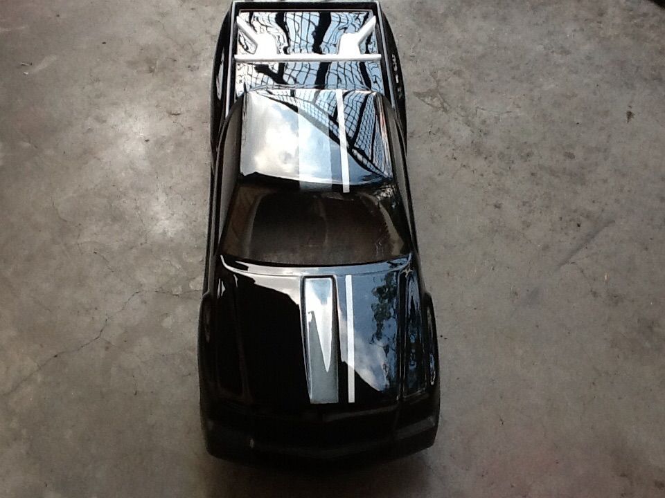

Post by Mendoza » Sat Sep 05, 2015 1:09 am
Body in the panel shop... Going for the clean sports look ...
Phase 1.
Phase 2.
Phase 3. Pin striping done. Final colour to get put down.
Phase 4. Body - finished - decals to go on

Post by SiNiST3R » Sat Sep 05, 2015 6:31 am
I'm drooling so much I need to mop up.
Nice Job, looks grrrrreat.
Post by Mendoza » Sat Sep 05, 2015 7:15 am
Hahaha ... Thanks bro! I've got a heap of great stickers to throw on but don't want to touch it yet ... either way it'll get bashed up once my current body is retired ....  But I may just keep this one good for a while because I'm doing my 72 Chevy C10 long bed body (race style) next which may end up being the basher first.

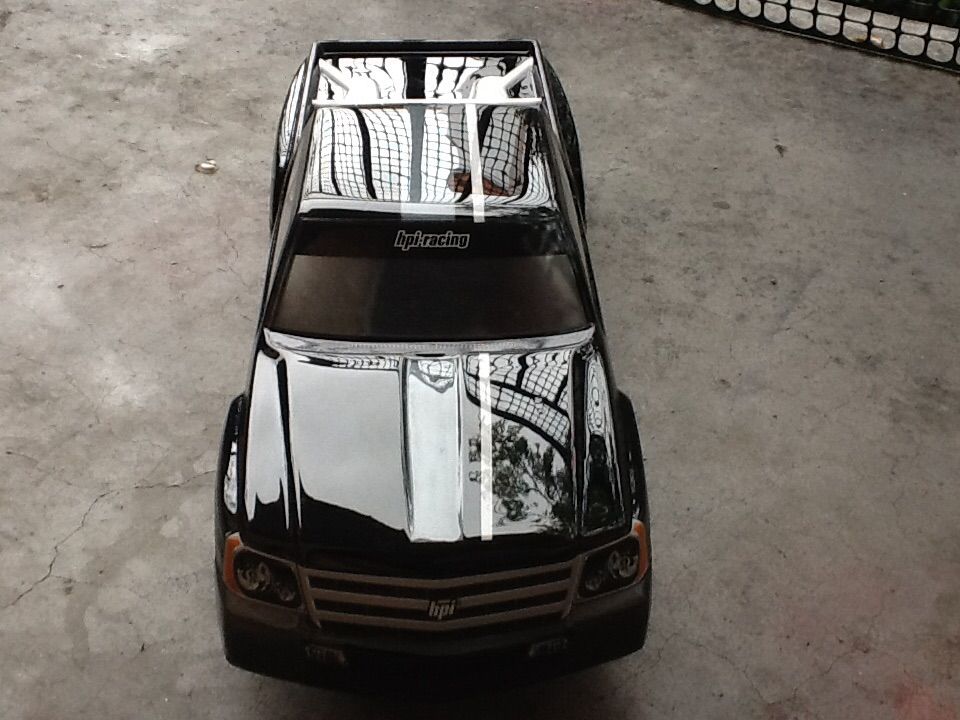

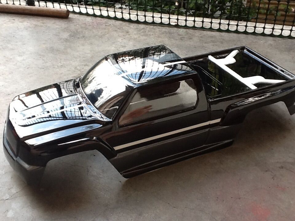

Post by SiNiST3R » Sat Sep 05, 2015 12:28 pm
Looks really good bro, I'm a big fan of Black trucks lol all of my RC except 1 are black and that looks sick, well done.
Post by Mendoza » Sat Sep 05, 2015 6:22 pm
with a few decals... But decided just now I'm removing the window dressing before I cut and mount it.
