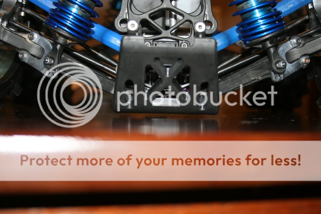

Ok, Im at a loss and need some LST Guru Help, I'll get a pic or two of the problem up tonight
Right now, With the way I had the LST's mounted using the IRC .25 mount setup, on Hostile MX Tires, The LST's would bottom out leaving the truck still almost 2/3" off the gorund. So I flipped the bottom IRC mounts around, and althou it lowered the truck a little bit, Now the shocks bottom out leaving the truck only 1/8" off the ground.
I dont want to lower the truck any more, but I cant jump this the way I want knowing all the stress is on the shocks and mounts. Does anybody have any ideas? Shafts from a different shock that would work? different mounting options? Dont say new tires :P

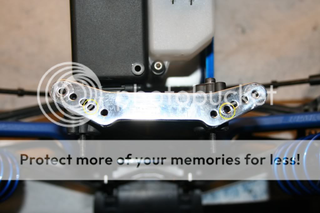

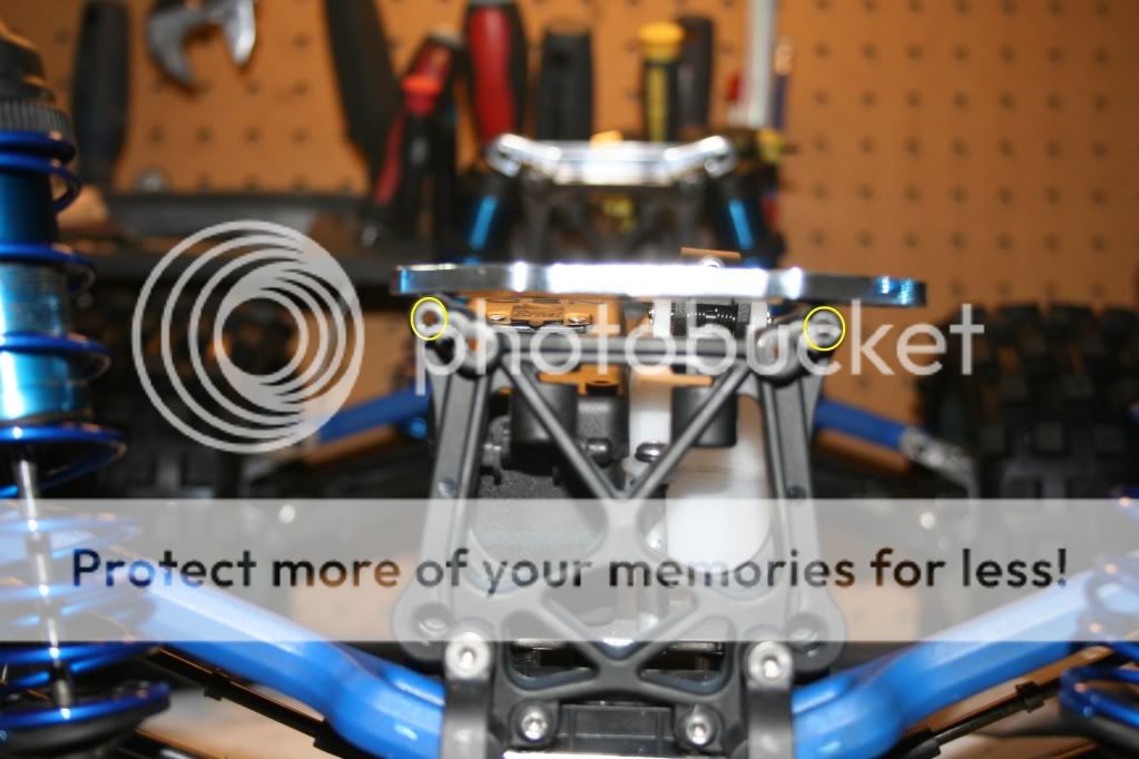

sounds good, I will get a pic of the top mount up tonight, and a quick walk throu of how to make the .21 tower mount work on your X towers. Takes 5 minutes, 1 drill bit, 2 screws and a strong set of thumbs :wink:
So you want to make your .21 Tower IRC mount work on your X style Tower. It can be done :D
It's easy, takes only a few minutes, and if you have a drill, drill set and two extra shock tower screws your all set!
-->First put your two extra shock tower screws into the outer most holes of your tower.
-->Next, using your very strong thumbs, push the IRC mount onto these screws, line it up so that when you get the IRC mount flush with the shock tower, it is centered on the tower. This took me a few tries to get right. Its hard, and your screws will bend, I suggest using the stock screws as they are softer.
-->Now take your drill and bit, make sure the bit you have is the same size of the holes already in the IRC mounts, and using the shock tower as your guide, drill away, You will end up with two nice holes, very close to the other holes. But IRC uses strong aluminum so the lack of material should not have an issue.
--> Then Reassemble your mounts and shocks knowing you just saved yourself some money for Beer! :D

hmm, I guess that's the price of using such large wheels and tires. All I can suggest is to use bump stops on the shocks and hope the Raven coils provide enough stiffness at the end of their travel.

@dodge,,Ive never ran LST's,,but what if you flipped the top mount & ran it upside down,,wouldnt that lower your shocks,,allowing the truck to bottom out..
just a thought :roll:
