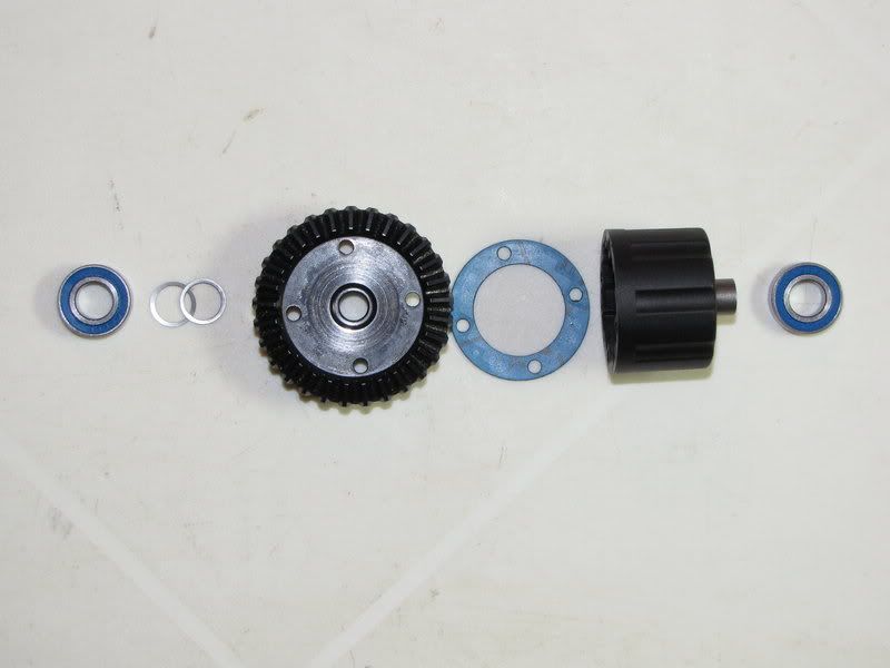

Was thinking of upgrading my diff to this on my Flux XL, but if you are using the ring gear from a savage, then you have to use a 10mm bearing on one side? The bearing slides over the ring gear (if i remember correct) so unless you grind alot of material of the ringgear, then an 8mm bearing wont fit?

The new bulletproof ring gear comes with 8mm shaft for the bearing to sit on.

Ah I see whats wrong now. I changed the bearings on my BL converted XL yesterday, and it had the 10mm bearing on both sides. I assumed the XL diff was only made in the bulletproof version.
By looking at the Flux HP manual, I Can see that the ring gear is another type than my XL has equipped.

If your diff had 10mm bearing on both side's,,it has to be an old 21 ring gear,,HPI did make a 43t ring gear with a 10mm bearing on early savage's..
You need to upgrade them.

I ran into the problem that the Vorza cup was wider than the stock flux cup and wouldn't fit into the bulk even with the 2 shims on the opposite side to the crown gear removed(see post pic). Seems I was using the same parts as this mod. Can anyone point out where I might have been going wrong?

Some time ago i bought Nova RC cups and did up my bulletproof diffs.
The sweet part about it is that they're alloy and if you buy the cups sold for the Hellfire, the savage ring gears fit and it takes the bigger bearing on the cup side so you eliminate the smaller problem maker.
think i'll try these Vorza internals on my next diff maintenance (even tho my savage internals have held up fine).
cool mod LL.nova diff cups

My diff when installed into a new bulkhead was a super tight fit. Thus why I took the 3rd shim out. Not with that being said just remove shims on the cup side until it fits. Remember tho you don't want your mess to tight or the pinion will wear into the ring gear. It won't destroy it just takes material away. I can personally say that it still holds up to 6s power 40mph back flips. That is the ring gear of course. If you have the mesh to tight
If you have to remove all the shims then I would recommend shaving the top of the diff housing down a bit until you can add one shim to the ring gear side

I beleive the hellfire cup requires alot of shimming to fit,,But it absolutely fits.

I used the 2 stock Flux shims (0.2mm) on the crown gear side to keep the mesh correct and no shims on the opposite side as per below. If I remember correctly there was no way this configuration would fit in the stock Flux bulk.

[quote="xtremesavage";p="844647"]I beleive the hellfire cup requires alot of shimming to fit,,But it absolutely fits.
I dont think you can get them anymore,,Isnt Nova out of bussiness?
All those cups are out of stock either way,,everyone one of them.[/quote]
i put a link up in my last post.  looks like he's selling his business (which is too bad b/c he makes some good parts).  the hellfire cups didn't require any shims when i had them in my gh alloy bulks and maybe 1 or 2 in the flux bulks.  they're identical to the savage cups with the exception that they use the same size bearing as the ring gear.
you can still get lucky and find nova products on ebay here & there.  FLM could easily make them; just change his existing design to accept the larger bearing & i bet he would if someone wanted them and called him.

I used stock flux bulks. I have 2 shims on each side so 4 total for each diff. Now I did find that one shim had to come off on the ring gear side because it was over shimmed.
Anyone else considering this mod, please note that how many shims I used will be different from everyone else. No two bulkheads are exactly the same size...dimension wise where the diff sits. I have noticed this on many bulks. A used bulk has been broken in sorta speakin so the diff will fit in there with more shims. Where as a new bulk will require less shims. So shim accordingly!

Just got my modified cup and ringgears back from my friend at work :) now it's lathed/grounded down to 8mm on both sides (standard 43tooth).
I just assembled them, 2 x 0.1mm shims on each side of bearings, one 0.1mm shim on the inside and 0.3mm on the outside of the drivecup located on the cup-side.
They fit perfectly in the housing and the woble in the cups is almost shimmer away :) looking forward to trying it now, crossing fingers for more than 10 minutes runtime :D

When shimming does a Guy have to shim on the inside of the bearing or would it be safe to shim the outside like the vorza diff's came in the housing's
