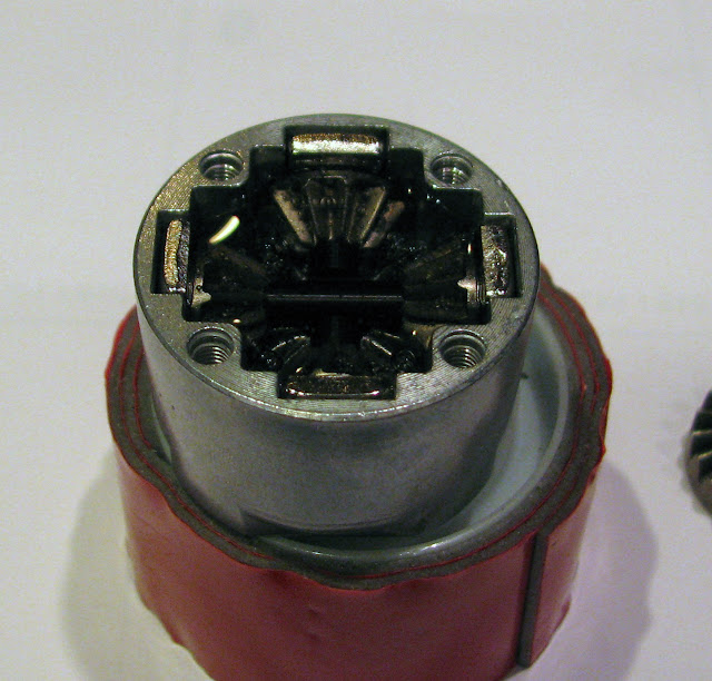

Post by carmaster65 » Thu Feb 14, 2013 2:36 am
Here are pictures of my diff build. Idler gear Hpi 106271 (for the Flux) is on it's way and may not be here until next week. If I can find time to tear down my 3spd I'll see if the diff fits.
Parts used to build the center diff were:
HPI 106273 Racing Idler Gear 30Tx1M
HPI 106277 Diff Shaft Set
HPI 87193 4 Bevel Gear Diff Conv Set
HPI 86827 Alloy Diff Case Savage X SS
parts and instructions laid out. more than the parts list shown.
parts list, instructions and diff oil. I used 50,000 to start with.
diff cup with gears sitting for a minute to let some bubbles out. I slowly turn the gears to let the oil get in everywhere. I don't fill my diffs all the way, no oil squeezes out when the crown gear is put on.
diff assembled ready to install the gear. I always use hex hardware, hpi included it with the gear (diff case came with philips head).
ready for installation. I will be using the drive cups from the stock flux tranny. few extra parts for the spares box.
