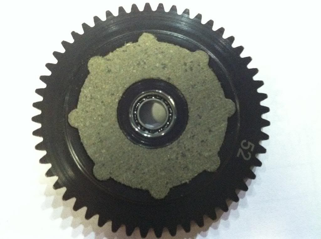

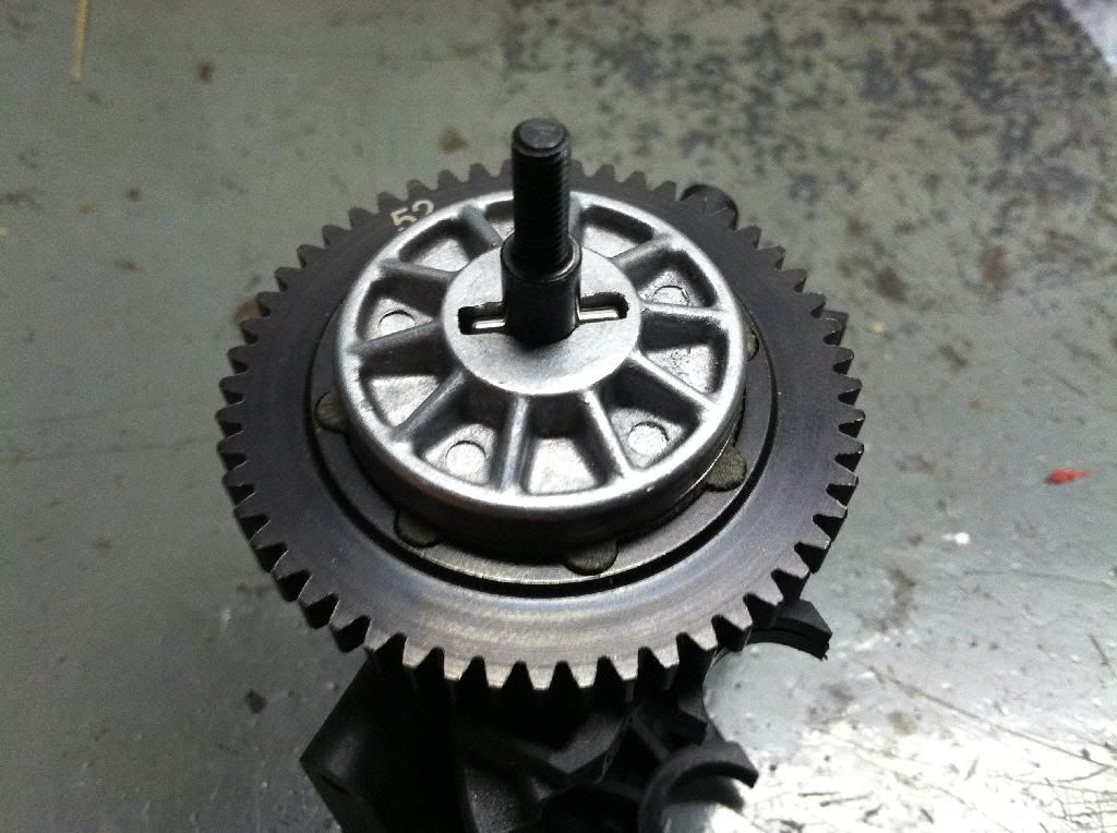

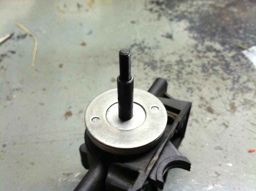

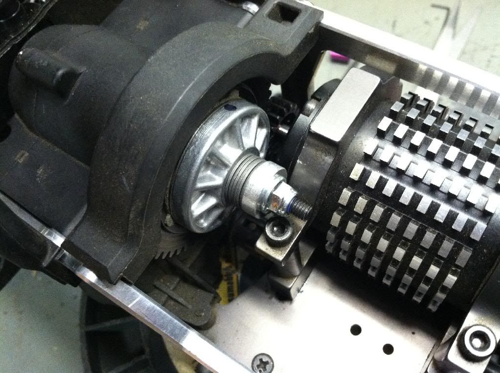

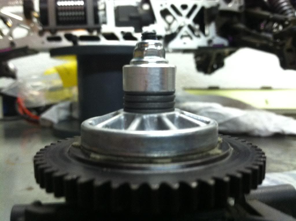

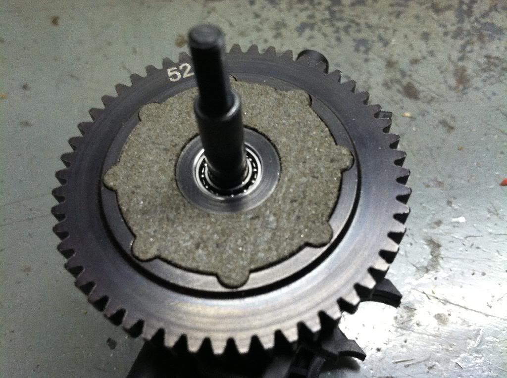

Has anyone had any luck using the Super 5sc transmission with Flux HP spur gear/slipper clutch?
I wasted so many slipper pads. I cranked the slipper nut down as tight as I could with out stripping the nut, and still burnt up pads.
Finally I broke down and ordered the Super 5sc 52 tooth TSC gear and shaft. I noticed that the gear has no bushing or bearing to spin on the shaft when the slipper slips. Its just hardened metals grinding against each other.
Being a machinist, I took gear to work and bored hole and fitted a bearing with a press fit.
At the time I could not find HPI p/n 107906 so I modified an ordinary slipper clutch hub. I hand filed the pin slot all the way through.
Also at the time I could not find the spring for the Super 5sc TSC p/n 107458. I found some belleville washers from McMaster-Carr and an aluminum spacer.
Here it is all done. I used a 16T pinion from RC Monster. I think that's the biggest pinion that will fit without modifying.
I ran 6S off road and the slipper is slipped like it should. It was cool to the touch after a run.
