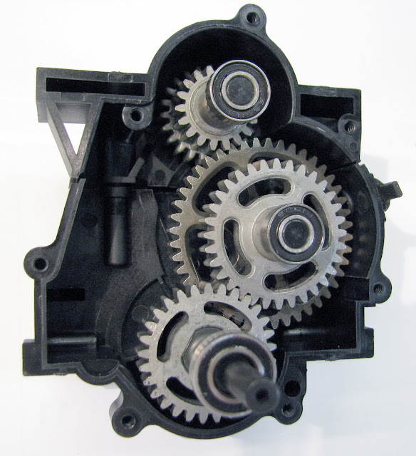

Here is my stalled progress. I've ordered more parts and will still need more. Worst case I just end up building a S5sc tranny.
diff spacing compared to the flux.
diff in all nice and shimmed.
stock flux gears (top pic) and the diff installed (bottom pic). there is no way spacers are moving that diff enough to line up. the 44t idler lines up with the diff but will not seat in the case. It might if changed to the 5sc 41t idler. I think the shaft 100905 moves the gears as well, it looks like they flip it for the 5sc. flipping the shaft around for the stock flux gears doesn't work, at least without grinding some of the hub down to clear a pin hole. not something I want to do to a perfectly good gear.
stock
diff

That is the flux tranny in the pics. The idker for the 2speed is the same, i checked it this evening. im running my 3speed tomorrow. after that I'll check it. i bet its the same. this diff is definitely not drop in. thats why im asking what you had to change to get your diff working?

Ok that makes sense now. All the trannys have the same bottom gear spacing flux, 2spd, 3spd. The middle shaft on the 5SC is the same part # as the flux, they just flip it and add the 5sc gears. It's good news that you can use the old top shaft as you can run a smaller spur for more gearing combos.
I don't think the diff will work in the nitro boxes. I have a 2spd that I'm playing around with and I just don't see how the diff won't interfere with the middle gear cluster. Would be nice to see this upgrade on the 2013 Savage from the factory. Here is my latest carnage pic.

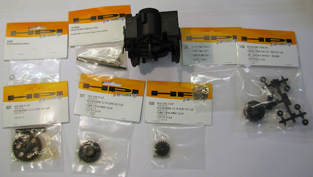

Finally got the rest of my parts in and found time to assemble the transmission. There  were no big surprises along the way, just buy all the parts and follow the instructions.
I started with a stock flux tranny (with cups, no slipper) from ebay. I also previously purchased the lightweight hardened gears to build the bullet proof flux HP tranny. It looks to me that the 5SC tranny is the same type of hardened lightweight gears. Great, bulletproof and a center diff!
I covered building the diff in a previous post, this will pick up from there. Basically what I did was use the exploded view from Hpi's website and order all the part numbers. this was overkill but I like to add stock to my spare parts stash. One example is the pins, all the gears come with extra pins so the pack of pins I bought was not needed, not to mention the original pins from the tranny can be used. Same thing with the o rings, my diff kit came with all hardware so extra o rings were not needed. You can decide how much to buy, I will try and accurately detail the parts I used.
Diff parts list:
HPI 106273 Racing Idler Gear 30Tx1M 29.99 (38.98 shipped)
HPI 106277 Diff Shaft Set 5.99
HPI 87193 4 Bevel Gear Diff Conv Set 11.39
HPI 86827 Alloy Diff Case Savage X SS 11.39
Transmission parts list:
HPI 86972 Washer 6x15x0.2mm 3.69
HPI Z877 Washer 8x10x0.2mm 4.59
HPI Z689 Shim 6x8x0.2mm 2.79
HPI Z245 E Clip 5mm 2.79
HPI 107496 Bearing Mount Spacer Set 5.29
HPI 106269 Drive Gear 21Tx1M 15.79
HPI 106275 Idler Gear 41Tx1M 26.99
HPI 106271 Drive Gear 31Tx1M 30.10 (LHS)
Misc parts:
HPI B032 Ball Bearing10X16X5mm Savage 21
HPI B023 Ball Bearing 6X13mm
The bearings are miscellaneous because I used the Savage X SS alloy diff cup. That changes the the bearing from a B085 to B032  (which I had on hand). The Flux HP uses one B085 and B023 on the lower shaft which would transfer to the 5SC tranny but you will also need an additional B023 and B085. The 5SC doubles up on bearings on the diff.
Optional:
HPI 107460 Drive Shaft 6x80mm Super 5SC Flux 5.99
The 5SC drive shaft for the dual pad slipper is optional. I assembled my tranny with the stock flux shaft.
I added the prices so you can see what it cost me. Starting from scratch to assemble this entire transmission is a staggering 150.79 in parts + donor tranny 36.00 + shipping 23.59 = 210.38usd. If you have more patience you could probably shave it down a little.  Those gears sure add up, ebay didn't have much to offer. I've had good experiences with RCHobbies4life and their prices are always pretty good, they just didn't have some of the gears in stock. The kicker is I don't have a truck to put this in. I just sent out half the parts of my build to be anodized. I imagine it'll be a few weeks until I can test anything. Oh well. at least the tranny is out of the way. Here are some pictures.
stock flux layout
the 5sc layout. doesn't look like much huh?
need to seal up the brake cam hole, probably just use silicone sealant.
diff
tranny
