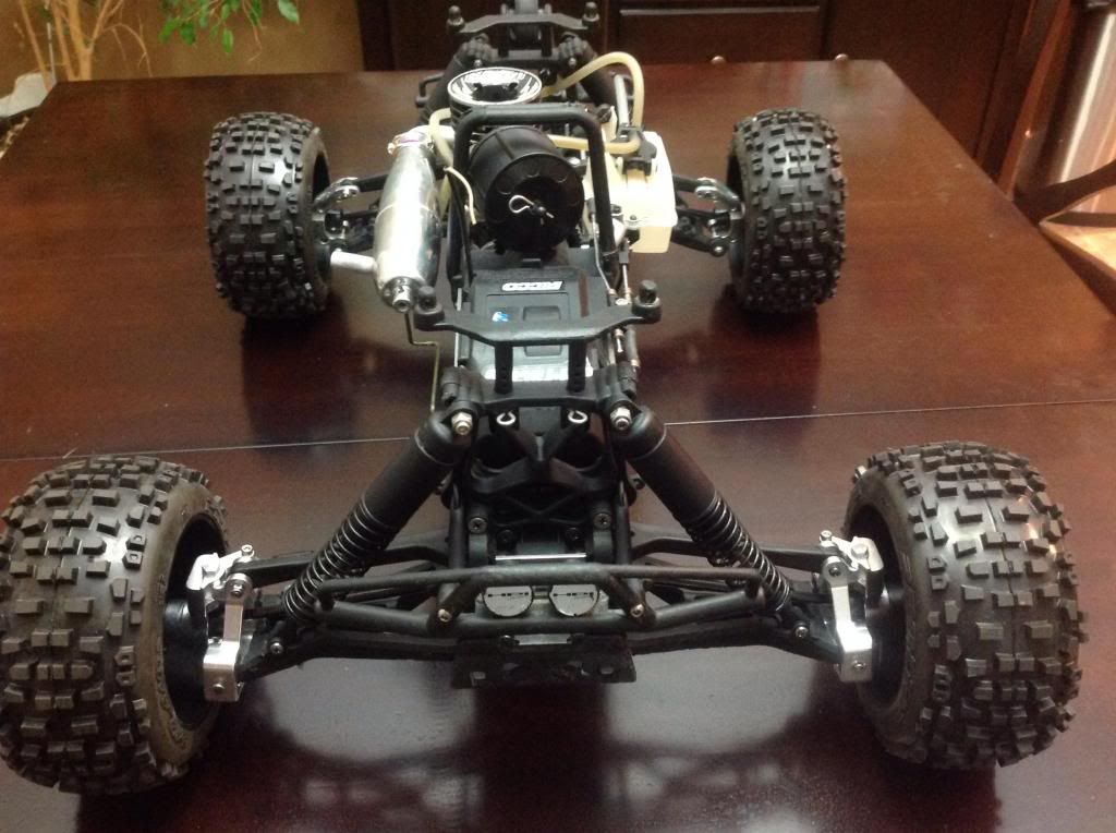

Unfortunately ERCM is not producing any new pipes until March or April according to Robin - when I inquired about my order and finally got hold of him he told me that I would have to wait. For my new Picco .28 I ordered a OFNA 086 in it's place but didn't realize it was a lefty. Any suggestions on mounting this without damage to the back pressure fitting hitting the TVP?

Post by LeroyX » Thu Jan 15, 2015 1:08 am
I just used a coat hanger and bent it to fit. Been on there forever with no problems. Here is a pic that shows it.

Looks good...and great idea! I have a HPI tuned pipe now with mount and spring that will work good too I think. Does the stinger point straight at your tire? From the picture it looks like the exhaust would blow against the tire or is it just the angle from that view? Nevertheless looks good :)

Post by Caretaker » Thu Jan 15, 2015 11:18 am
The stinger is a good 4-5 inches in front of the tire.. :)  It is just the angle of the picture..

Post by LeroyX » Thu Jan 15, 2015 2:53 pm
Correct it's far from the wheels. I cut a hole in the side of the body for the stinger and it works great.
