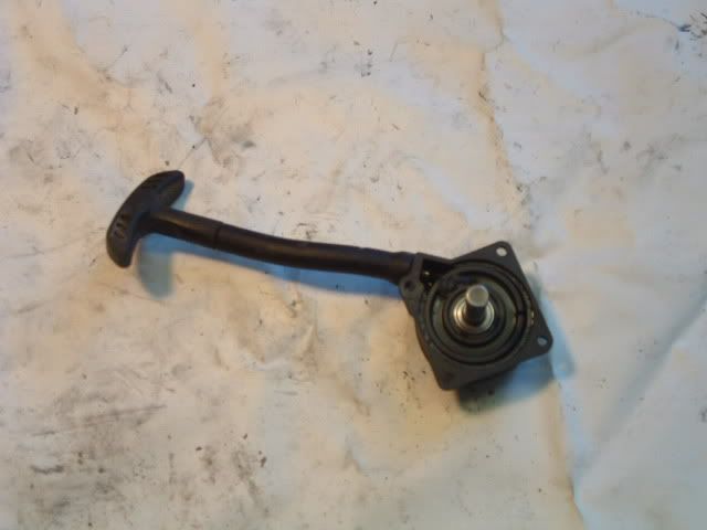

Post by NITROMITE » Tue Mar 23, 2010 10:56 am

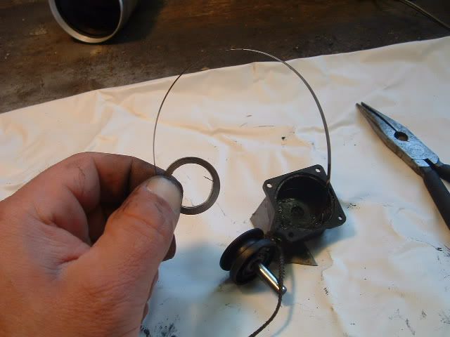

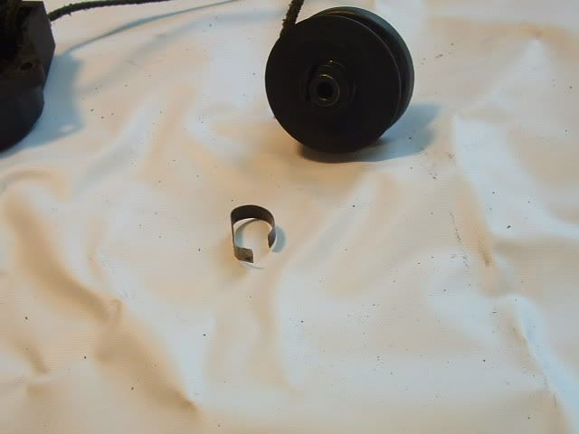

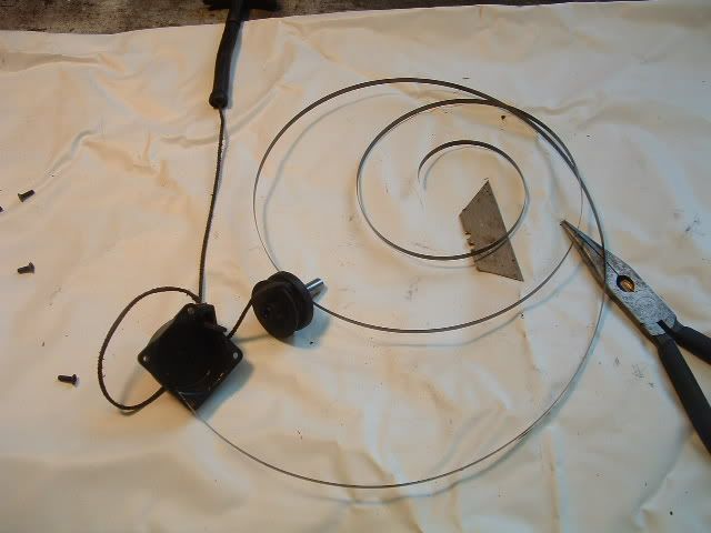

the most comon problem is the end of the coil spring breaks
throw away broak peice
Remove the coil spring

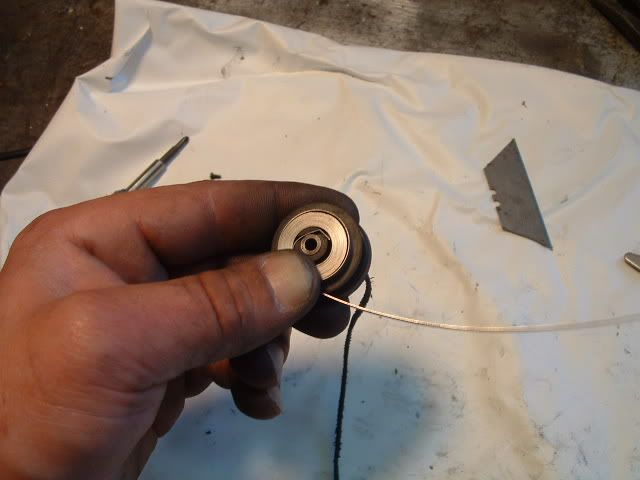

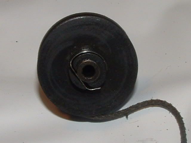

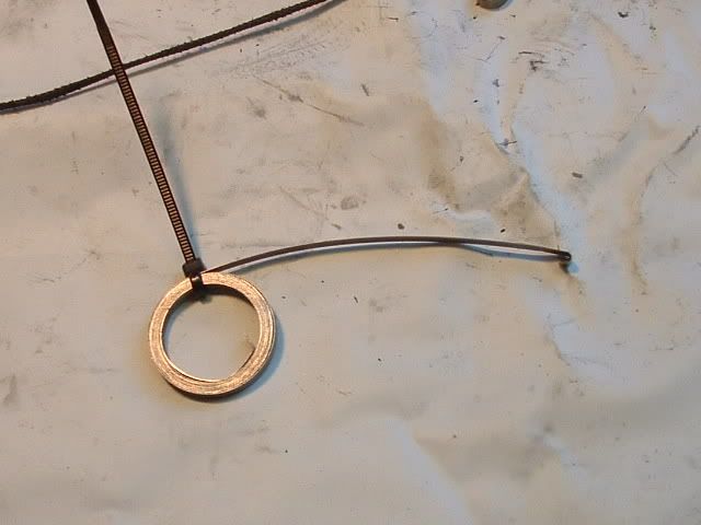

Now make a bend in the godd end of the spring to make up for the peice you trashed and start coiling the spring back
i like to use a zip tie to hold the spring

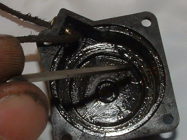

now place back on spindel and remove the tie. finish coiling the spring
it is important to rewind the cord before puting the pull start back together. pay attention that you wind the cord the right direction
place back together and go bash
