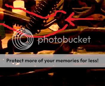

Here's the turnbuckle ball end with the washer to hold on the worn end (arrow)
And the diff shims that should have come in the parts bags with the truck. (circle)

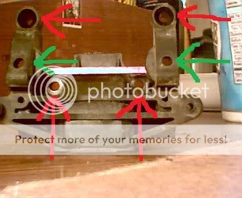

Diff case screw locations.
Case removed
Red arrows are 4 screws that hold the diff case in. (Besides the 2 on the bottom.) 6 screws total.
Green arrows are the hinge pin holes.
Diff without case half.

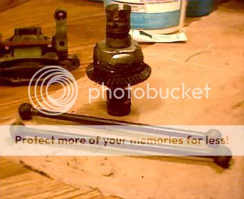

Diff and dogbones out.

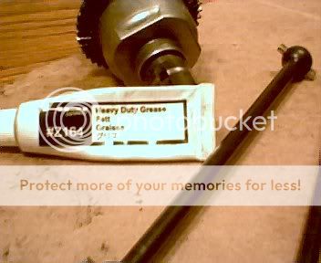

Diff cleaned and Z164 30K heavy diff grease.

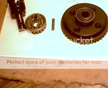

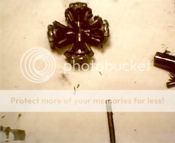

Now remove the spider gears after separating the diff from the ring gear.
Spider gears removed.
Keep them together until you clean and reassemble.
Now you can remove the diff shafts.
There is a pin going thru each of the shafts holding them in the ring, and the other in the cup.
Remove the # 87193 gears from the shafts.
Then remove the pins and the shafts will slide out.
I use needlenose in the diff cup to get the pin out of the shaft and to reinstall.

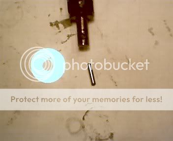

There is a large washer that the retaining pins ride against from the last step.
Washer shown with pin and diff shaft.
(washers will be stuck to the insides with grease you will see them when you clean out the inside of diff)

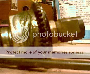

Now put the ring gear onto the empty diff cup and put 2 screws opposite each other and tighten it up..
Next set the empty diff back in the truck and check the play.
Hold the driveshaft under the truck at the pinion on the backside of the diff.
Check the play by holding the pinion still and wiggle (rotate up and down, not side to side) the ring gear to see if there's slop between the gears.
There probably is.
Now take the diff back out and take the bearing off of the ring gear side and install another shim.
Shims located between the bearing and diff. (red arrow)
(More shims on the gear side will bring the ring and pinion closer together.)
There should already be 1 shim from the factory on each side of the diff.
The manual shows on page 32 2 shims on each side, I tried that and it didn't feel right. Also, it doesen't come that way so....
Put the bearing back on.
Now that you have 2 shims on the ring gear side and 1 shim on the other side.
You can put the diff back in and check the play.
It should be minimal, if any.
A hair of play between the gears is okay, too tight and possible binding is not.

You will need grease to put back in.
So if you don't have any, check the LHS and they should have something.
The Z164 grease is 30,000 weight.
I still use this on the ring and pinion.
I have changed the grease in the diff where the spider gears are sealed in.
What I used is something I had on hand.
Thick automotive clear silicone brake caliper lube.
The thicker the grease or fluid you use the less "give" there is between the wheels on that axle.
You can use whatever you want to try, but HPI recomends the 30K #Z164.
