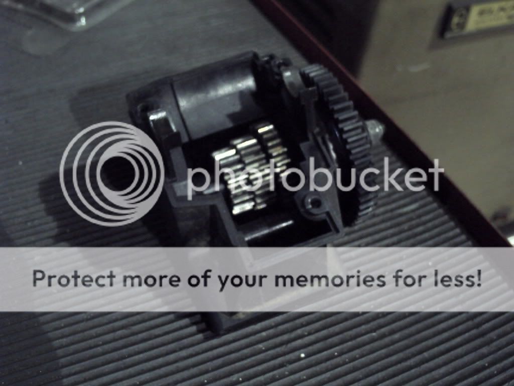

Once the 3 screws in the recesses on top of the tranny are out,
Simply slide the top half of the trans case out with the spur gear attatched.

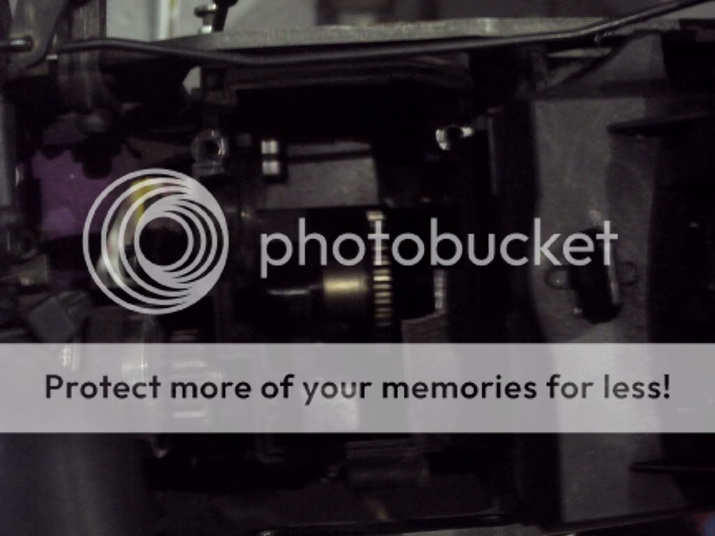

Top half removed-
Bottom half still in truck, gear assembly removed-
Now you can pull the gear assembly out of the trans.
The bearings are not held on the shaft, the case holds them in place so remove the bearings and set aside.
(Now is a good time to clean them)

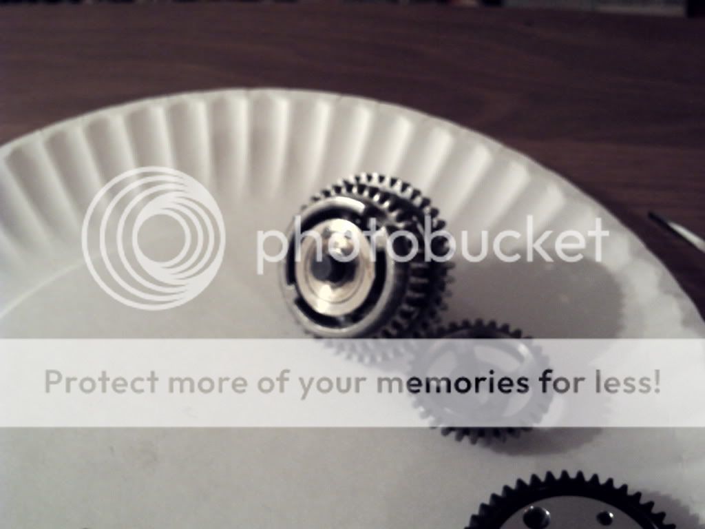

Here is the main gear assembly-

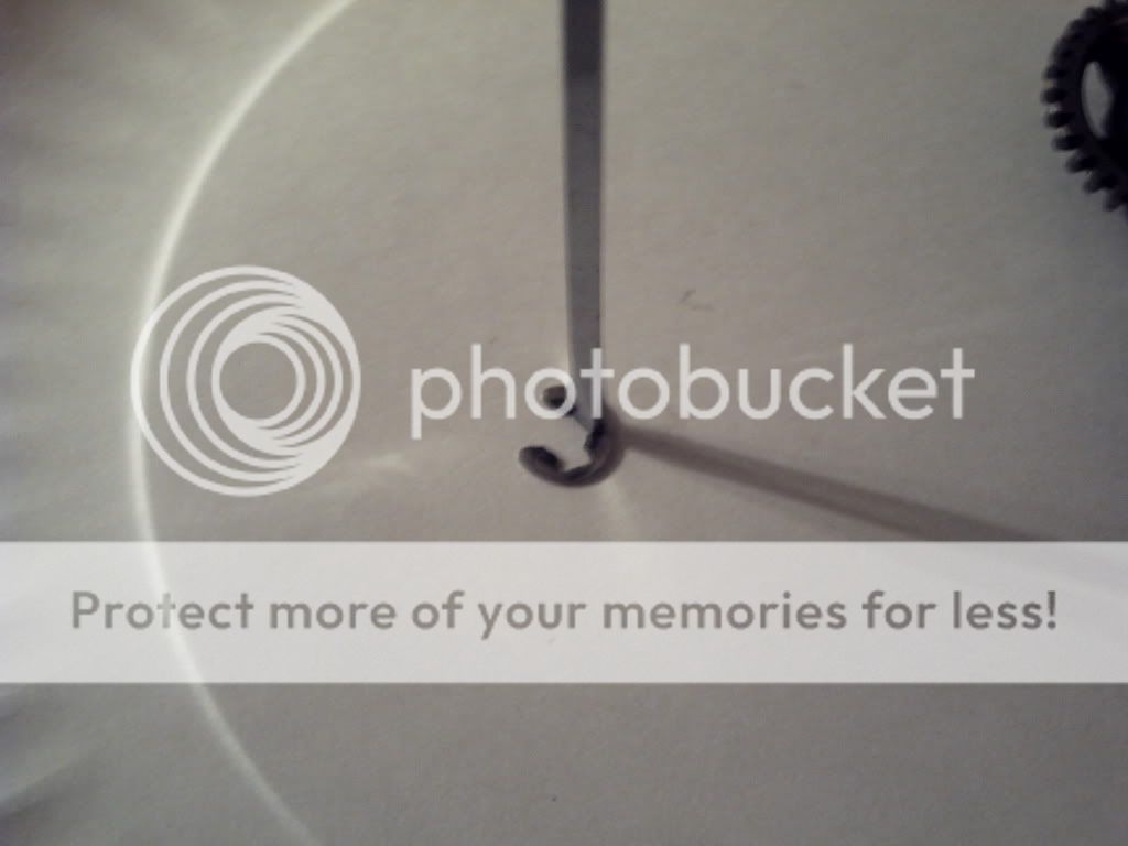

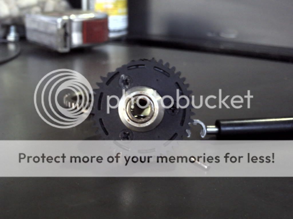

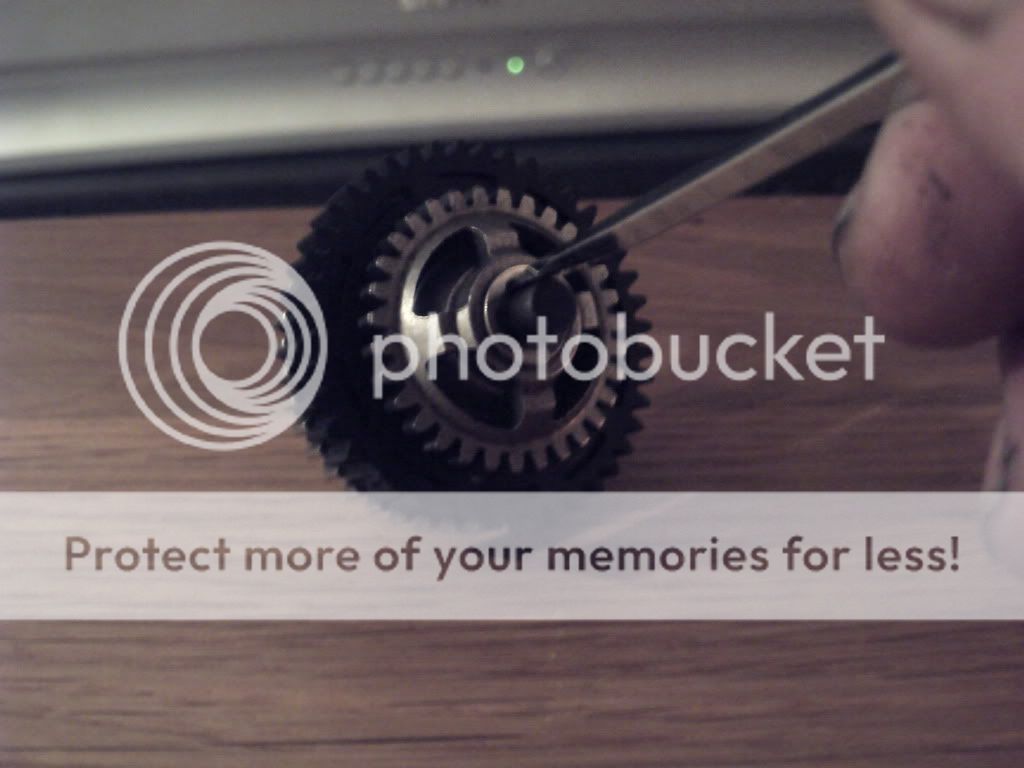

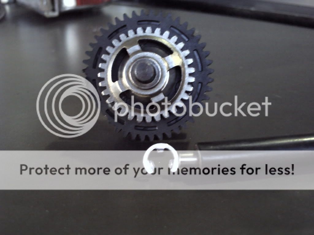

First step in disassembling this is to remove the E-clip from the shaft.
Do this by simply inserting a small flathead screwdriver in the gap of the E
in the E-clip and twist the blade of the screwdriver.
Be sure to keep your finger on the E-clip so it does not fly away never to be found again.
Placement of screwdriver blade in E-clip-
E-clip removed-

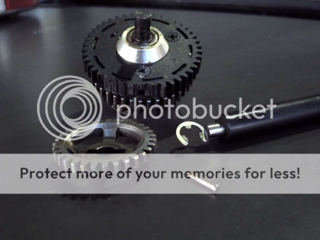

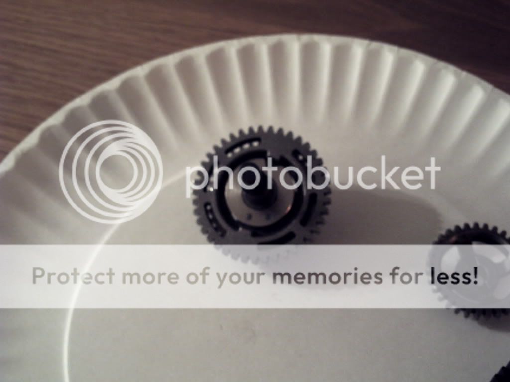

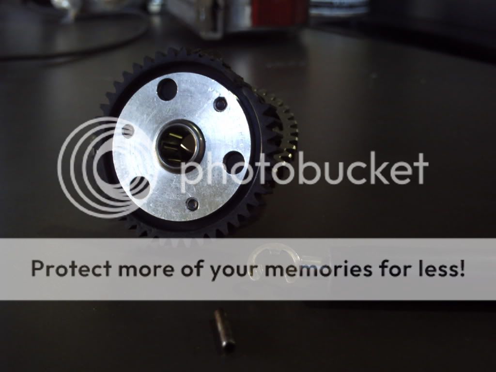

Now the first gear on the shaft (the main drive gear that connects to the driveshafts) will slide off
and there will be a pin holding the next gear on.
Gear removed and pin still in shaft-

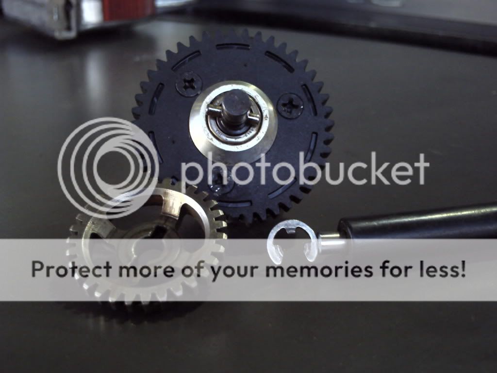

Slide the pin out and the plastic gear that is connected to the OWB (One Way Bearing) will slide off the shaft.
Pin removed-
Plastic gear/OWB removed-
Other side of OWB and gear-

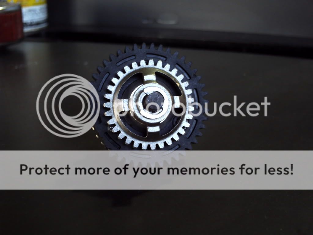

So for now you are at the point where you can replace the plastic gear,
or the OWB that is held onto the plastic gear with 3 screws.

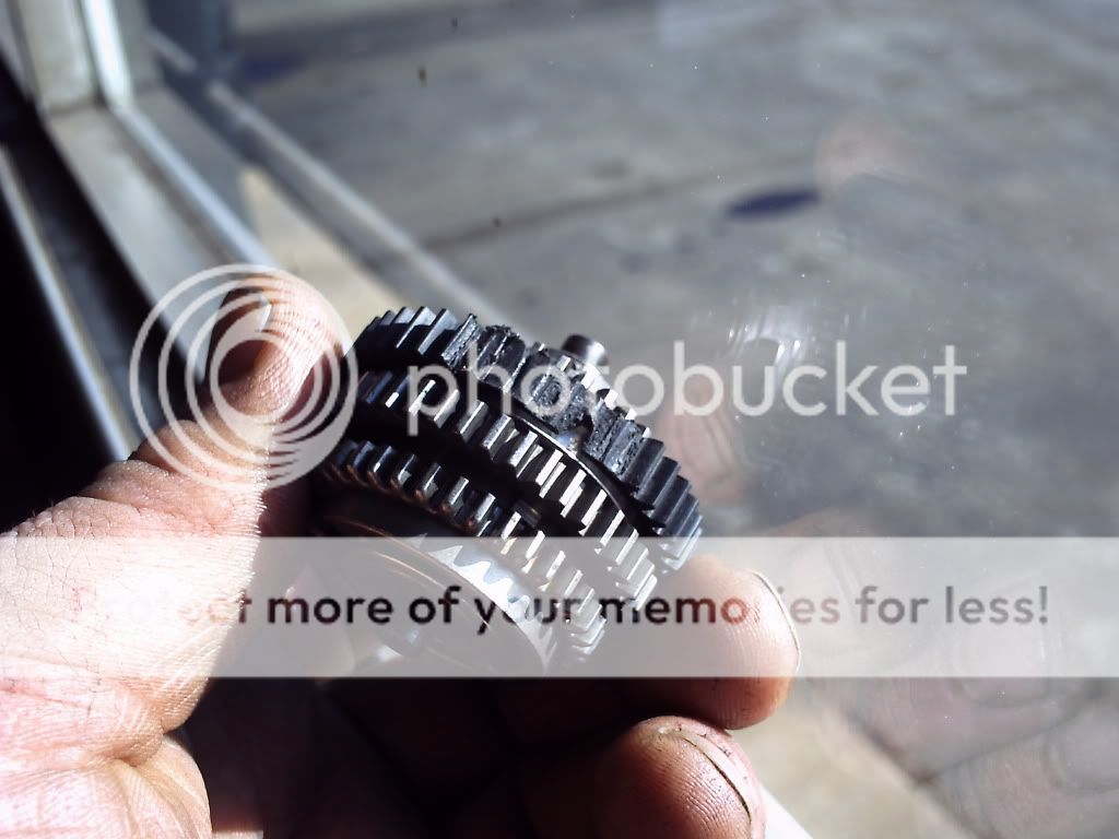

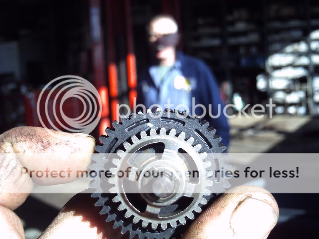

Here's a couple pics of the trashed gear if you didn't notice it in the other pics.

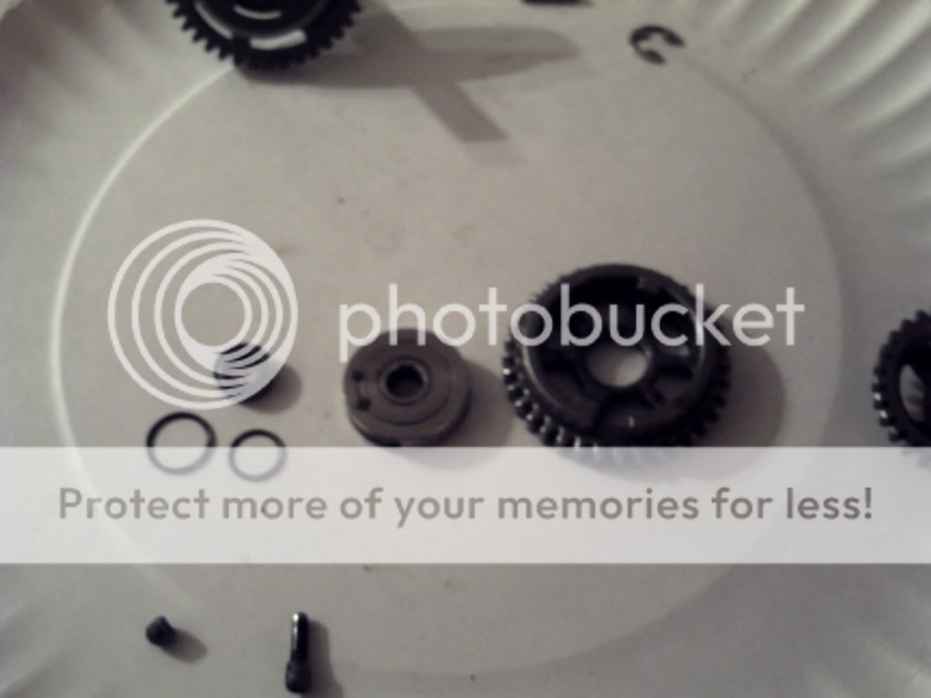

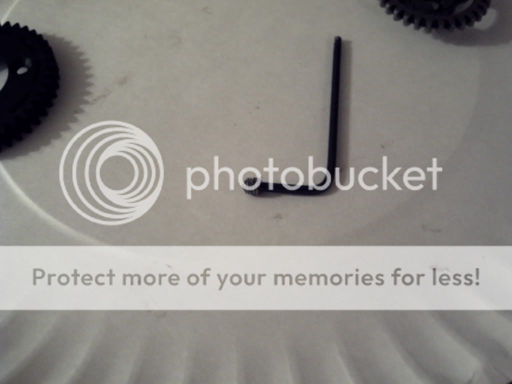

To access the shift adjustment for second gear, you will need to remove the third gear clutch and third gear.
You want to remove the grubscrew that is centered with the main shaft and not the one that is offset.
The offset one is the shift point tension screw.

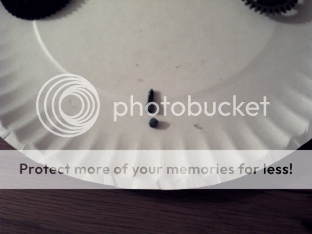

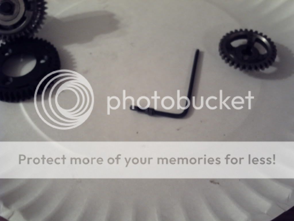

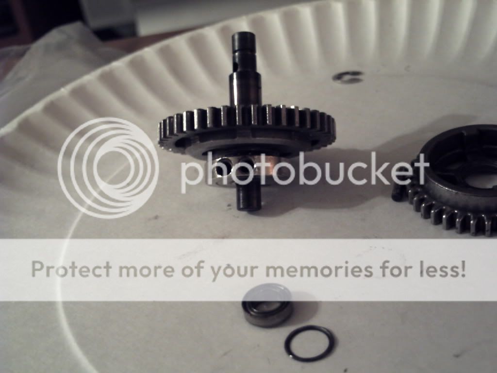

Center hole (shown with gear removed) and 86094 goes thru the shaft -
Under the first Z721 grubscrew there is a 86094 setscrew that goes thru the main shaft, remove this also.
Grubscrew-
Setscrew-
Grubscrew and setscrew removed-
Now the clutch and third gear will slide off the shaft.
As well as second gear.
There is a washer in there, so keep track of that.
The washer goes between the 2 gears.

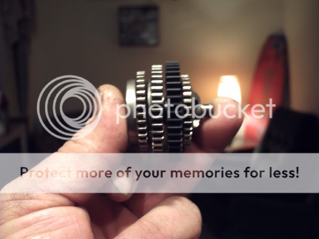

Assembled main gears.
From right to left-
Far right- Main drive gear out to the wheels (steel)
Plastic first gear
Steel second gear
Far left- Steel third gear
Here's the bearing that sheared off the flange..
